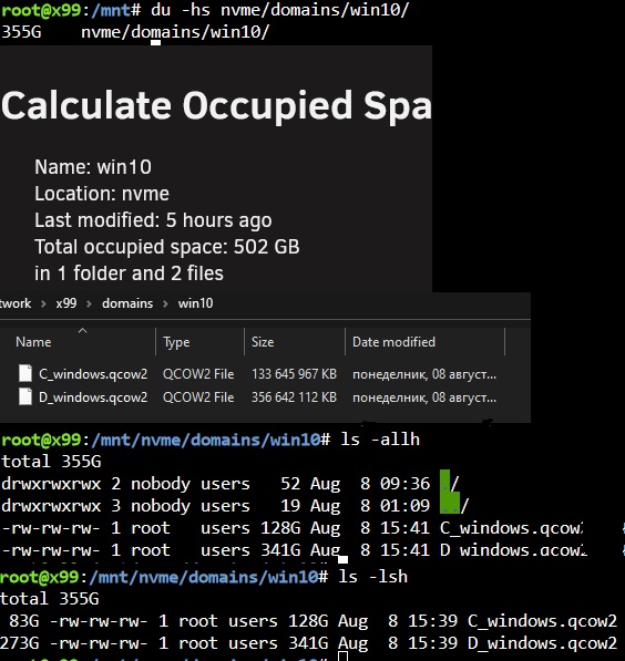

It is all working for me with the exception of that the host dosen`t reclaim actual space. When i use "ls" the qcaw2 file is still the size before the optimization in the guest and trim on the host. Only "du" shows  the trimmed size, but that is not usable space on host. So how to reclaim any tangible space on the host? Do i have to use LVM or some kind of esoteric fs as btrfs or zfs so that to work ?

Sorry, i use XFS. So what is actually has to happen? Doesn't it have to make allocation size same with actual(logical) so that i can use this space for other files?
It should discard and free any unused space when you run trim in the VM OS.
I think it is, it is just the diference between allocated space and block space. In main page in used space shows block space and in file manager shows block space. In smb share from windows explorer shows block space too. And on top of that there is the difference between GiB and GB that confuse me more at the start of the investigation because a forgot about that thing. But in the end i don`t know if this space is usable. So what i have to believe "du" or "ls" ?
