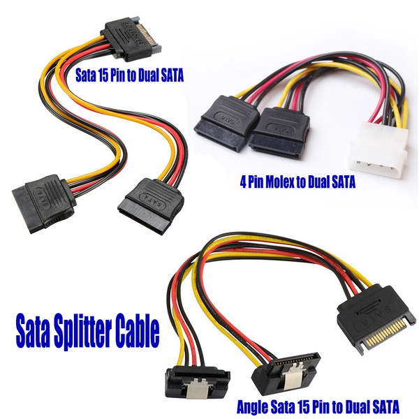

August 10, 20224 yr Author 33 minutes ago, JorgeB said: Looks more like a power/connection problem, check if the affected devices share anything, like a splitter or miniSAS cable. I do use the HBA which goes from SAS to 4 SATA. On top of that, I have this SATA power extender 33 minutes ago, JorgeB said: Also a good idea to update the LSI firmware, since it's quite old. Can I ask where in the diagnostic you found what firmware I'm running. Also, all I can seem to find on Broadcom's website is info for the SAS 9200-8e HBA (whereas I purchased an 8i on ebay years ago). When looking at my ebay invoice, the item's title reads "Genuine LSI 6Gbps SAS HBA LSI 9200-8i = (9211-8I) IT Mode ZFS FreeNAS unRAID US". I *did* find firmware for the 9211-8i. Do you have a better sense for which I should use? Thanks! Edited August 10, 20224 yr by Shu
August 10, 20224 yr Community Expert 16 minutes ago, Shu said: I have this SATA power extender These are a very bad idea. 16 minutes ago, Shu said: Can I ask where in the diagnostic you found what firmware I'm running. In the syslog, search for "fwv". 18 minutes ago, Shu said: I *did* find firmware for the 9211-8i. Do you have a better sense for which I should use? Use this one, latest release is 20.00.07.00
August 10, 20224 yr Author 11 minutes ago, JorgeB said: These are a very bad idea. In the syslog, search for "fwv". Use this one, latest release is 20.00.07.00 Darn...I'm using a Corsair 550W power supply that is not modular. Do you know of a good way to power more drives than I have ports for? I'm sure I have enough power (only have the CPU in there and an old AMD gpu (pci power only)).
August 10, 20224 yr Community Expert You can use splitters if there's no other way, but a SATA plug should only be spitted for 2 devices, you can also use molex to SATA, those can handle more than 2 SATA disks, but if possible still all limit to 2 for splitter.
August 10, 20224 yr Author 8 hours ago, JorgeB said: Use this one, latest release is 20.00.07.00 (had an internet outage today but) I just updated the firmware! Have never done that before, exciting and nerve-wracking haha. I will monitor for the issue again 8 hours ago, JorgeB said: You can use splitters if there's no other way, but a SATA plug should only be spitted for 2 devices, you can also use molex to SATA, those can handle more than 2 SATA disks, but if possible still all limit to 2 for splitter. My PSU came with two 3-port sata cables (enough for 6 devices in total). I attached one 4-port splitter to each native sata cable (so each now supports 6) for a total of 12 across both. My PSU also has one cable that is PSU > SATA - Molex - Molex - FDD (floppy disk?). I suppose I could try the two Molex to two Molex>dual SATA splitter? That would give me 4 but still not enough... Is there a better and just completely different way people power their drives?
August 11, 20224 yr Community Expert 7 hours ago, Shu said: two 3-port sata cables Each of this ports can be split in 2, so 12 total just here.
