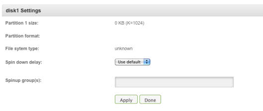

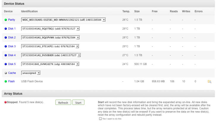

Still have issue with unknown showing up as the disk type. This is different than beta 6, as that showed MBR: Unknown. What's strange is that a disk that I formatted in beta 6 (which showed correct MBR), now shows as unknown for filesystem type (same as rest of drives), but shows correct partition type.
On the main screen, the drives I assign to the correct slots bring up "Found 1 new disk". It asks me to add the disk to the array.
I haven't started my array just yet.

Added new screenshot for array. Added syslog.
syslog.zip

Any ideas on why this is happening? I have a feeling it'd be easier just to start my server all over again...
http://lime-technology.com/forum/index.php?topic=13371.msg126928#msg126928
Before you do, please get the clues needed by Tom to figure out what is happening.
Please post the output of the commands described in this post:
http://lime-technology.com/forum/index.php?topic=11540.msg109913#msg109913
(make sure you do it for your drive, "sdb" was used for the example)

To "speeding ant" - you have very old Gigabyte board and at present two of the HDs are with HPA. I am not sure of your exact upgrade path so far but it was supposed for everyone to upgrade first to 4.7, check out if everything was OK and then proceed to 5.xxx.
However I do recall having a HPA was a big "no go" for upgrade to 4.7
Perhaps the "new" hard drive that you have is new because of a new second instance of the HPA, then the MBR will be affected and you may get the symptoms you have now.
BIOS:
Jun  8 10:31:40 Media kernel: DMI: Gigabyte Technology Co., Ltd. EP35-DS3/EP35-DS3, BIOS F4 06/19/2009
Jun  8 10:31:40 Media kernel: ata5.00: HPA detected: current 1953523055, native 1953525168
Jun  8 10:31:40 Media kernel: ata5.00: ATA-8: ST31000340AS, SD15, max UDMA/133
Jun  8 10:31:40 Media kernel: ata6.00: HPA detected: current 2930275055, native 2930277168
Jun  8 10:31:40 Media kernel: ata6.00: ATA-8: ST31500341AS, SD1B, max UDMA/133
Jun  8 10:31:40 Media emhttp: Device inventory:
Jun  8 10:31:40 Media emhttp: ST31000340AS_9QJ0PVWK (sda) 976762584
Jun  8 10:31:40 Media emhttp: ST31000333AS_9TE1KPE1 (sdc) 976762584
Jun  8 10:31:40 Media emhttp: ST31000340AS_9QJ0TBQ1 (sdd) 976761527
Jun  8 10:31:40 Media emhttp: ST31500341AS_9VS0B8ER (sde) 1465137527
Jun  8 10:31:40 Media emhttp: ST3500418AS_6VMG8Z7K (sdg) 488386584
Jun  8 10:31:40 Media emhttp: WDC_WD15EARS-00Z5B1_WD-WMAVU1362121 (sdf) 1465138584
Thanks for the reply. I was using 4.7 stable for quite a while before moving through to 5 Beta 5. Everything worked without issue until Beta 6+ came along.
I understand there is HPA on my drives. I've updated BIOS to stop this from happening by default. This is my home server, so I'm hesitant to remove HPA until I have another copy of my data.
I think I'm going to have to pre-clear and remove HPA from each single drive, and add to a fresh array. I'll be rebuilding my server soon, so this is probably my best option.
