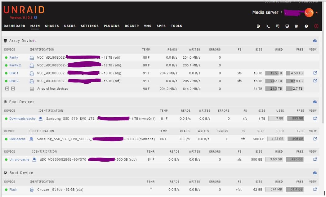

But we come full circle back to the Unraid server just not staying “Active” and becoming unresponsive. While copying data or trying the pre-clear a drive, the server just becomes unreachable. The GUI seems to be active at times, but if you try to make any changes or stop the array, it just spins.

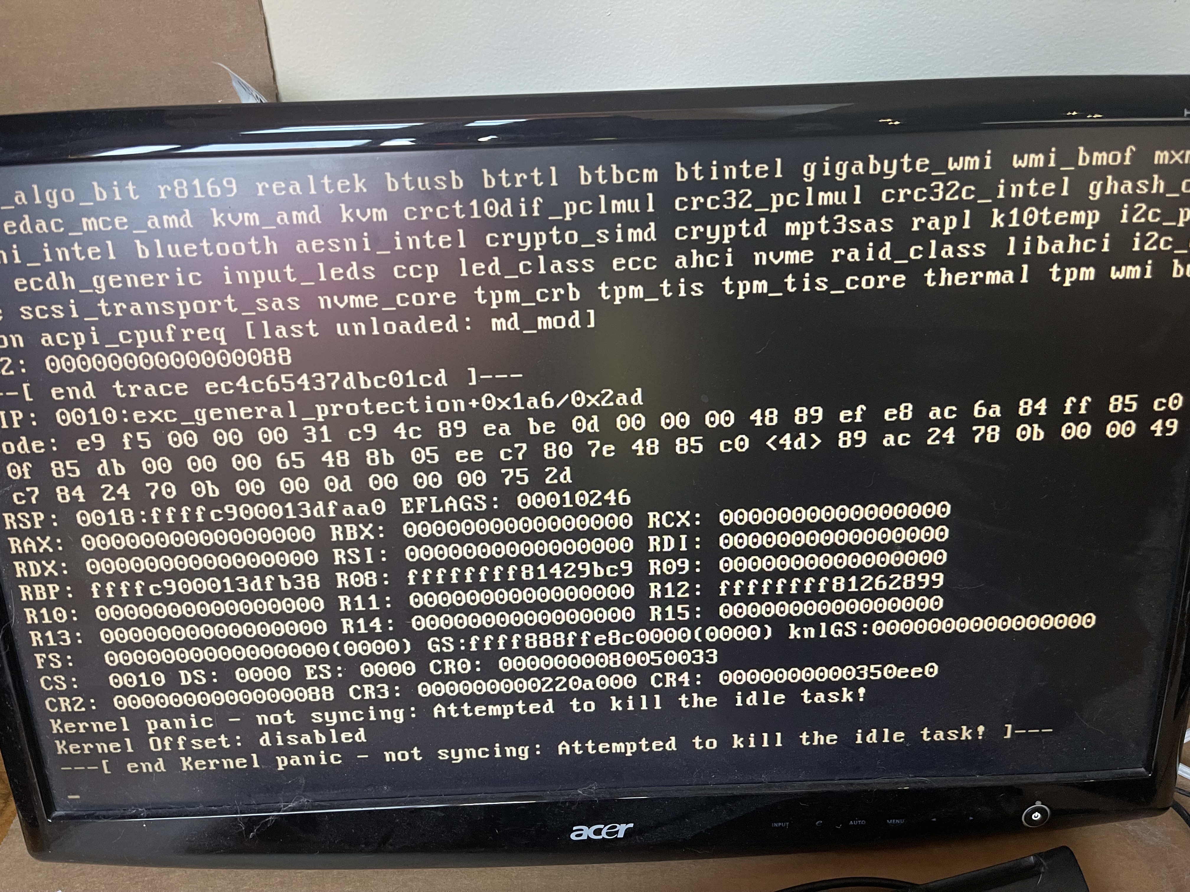

Attached to the post is my SysLog from a reboot to the lock up. In addition, I’ve captured a picture of the Server monitor show the last portion where it flashes up some errors.

It looks like a disk controller issue:
Aug 11 13:38:19 THOR kernel: mpt3sas 0000:05:00.0: invalid VPD tag 0x00 (size 0) at offset 0; assume missing optional EEPROM
Aug 11 13:38:19 THOR kernel: r8169 0000:08:00.0: invalid VPD tag 0x00 (size 0) at offset 0; assume missing optional EEPROM
Aug 11 13:38:21 THOR unassigned.devices: Mounting 'Auto Mount' Remote Shares...
Aug 11 13:38:30 THOR kernel: mdcmd (37): nocheck cancel
Aug 11 13:38:30 THOR kernel: md: recovery thread: exit status: -4
Aug 11 13:43:14 THOR kernel: smartctl[1871]: segfault at 146a1f38 ip 0000152cab3776ea sp 00007fffd8de7940 error 6 in libc-2.33.so[152cab2b0000+15e000]
Aug 11 13:43:14 THOR kernel: Code: 00 00 00 83 f8 0f 0f 84 11 18 00 00 48 8b 4b 70 8d 50 01 48 8b 7c 24 08 48 c1 e0 06 89 93 80 00 00 00 66 0f ef c0 48 8d 14 01 <0f> 11 44 01 08 48 8d 74 01 08 48 c7 42 18 00 00 00 00 f3 0f 6f 3f
Aug 11 13:45:46 THOR kernel: smartctl[12254]: segfault at 38 ip 00001475db5e6a1c sp 00007ffdaa770790 error 4 in libc-2.33.so[1475db51c000+15e000]
Aug 11 13:45:46 THOR kernel: Code: 83 c7 01 41 83 ff 40 75 d5 83 c3 40 49 83 c4 08 81 fb 00 01 00 00 75 c1 4c 8b 65 00 e9 8d f6 ff ff 0f 1f 44 00 00 49 8b 56 20 <8b> 72 38 48 8b 55 18 89 34 82 4d 8b 6e 08 4d 85 ed 74 14 4d 89 ee
smartctl is segfaulting.  We will need a disk guru like @JorgeB to take a look.
You also have a realtek NIC and that may be causing some issues.  Realtek drivers on Linux are troublesome because they are not updated for each release of Linux.
Unraid driver is crashing, this can sometimes be helped by using a different kernel, update to v6.11.0-rc3 to see if it helps.

Well I upgraded to 6.11.0-rc3 and set out to add my next disc into the array and began the clear on it.  Only lasted about 1 or 2 hours before the errors and unresponsiveness kicked in again.  Attached are my latest diagnostics.
Any further suggestions would be appreciated.
-Keelhaulers
thor-diagnostics-20220812-0952.zip
Smartctl segfaulting is strange, could be a hardware issue, do you remember if the issues started after an Unraid release upgrade? If there's a known working release downgrade back to it, boot it safe mode, if the issues continue it's likely hardware.

No go on this either. I do keep noticing that the errors state that there is a time sync issue.  So I decided to check on the BIOS, the time is wrong. I reset it, but after about an hour it changes again.  I'm going to change out the CMOS battery and see if I can at least get different results.  I don't have high hopes though.
Edited by Keelhaulers
typos
Time should not change with the server on, even with a bad CMOS battery,  board might be going bad.
yep, as you suspected. New CMOS battery had no affect. Still getting Kernel Panic.
