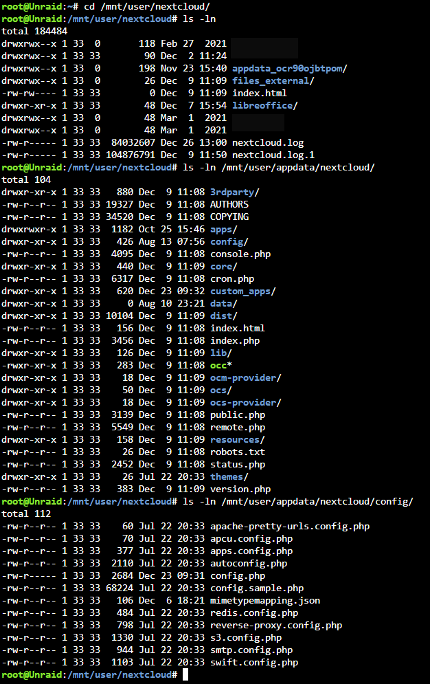

What's the owner of your nextcloud appdata folder and contents? Should be user/group 33, shows up as sshd on current unraid
Edited by Kilrah
Should I:  chown -R user:33 ?
chown -R 33:33 yes
hmmm well:
 image.png.09be0d49e5c28feb1e1ea8604a15e7b5.pngimage.thumb.png.06b7029480c032e72e9cedb5f36dc718.png
Di I have to edit my data dir too ?
uhm wait. I tried it like tat and looks like it's working
docker exec -u root nextcloud chown -R 33:33 *
But I can't access the website
docker exec -u root nextcloud chown -R 33:users *
was the correct command. Thanks for you help!

I'm realy struggeling with the permissions for the Nextcloud cron.
Can't run with the nextcloud basic config. When I run this command "docker exec -u root nextcloud chown -R 33:users * "
the cron works... but then I'm unable to access nextcloud
Unable to write to the "config" directory!
This problem is usually solved by giving the web server write access to the configuration directory. Or, if you prefer to keep the config.php file read-only, set the "config_is_read_only" option to true. See https://docs.nextcloud.com/server/25/go.php?to=admin-config
when I run: "docker exec -u root nextcloud chown -R 99:users * "
I do have access on nextcloud but the script can't access (just like in the begining)
I was able to fix it once in the past but then I had no access to the nextcloud appstore.
Do you have any hint ?

Having this same exact issue. Using knex666's docker image of nextcloud.
Setting permissions to 33:users lets the cron docker image run the script, but then the nextcloud container can't access anything. Switching permissions back to 99 gives nextcloud access, but then the cron docker image doesn't work.
2 options:
1) Change the user in the advanced settings of the cronjob container to 99:
2) remove the --user 99:100 in Extra Parameters of the knex666 template, then on unraid terminal
chown -R 33:33 /mnt/user/appdata/nextcloud/ (or your folder)
It should then work fine.
Edited by Kilrah
6 hours ago, Kilrah said:
2 options:
Did option 1. Had to change the perms for the data folder & contents to 99 since, for whatever reason, it was set to 33. Works now.
