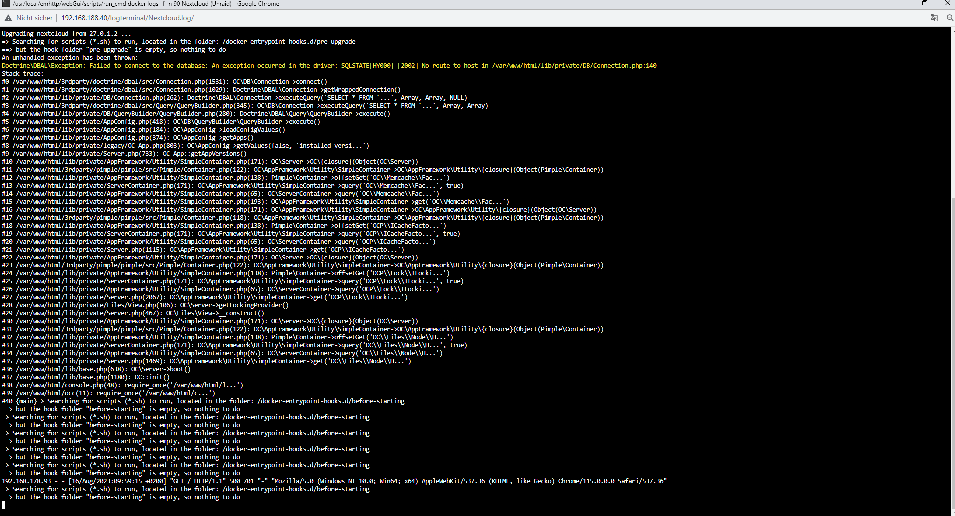

Unfortunately I've been having problems with Nextcloud since yesterday.
I noticed it when I couldn't access my data with my iPhone.
Then I just restarted Docker on my cell phone in the hope that it would help (of course not)
Then I was so "clever" and updated the container because it showed me an update and also had the hope that it would work again.
Then today I checked the log again while I was at rest on the PC.

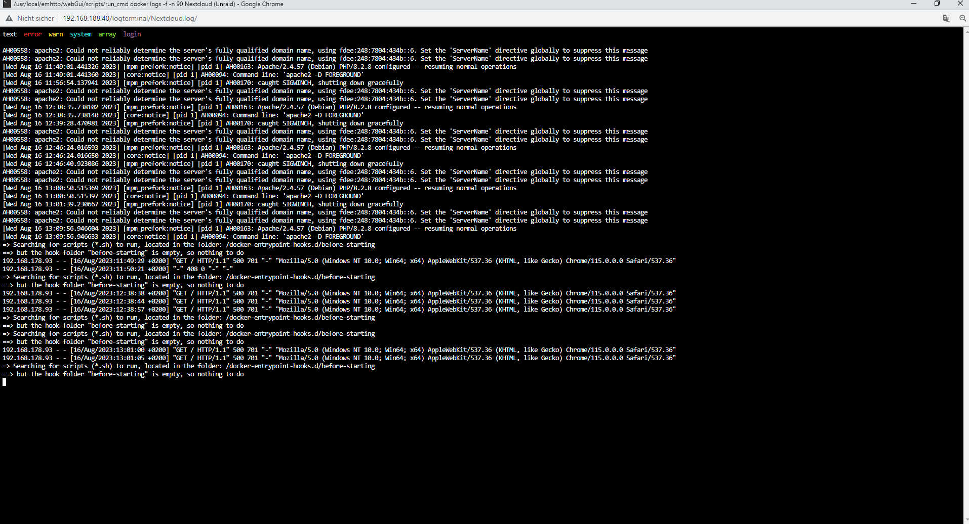

This is in the log:
I've searched the internet up and down, but can't find a solution.
However, the yellow message no longer appears in the LOG:

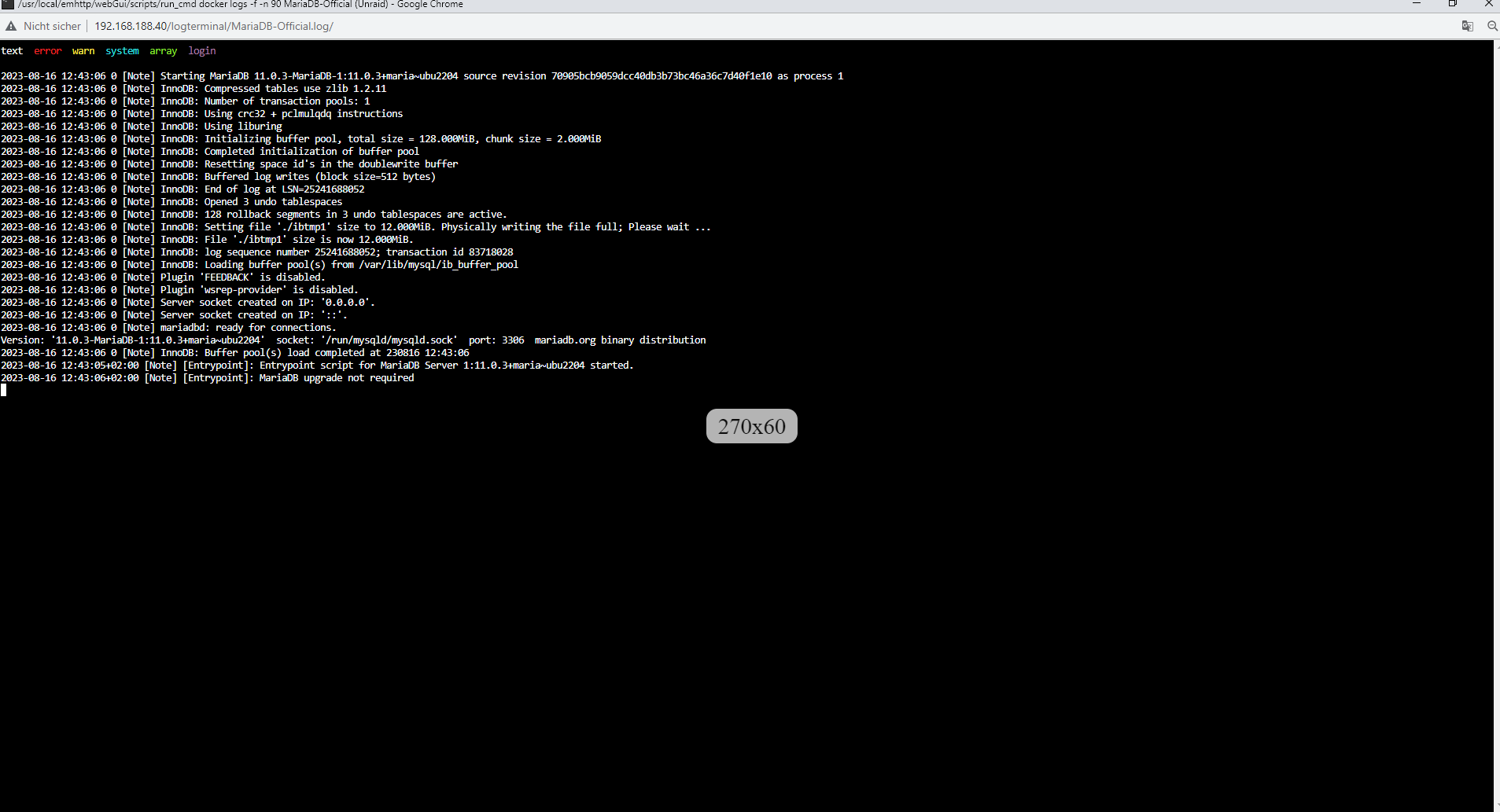

Mariadb's log is also unremarkable:
Where can and must I start? I'm very clueless right now.
Doesn't seem that either has an issue, but somehow your 2 containers can't talk to each other anymore. Did you do any networking changes?
How do they recognize that there is no communication between them?
No, I did not make any changes to the network myself
Well the "no route to host" was that the system returned there was no way to reach the host configured as mariadb server...
Is it set by hostname or ip?
Check nextcloud's appdata is there, and how the mariadb server is defined in the config.php file
