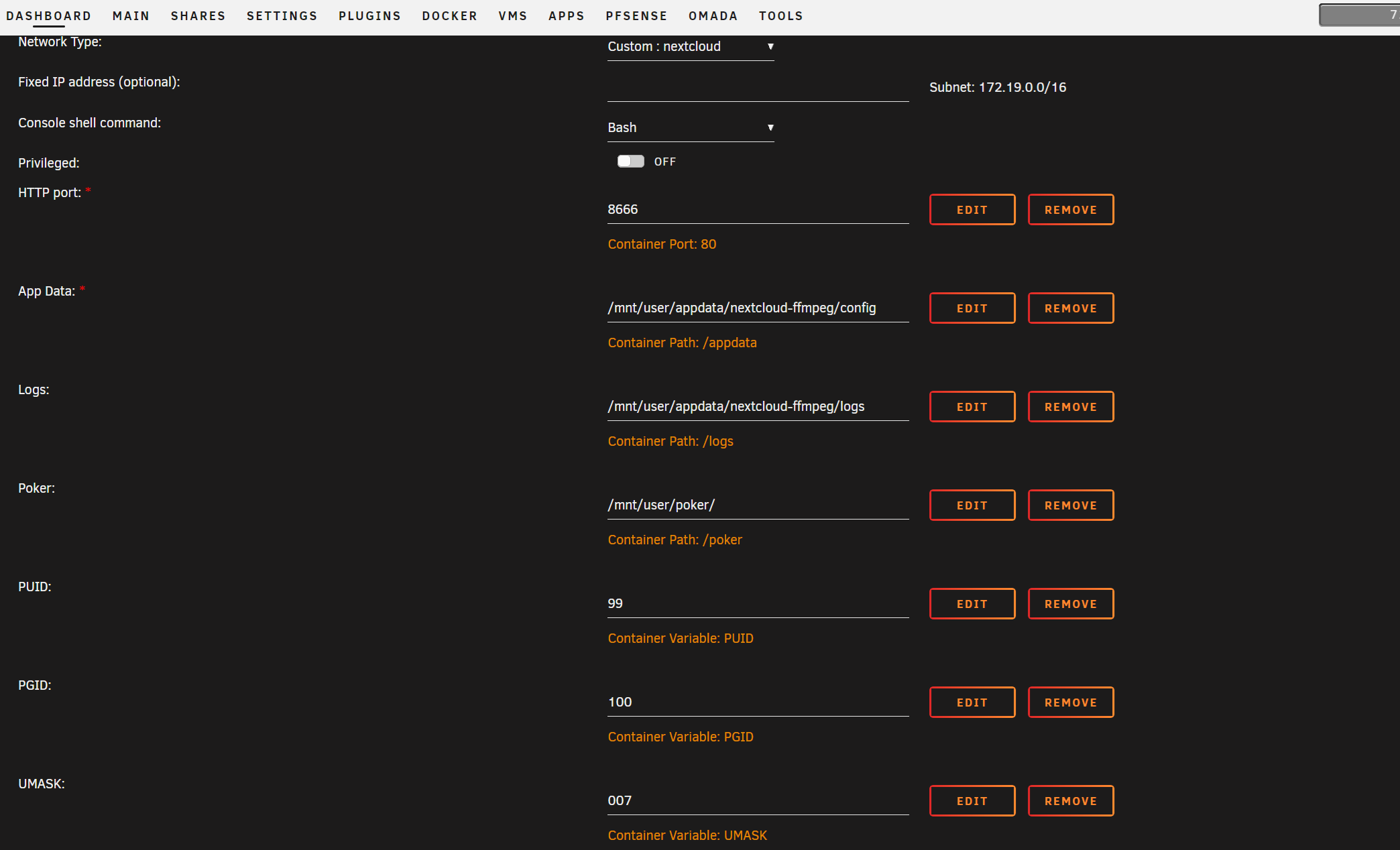

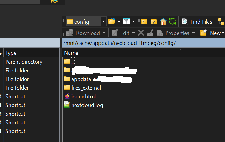

So I have gotten it to this point by doing some heavy reading and trial and error.  Here is my template page.  I'm trying to keep things on the cache and keep things neat where I can change things and tinker when I want.  The cloud is actually up and running.  Had to use the commands from earlier in the thread to change ownership and permissions, but that let me install it into the appdata directory that I picked.  Or so I think anyway.  The problem is, I don't see any of the config files when I look for them.  The other screenshot shows all the files I see in the appdata folder.  So I have no idea where the actual config files are going.  In spite of that, you can see my cloud is up and running somehow.  This thing has one hell of a learning curve.

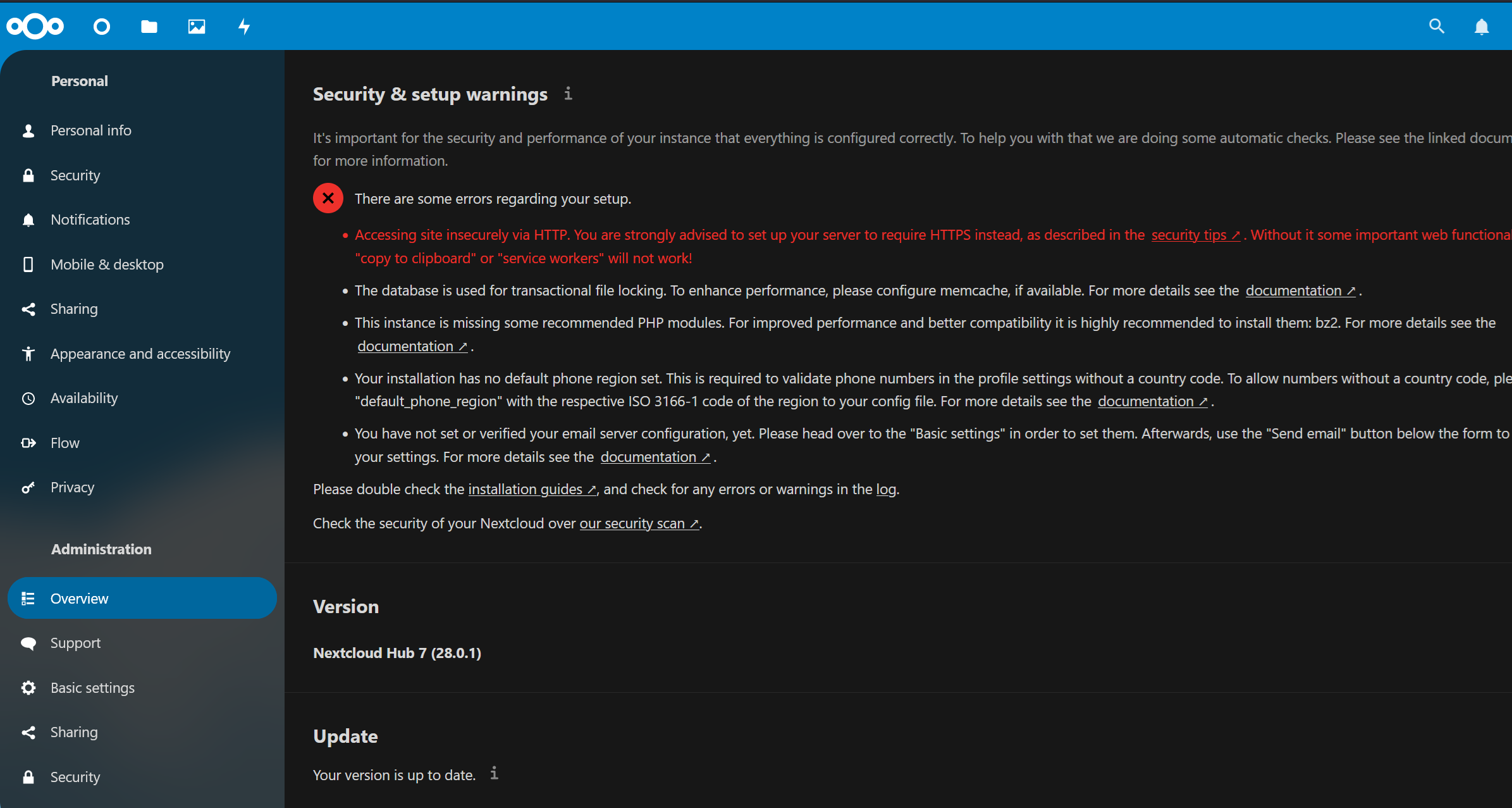

I was able to get rid of all those errors thanks to chat gpt ill see if I can share what I did need to review but I wasn’t able to create new folders
I was going to share the chat with you but for the br2 one thats a bug as of right now i applied a workaround i found on nextclouds site but honestly that probably made things worse
The http that wasnt the error i had but you may need some advanced setup in nginx for that
the phone error is a config file line if you care about fixing that error
memcache you need to install redis and add a line to point to redis in the config file
email, just add email settings

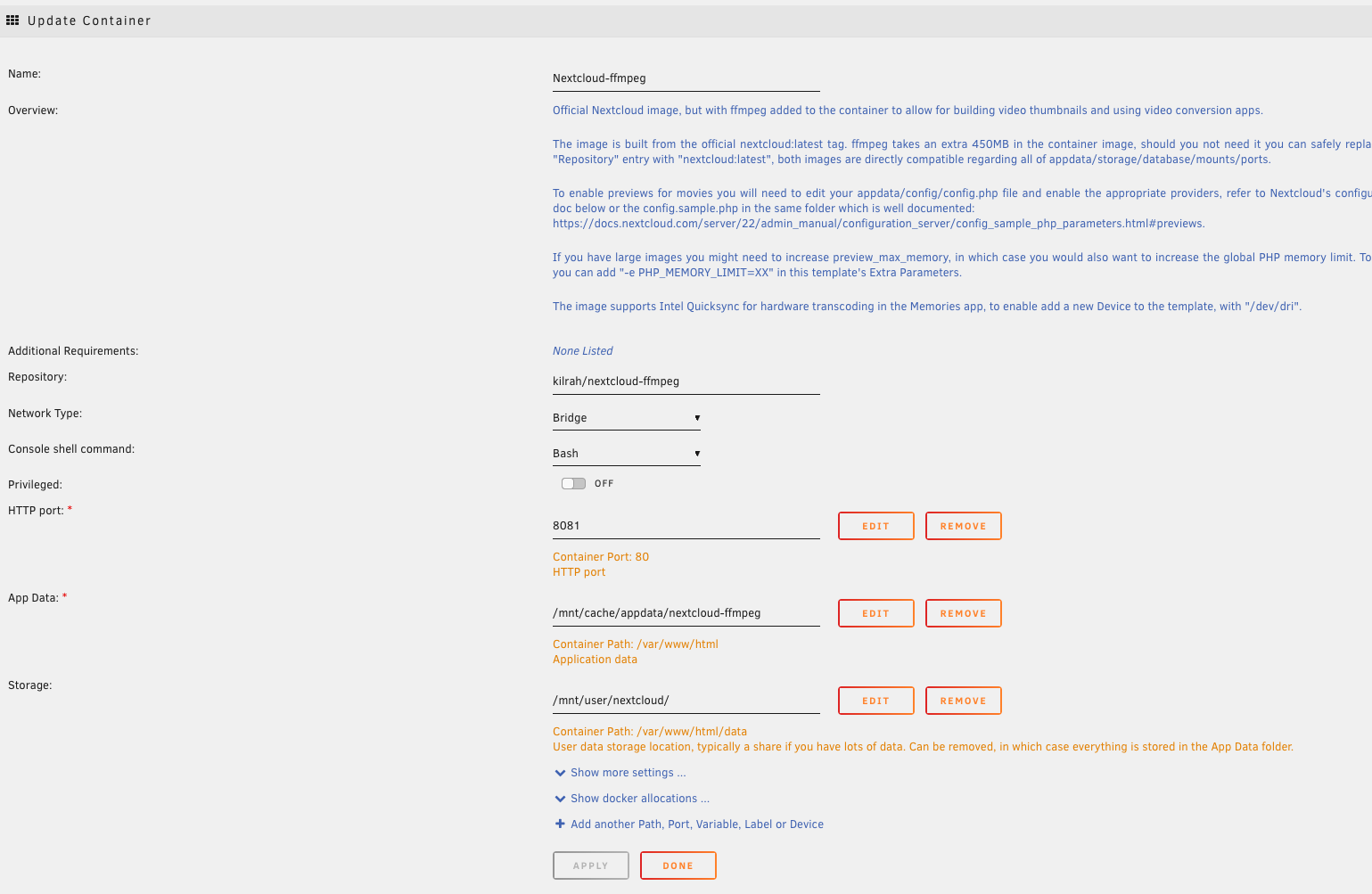

For some reason you mapped your appdata folder to a "/appdata" path in the container. That's not something the container uses or knows about, so right now all your config files are lost in the docker image.
The container stores its things in /var/www/html as can see in the original template:
