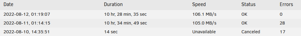

August 12, 20224 yr Hello, so a couple of days ago I tried adding a new drive to my array. So just like the previous times I did so, I ran 2 cycles of preclear and everything seemed fie with the drive. #################################################################################################### # Unraid Server Preclear of disk XXXXXXXX # # Cycle 2 of 2, partition start on sector 64. # # # # Step 1 of 5 - Pre-read verification: [6:38:01 @ 167 MB/s] SUCCESS # # Step 2 of 5 - Zeroing the disk: [6:38:53 @ 167 MB/s] SUCCESS # # Step 3 of 5 - Writing Unraid's Preclear signature: SUCCESS # # Step 4 of 5 - Verifying Unraid's Preclear signature: SUCCESS # # Step 5 of 5 - Post-Read verification: [6:38:04 @ 167 MB/s] SUCCESS # # # # # # # #################################################################################################### # Cycle elapsed time: 19:55:01 | Total elapsed time: 39:50:13 # #################################################################################################### #################################################################################################### # S.M.A.R.T. Status (device type: default) # # # # ATTRIBUTE INITIAL CYCLE 1 CYCLE 2 STATUS # # Reallocated_Sector_Ct 0 0 0 - # # Power_On_Hours 0 20 40 Up 40 # # End-to-End_Error 0 0 0 - # # Reported_Uncorrect 0 0 0 - # # Airflow_Temperature_Cel 27 32 31 Up 4 # # Current_Pending_Sector 0 0 0 - # # Offline_Uncorrectable 0 0 0 - # # UDMA_CRC_Error_Count 0 0 0 - # # # #################################################################################################### # # #################################################################################################### --> ATTENTION: Please take a look into the SMART report above for drive health issues. --> RESULT: Preclear Finished Successfully!. After that, I spun down my array and added the new disk. After restarting the array I got the "Unmountable: Unsupported partition layout" error shown next to the drive, so I wanted to stop the array but after waiting for 20 minutes it still hadn't stopped, so I tried using the shutdown button in the GUI and the server shut down. After starting back up I don't remember if I tried formatting the drive again and then starting the array or just starting it. But when it started, I noticed that it had detected an unclean shutdown so it started a parity check with the "Unmountable: Unsupported partition layout" drive in the array and it started showing (and correcting sync errors). Aug 10 14:35:37 Serverina kernel: md: recovery thread: check P Q ... Aug 10 14:35:37 Serverina kernel: md: recovery thread: PQ corrected, sector=0 Aug 10 14:35:37 Serverina kernel: md: recovery thread: PQ corrected, sector=8 Aug 10 14:35:37 Serverina kernel: md: recovery thread: PQ corrected, sector=16 Aug 10 14:35:37 Serverina kernel: md: recovery thread: PQ corrected, sector=24 Aug 10 14:35:37 Serverina kernel: md: recovery thread: PQ corrected, sector=32 Aug 10 14:35:37 Serverina kernel: md: recovery thread: PQ corrected, sector=40 Aug 10 14:35:37 Serverina kernel: md: recovery thread: PQ corrected, sector=48 Aug 10 14:35:37 Serverina kernel: md: recovery thread: PQ corrected, sector=56 Aug 10 14:35:37 Serverina kernel: md: recovery thread: PQ corrected, sector=64 Aug 10 14:35:37 Serverina kernel: md: recovery thread: PQ corrected, sector=128 Aug 10 14:35:37 Serverina kernel: md: recovery thread: PQ corrected, sector=136 Aug 10 14:35:37 Serverina kernel: md: recovery thread: PQ corrected, sector=144 Aug 10 14:35:37 Serverina kernel: md: recovery thread: PQ corrected, sector=152 Aug 10 14:35:37 Serverina kernel: md: recovery thread: PQ corrected, sector=160 Aug 10 14:35:37 Serverina kernel: md: recovery thread: PQ corrected, sector=168 Aug 10 14:35:37 Serverina kernel: md: recovery thread: PQ corrected, sector=176 Aug 10 14:35:37 Serverina kernel: md: recovery thread: PQ corrected, sector=184 So I panicked and quickly stopped it. After that I used the format unmountable drives in array option which formatted the drive properly this time and it was successfully added into the array. After seeing the previous errors I started another parity check which resulted in 28 errors being corrected: Aug 10 17:10:05 Serverina kernel: md: recovery thread: PQ corrected, sector=1953509272 Aug 10 17:10:05 Serverina kernel: md: recovery thread: PQ corrected, sector=1953509280 Aug 10 17:10:05 Serverina kernel: md: recovery thread: PQ corrected, sector=1953509288 Aug 10 17:10:05 Serverina kernel: md: recovery thread: PQ corrected, sector=1953509296 Aug 10 17:10:05 Serverina kernel: md: recovery thread: PQ corrected, sector=1953509304 Aug 10 17:10:05 Serverina kernel: md: recovery thread: PQ corrected, sector=1953509312 Aug 10 17:10:05 Serverina kernel: md: recovery thread: PQ corrected, sector=1953509320 Aug 10 17:10:05 Serverina kernel: md: recovery thread: PQ corrected, sector=1953509328 Aug 10 17:10:05 Serverina kernel: md: recovery thread: PQ corrected, sector=1953509336 Aug 10 19:16:51 Serverina kernel: md: recovery thread: PQ corrected, sector=3907018544 Aug 10 19:16:51 Serverina kernel: md: recovery thread: PQ corrected, sector=3907018552 Aug 10 19:16:51 Serverina kernel: md: recovery thread: PQ corrected, sector=3907018560 Aug 10 19:16:51 Serverina kernel: md: recovery thread: PQ corrected, sector=3907018568 Aug 10 19:16:51 Serverina kernel: md: recovery thread: PQ corrected, sector=3907018576 Aug 10 19:16:51 Serverina kernel: md: recovery thread: PQ corrected, sector=3907018584 Aug 10 19:16:51 Serverina kernel: md: recovery thread: PQ corrected, sector=3907018592 Aug 10 19:16:51 Serverina kernel: md: recovery thread: PQ corrected, sector=3907018600 Aug 10 19:16:51 Serverina kernel: md: recovery thread: PQ corrected, sector=3907018608 Aug 10 19:16:51 Serverina kernel: md: recovery thread: PQ corrected, sector=3907018616 Aug 10 21:46:07 Serverina kernel: md: recovery thread: PQ corrected, sector=5860527816 Aug 10 21:46:07 Serverina kernel: md: recovery thread: PQ corrected, sector=5860527824 Aug 10 21:46:07 Serverina kernel: md: recovery thread: PQ corrected, sector=5860527832 Aug 10 21:46:07 Serverina kernel: md: recovery thread: PQ corrected, sector=5860527840 Aug 10 21:46:07 Serverina kernel: md: recovery thread: PQ corrected, sector=5860527848 Aug 10 21:46:07 Serverina kernel: md: recovery thread: PQ corrected, sector=5860527856 Aug 10 21:46:07 Serverina kernel: md: recovery thread: PQ corrected, sector=5860527864 Aug 10 21:46:07 Serverina kernel: md: recovery thread: PQ corrected, sector=5860527872 Aug 10 21:46:07 Serverina kernel: md: recovery thread: PQ corrected, sector=5860527880 So after reading some other posts regarding parity I ran another parity check the next day, just to make sure there was no issues with the hardware and it found no errors. My main question is, should I be worried about any data loss? Or have any of my files potentially been damaged? As far as I can see, everything seems to be running fine now, but I would just like to make sure. I have attached my two diagnostics files (the older one contains the parity checks that found errors and the second one is the one where I ran the second parity check the next day (there was a reboot in between)) Also slightly unrelated: When looking at the parity errors I found the following regarding my cache drive in the logs Aug 10 23:05:21 Serverina kernel: blk_update_request: critical target error, dev sdb, sector 976773120 op 0x3:(DISCARD) flags 0x800 phys_seg 1 prio class 0 Aug 10 23:05:21 Serverina kernel: BTRFS warning (device sdb1): failed to trim 1 device(s), last error -121 Should I be worried about this? I am currently running only a single cache drive, but I was planing on adding a second one of the same capacity which should be arriving next week. serverina-diagnostics-20220811-0118.zip serverina-diagnostics-20220812-1409.zip
August 12, 20224 yr Community Expert Solution 1 hour ago, obuwunkunubi said: After restarting the array I got the "Unmountable: Unsupported partition layout" error shown next to the drive, so I wanted to stop the array Why? Just needed to format the disk. 1 hour ago, obuwunkunubi said: My main question is, should I be worried about any data loss? No, a few sync errors after an unclean shutdown are normal, even expected, last check detected 0 errors so all is good now.
August 12, 20224 yr Author 2 minutes ago, JorgeB said: Why? Just needed to format the disk. Sadly I forgot that that was an option while the disk was in the array, even though that's the way I did it last time. 4 minutes ago, JorgeB said: No, a few sync errors after an unclean shutdown are normal, even expected, last check detected 0 errors so all is good now. Thanks for the confirmation! I thought that was the case, but I just wanted to make sure. Do you by chance also have any advice regarding the BTRFS trim warning/error at the end? Aug 11 23:05:28 Serverina kernel: blk_update_request: critical target error, dev sdb, sector 976773120 op 0x3:(DISCARD) flags 0x800 phys_seg 1 prio class 0 Aug 11 23:05:28 Serverina kernel: BTRFS warning (device sdb1): failed to trim 1 device(s), last error -121 I noticed it for the first time then, but it seems to be showing up daily (at the time my Dynamix SSD TRIM plugin is set to run). Since the issue seems to be regarding the plugin, I guess that I should ask in the Dynamix Plugins thread.
August 12, 20224 yr Community Expert 15 minutes ago, obuwunkunubi said: Do you by chance also have any advice regarding the BTRFS trim warning/error at the end? The LSI HBA doesn't support trim, use the Intel SATA ports for the SSD instead, but change the mode to AHCI in the BIOS, it's set to IDE.
