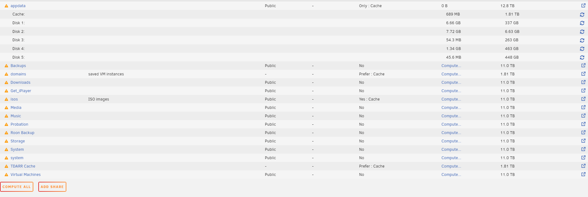

Go to User Shares page, click Compute All button at bottom, wait for the results to complete. If you don't have complete results after a few minutes, refresh the page.
Then post a screenshot.

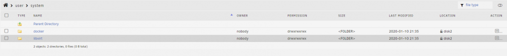

You do have 2 "system" shares, as you can see, but one of them is named "System". Linux is case-sensitive, so these are different shares with different paths. The usual naming for that is "system". We need to find out what is in "System"
That screenshot is not the complete results. When the results are complete, each share will show how much of each disk is used by the share. Maybe you only did Compute... on appdata instead of Compute All button?

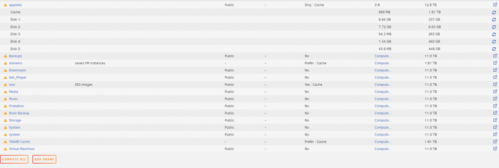

Is that any better?

I recommend NOT sharing disks. Several ways to get yourself in trouble with that. And since you have Dynamix File Manager plugin, you can manage files on the disks anyway, and it won't let you get in trouble.

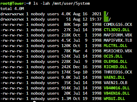

What do you get from the command line with this?
ls -lah /mnt/user/System
and this?
ls -lah /mnt/user/system

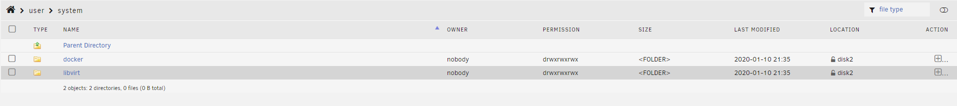

Or if you'd rather you can just use the webUI to drill down into System and system shares and post screenshots of the contents
and this?

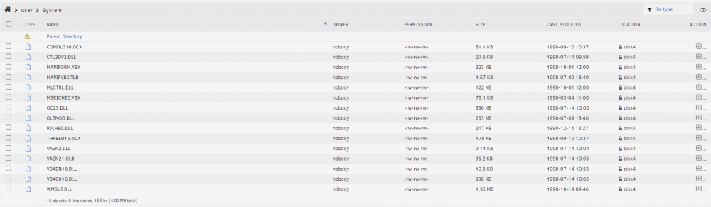

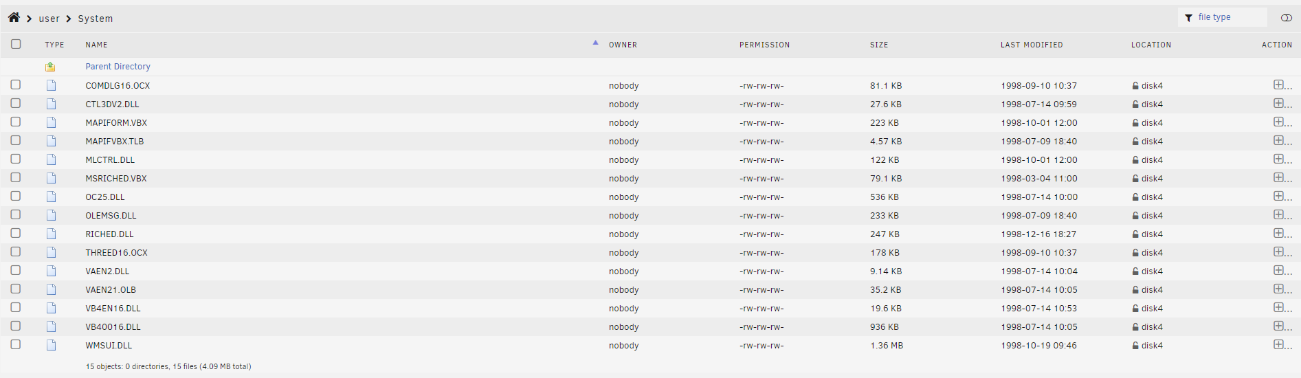

Any idea what all that in System folder is? Looks more Windows related than Unraid.
No idea, looks like Windows stuff to me and hasn't been modified for a 1/4 century....
I suspect some backup of a windows folder from way, way back.
If you don't know what it is I guess you don't need it. In any case, you don't want a user share named System. Delete or move the contents, then delete the System user share. Of course you want to keep the system user share.
