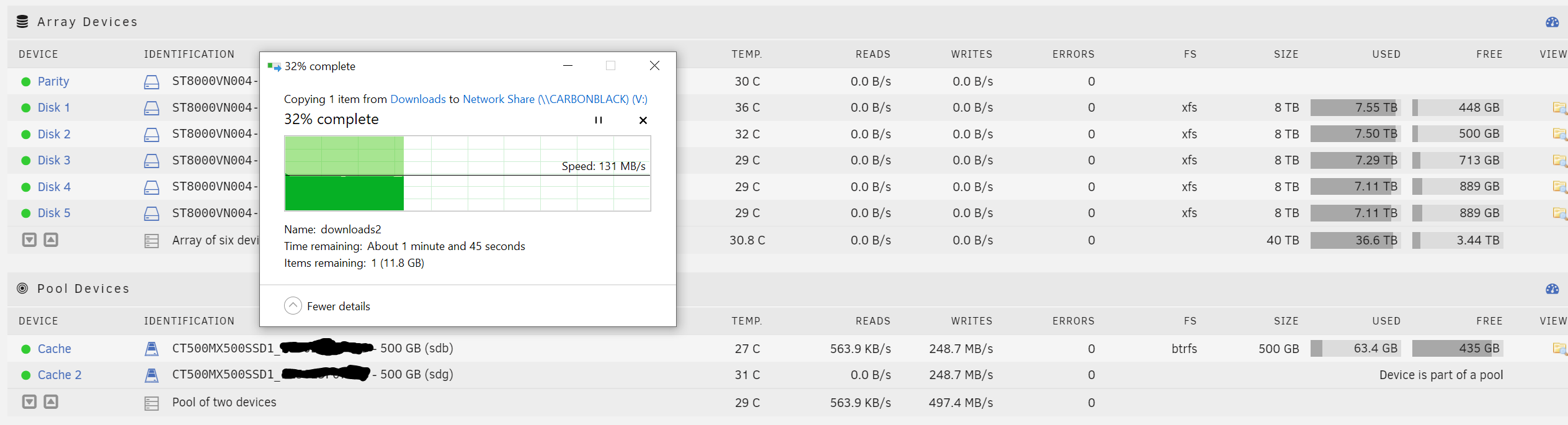

So i recently upgraded to 2.5 gigabit networking and have noticed my transfer speed when writing is only hitting around 130MB/s read is 210-230MB/s (To and from the SSD cache)

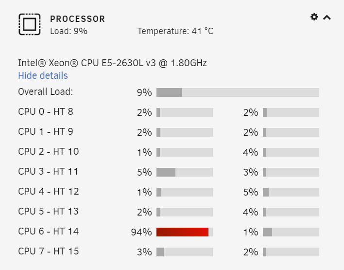

When writing i have one core on the server at 90% or more then writing is this a problem.

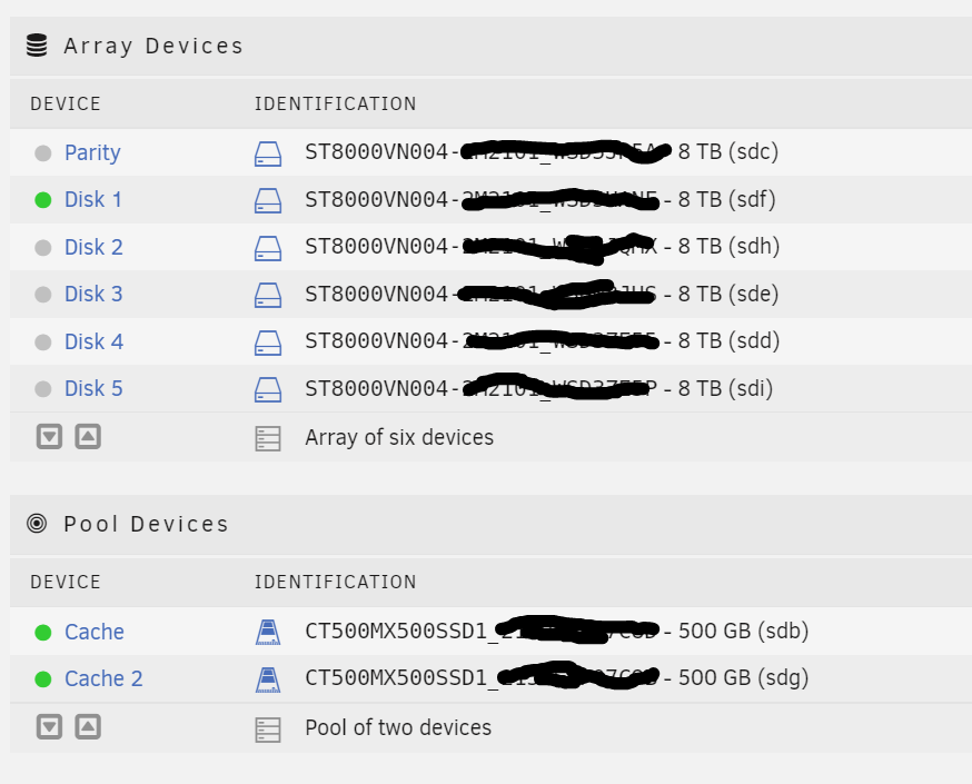

Storage:
       Cache: 2 x Crucial MX500 500GB
       Array: 6 x Seagate 8TB IronWolf NAS

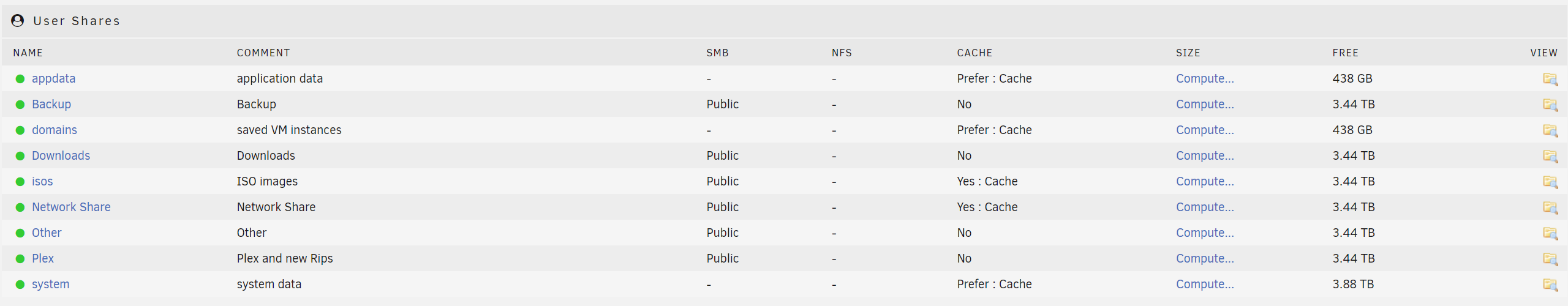

Are you absolutely sure you are writing to a cached user share?
SMB is single threaded, for 10GbE I would expect a possible bottleneck, but that CPU should be enough for 2.5GbE, if you have an array disk still empty, and because disks are much faster in the outer sectors, enable turbo write and write directly to the array, it should be capable of 200MB/s+, just to check if if the pool is under performing.
Yep using my "Network Share" that has a cache

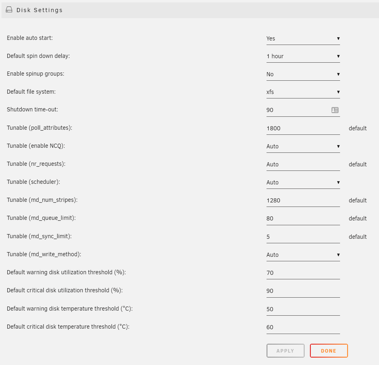

If i understand correctly setting Tunable (md_write_method) to "reconstruct write" would be Turbo write but all the drives need to be spinning i spin down my drives after 1 hr as its mostly used as a plex server not shore that would work great for me.
My drives have only 400 to 800GB per drive free using 8TB drives.
It would be for testing only, you could then change it back, but if the drives are almost full it won't be a very good test, instead enable disk shares and transfer to cache using the disk share to see if there's any difference.
