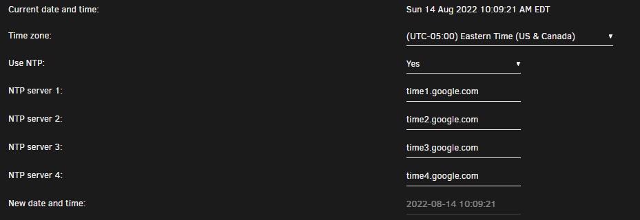

Yeah, that is going to be your entire problem.  Both the logs and CA's diagnostics show that the date is March 15, 2019 and SSL fails if the date is significantly out for security reasons.
Settings - Date & Time. set the correct date & time and also give the system a couple of ntp servers
That seems do have done the trick! That was not what I expected it to be :D
