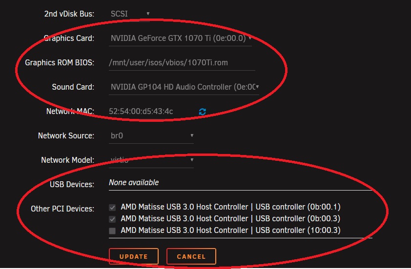

This is a hard one for me. I will attach both the VM profile and a response from support but l simple don't see where or how to pass thought all 5 devices. Thanks Stumped ?? dlfz.Network

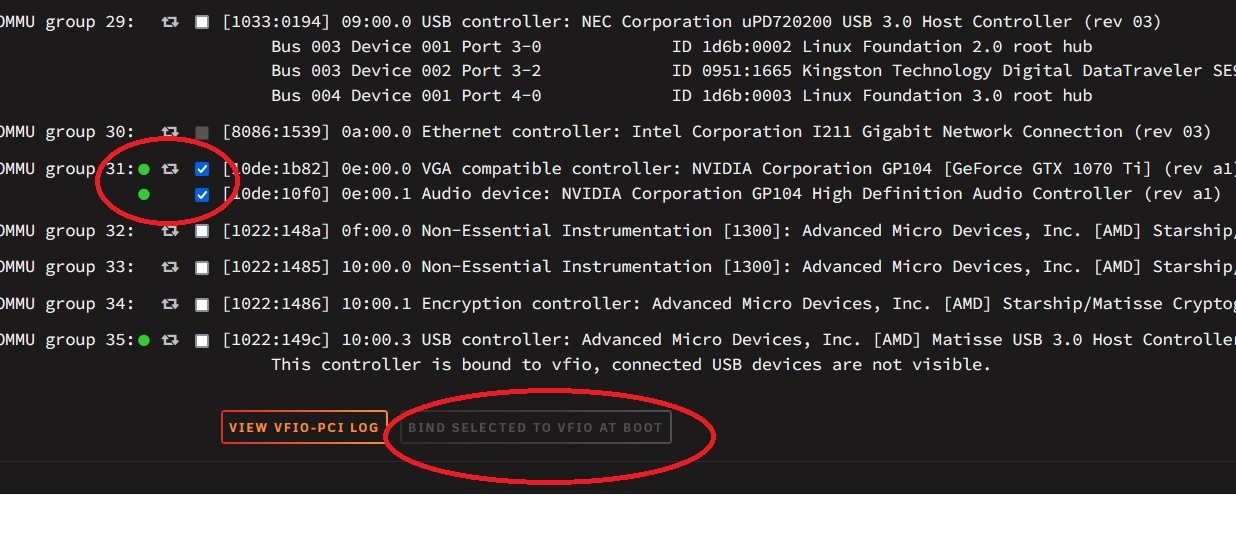

You just have usb controler on the card which is very good thing.  Go to "tools" > "System Devices" and find IOMMU group 15 mark the check boxes for these 4 devices and click on "BIND SELECTED TO VFIO AT BOOT" > reboot system. After reboot when you go to VM template you will have GPU and Audio part of it in the graphics card and Sound card section drop downs and the two usb controllers as a check boxes in "Other PCI devices section".
