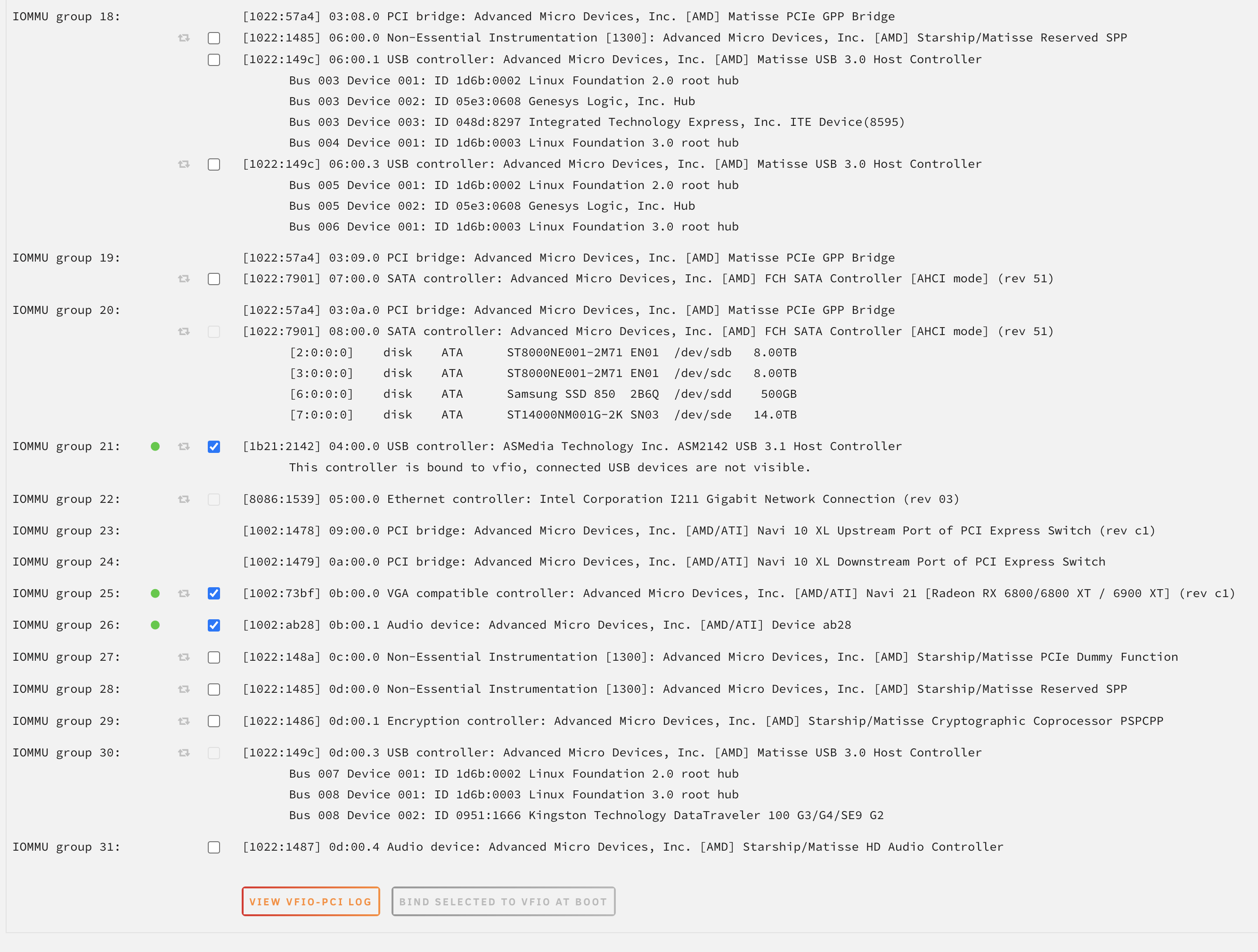

I also have both the AMD GPU, AMD GPU sound and the PCIe USB card bound to vfio at boot.

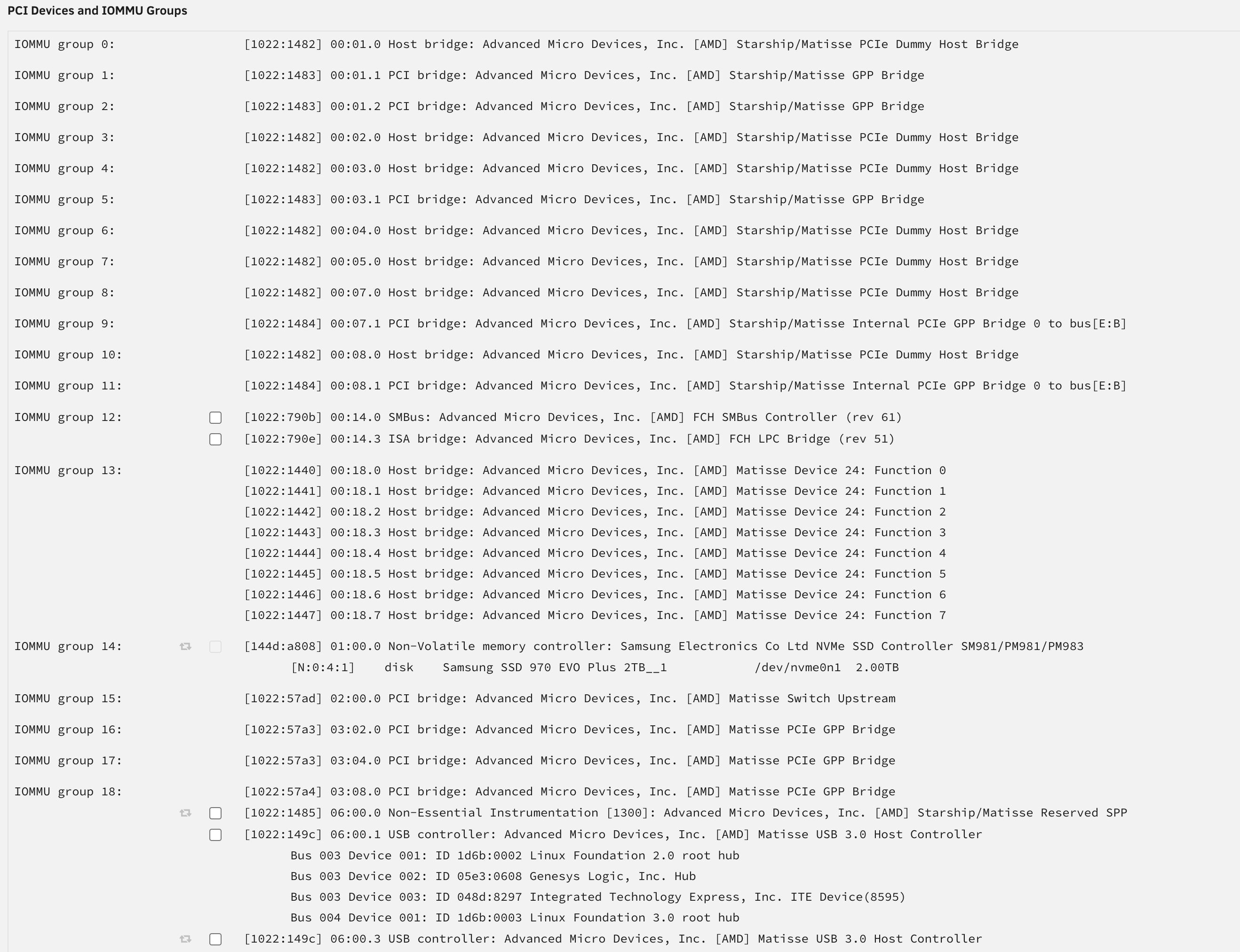

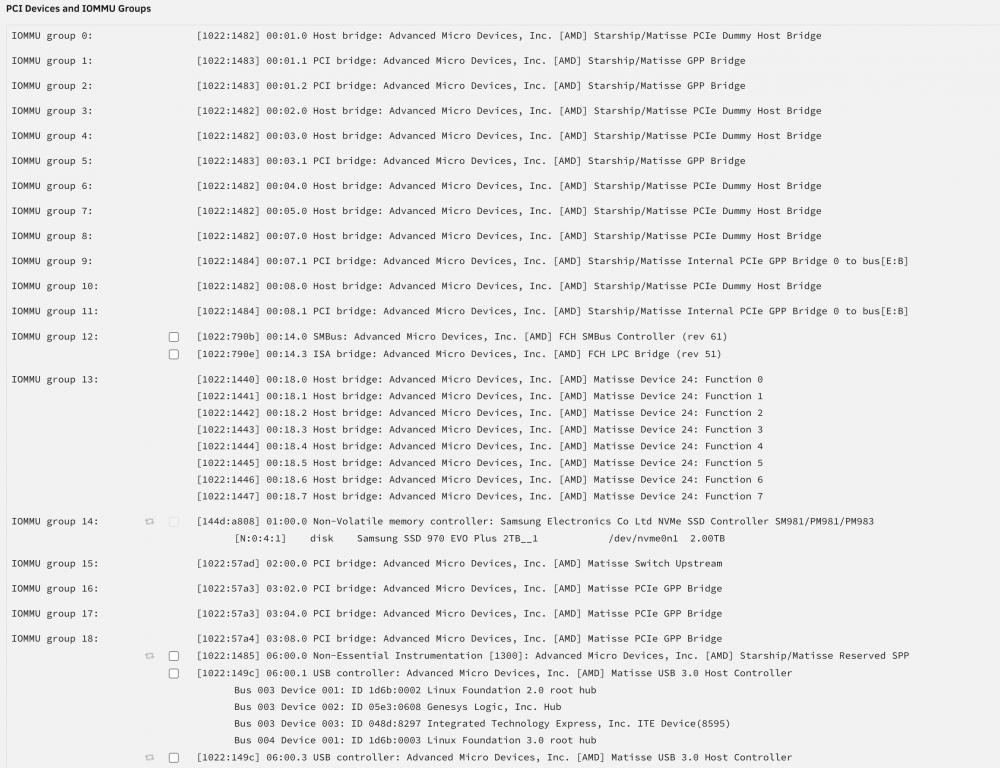

In my system devices I also have an ITE RGB LED Controller from my motherboard under the same USB controller as my Unraid Flash, I already tried placing it under a different IOMMU group but it still falls under the same [1022:149c]. Could this RGB LED controller be causing unraid crashing when windows booting?
Unraid Diagnostics and windows10 VM XML are attached.
