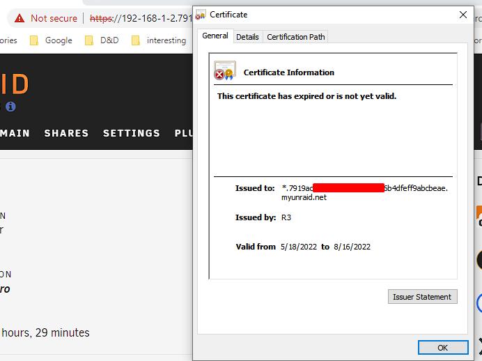

Beginning yesterday, every time I go to the Unraid GUI I get the error that the certificate is not valid/expired. But inside Management access it says certificate expires in Oct.  I have tried clearing cache and using another browser and get the same error.

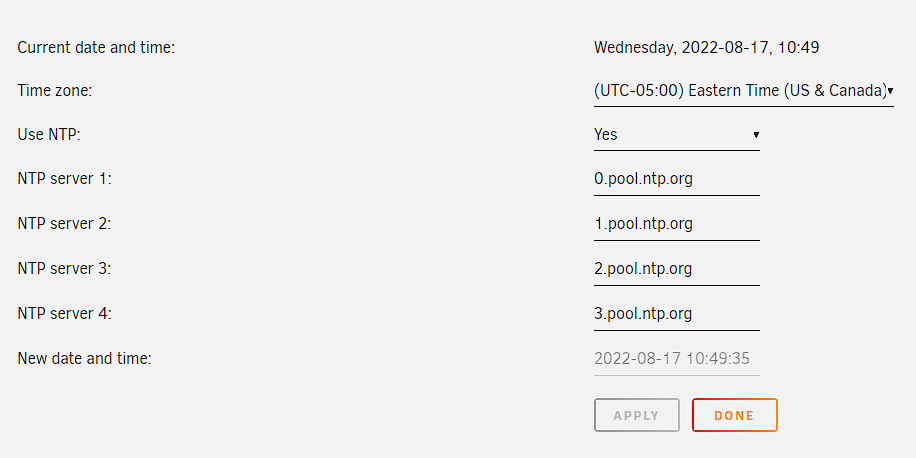

Just a guess but have you checked that the time is correct on the server?
Yes, the time and date all look correct.
