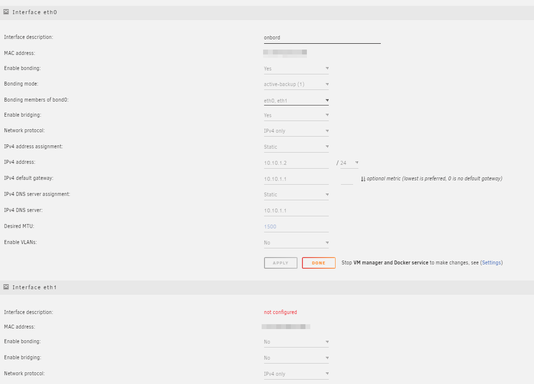

August 17, 20224 yr Hello, i am having 2 Nic card on my Unraid server. i can access Eth0. i am getting Eth1 as not configured. how do i configure Eth1
August 17, 20224 yr Community Expert Solution Disable bonding, then configure eth1 with a static IP, different subnet.
August 18, 20224 yr Author Hello, thanks for quick reply, i am not seeing the option to disable Bonding. every thing is grayed out
August 18, 20224 yr Community Expert 6 hours ago, Jeevan said: Hello, thanks for quick reply, i am not seeing the option to disable Bonding. every thing is grayed out Have you stopped the array? It needs to be stopped to change the network settings.
August 18, 20224 yr Author I am able to configure 2 networks on Unraid server. I disable Bonding on both the network. it is working as i configured. i configured ETH0 with 10.10.1.2. ETH1 with 192.168.1.2 i am able to access unraid from both the network thanks for Help
