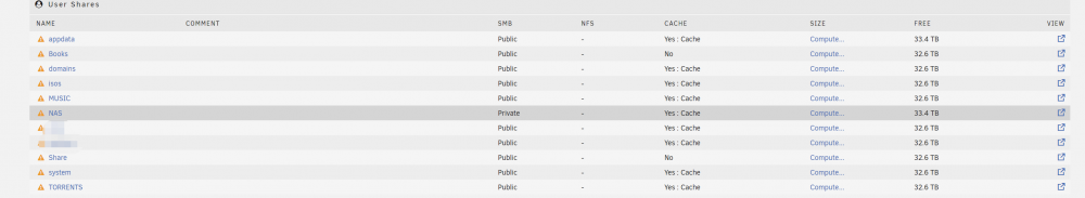

August 18, 20224 yr Author 8 minutes ago, trurl said: Are you copying to a cached user share? may be i am not sure.it shoud be in the cache at the first

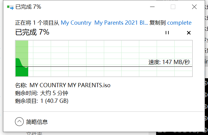

August 18, 20224 yr Community Expert If that screenshot means 147 MB/s, that is very good for copying to an array with parity.
August 18, 20224 yr Community Expert 1 minute ago, xenoblade said: may be i am not sure.it shoud be in the cache at the first Whether or not a user share uses cache depends on the setting for the user share. Default is to NOT use cache.
August 18, 20224 yr Author Just now, trurl said: If that screenshot means 147 MB/s, that is very good for copying to an array with parity. yes,the weird is.when i setting the ssd share folder.the speed is 150MB/S

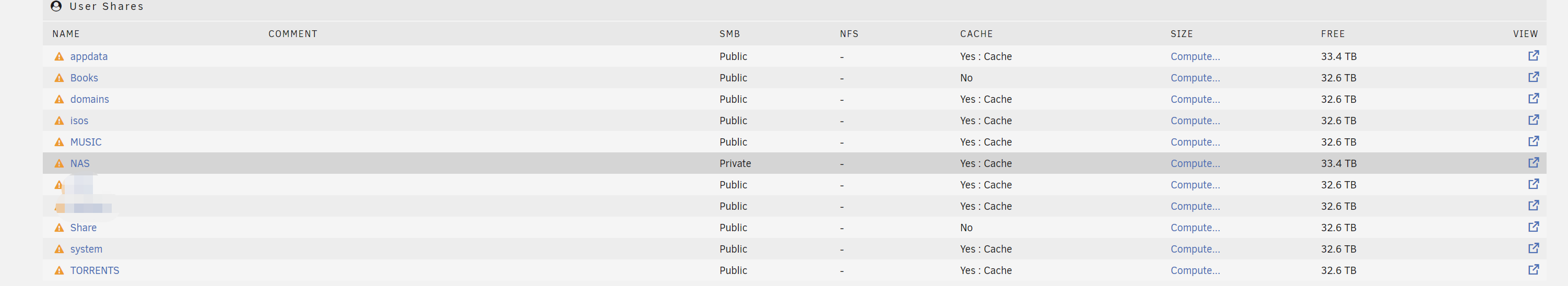

August 18, 20224 yr Community Expert 3 minutes ago, xenoblade said: yes,the weird is.when i setting the ssd share folder.the speed is 150MB/S Do you mean you have a user share named 'ssd'?
August 18, 20224 yr Author Just now, trurl said: Do you mean you have a user share named 'ssd'? no,my cache is ssd,i creat a folder use cache only.the speed should be over 220MB/S,but it still shows 120-150MB/S. the strange is the transfer speed is 270MB/S at the begining,then it came to 120-150MB/S

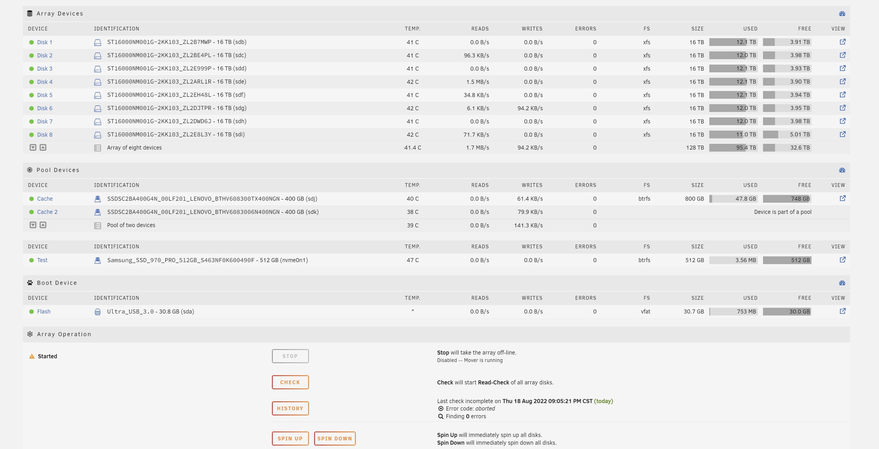

August 18, 20224 yr Author 1 minute ago, JorgeB said: Grab diags during that copy and post here. tower-diagnostics-20220818-2256.zip
August 18, 20224 yr Community Expert It's not writing to any device, maybe you grabbed the diags too soon, it can take a few seconds for writes to start while it's being cached to RAM.
August 18, 20224 yr Author 8 minutes ago, JorgeB said: It's not writing to any device, maybe you grabbed the diags too soon, it can take a few seconds for writes to start while it's being cached to RAM. it should be there now tower-diagnostics-20220818-2326.zip tower-diagnostics-20220818-2325.zip

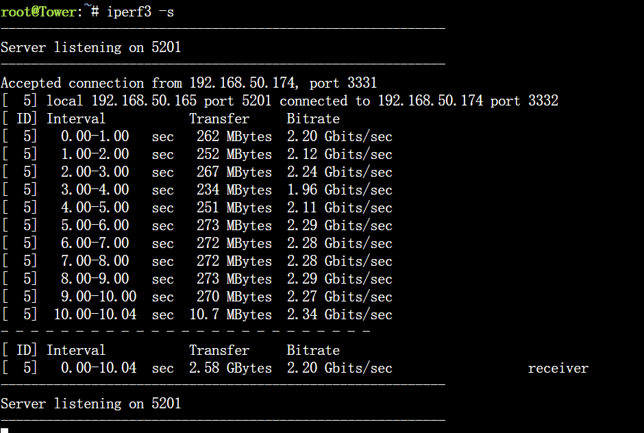

August 18, 20224 yr Community Expert Very strange, it's not device related since in one of the diags it was writing at 1.8GB/s, also doesn't look like it's LAN related due to iperf results and initial higher speed while it's caching to RAM, I'm stumped...

August 18, 20224 yr Author 1 hour ago, JorgeB said: Very strange, it's not device related since in one of the diags it was writing at 1.8GB/s, also doesn't look like it's LAN related due to iperf results and initial higher speed while it's caching to RAM, I'm stumped... yes,it is strange.when i copy file to the UNRAID. in the main page every drive's speed is 0 kb
