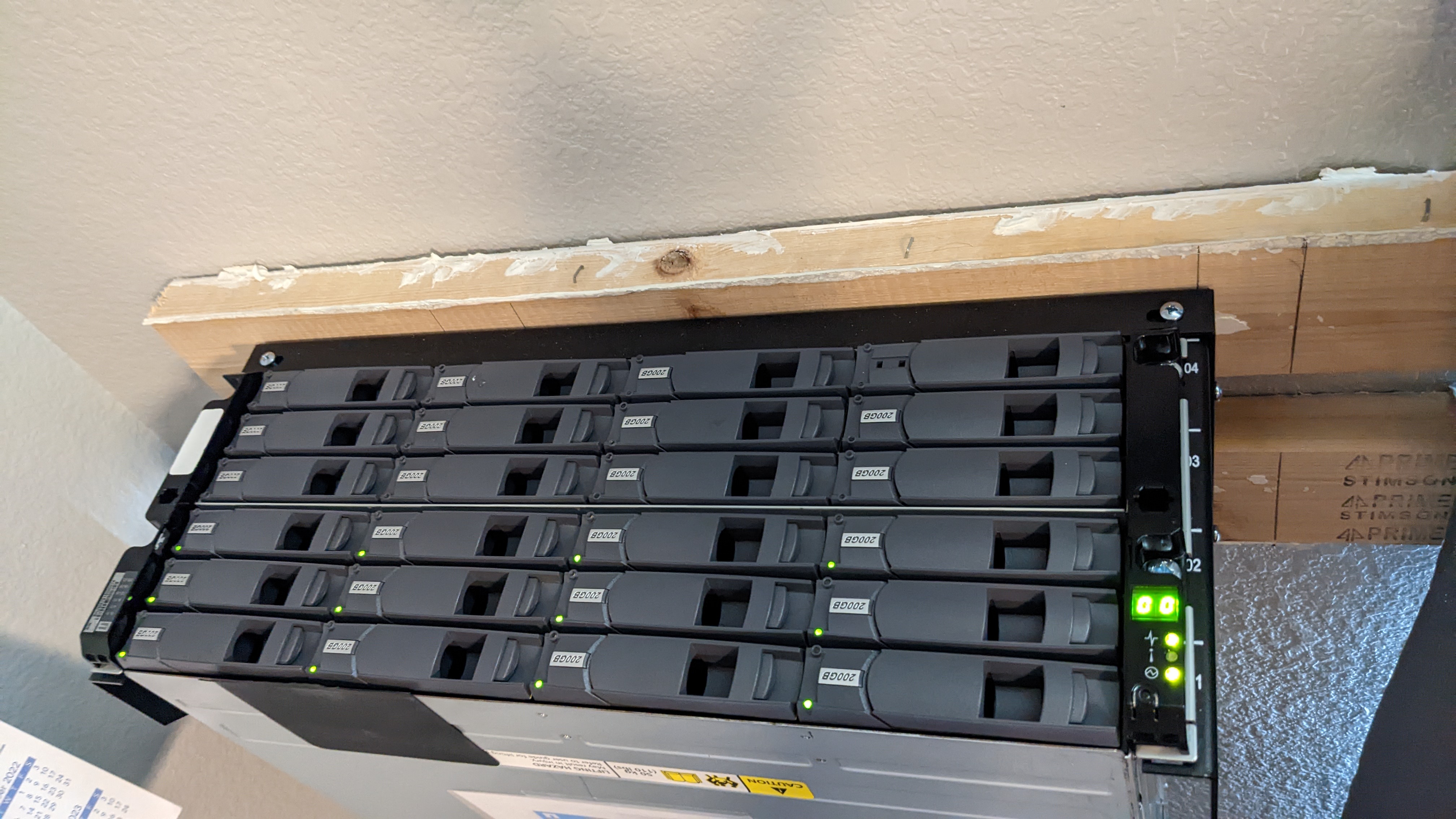

Shelf installed and I have 12 drives installed and 11 drives going to a SATA controller or mobo sata.

4 hours ago, Ctek said:
kernel: ata4.01: exception Emask 0x100 SAct 0x0 SErr 0x0 action 0x6 frozen.
Those are from the SATA port multiplier connected to disks 1, 2 and 12, that Marvell controller uses one for some of the ports, leave disk2 there for now and move disks 1 and 12 to the enclosure, ideally you'd replace that controller with a recommended non Marvell one, or just move all those drives to the enclosure, but performance might not be the best.
Oh Wow, the speed is much better now after moving those 2 drives that you suggested to the shelf!
