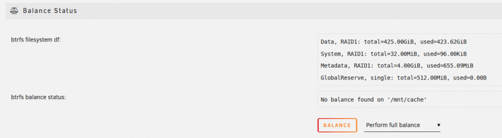

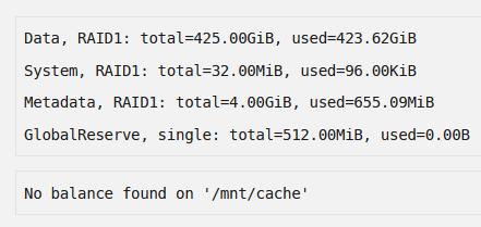

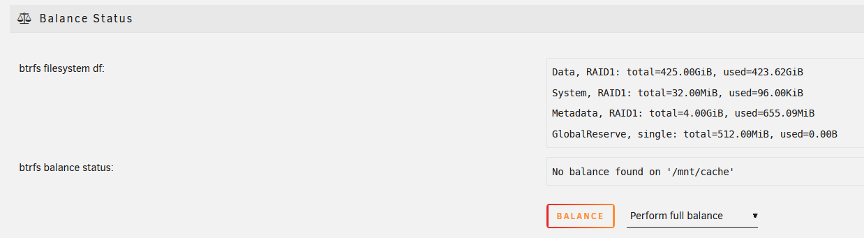

August 19, 20224 yr Author 1 hour ago, JorgeB said: try a different SATA port, also make sure you're using a different power cable Thanks for the suggestion, I have tried both now. Things such as smart info are still showing for now but my log is still filled with errors of the following two types (in the code box below (sdc is the new drive that has been giving me issues)) whenever I try to access a file that is stored on the cache. The file still opens and plays normally otherwise. Aug 19 11:23:06 Serverina kernel: BTRFS error (device sdb1): bad tree block start, want 1271081533440 have 0 Aug 19 11:23:06 Serverina kernel: BTRFS error (device sdb1): bad tree block start, want 1271081549824 have 0 Aug 19 11:23:12 Serverina kernel: BTRFS info (device sdb1): read error corrected: ino 0 off 1270182952960 (dev /dev/sdc1 sector 944117472) Aug 19 11:23:12 Serverina kernel: BTRFS info (device sdb1): read error corrected: ino 0 off 1270182957056 (dev /dev/sdc1 sector 944117480) So should I try to run another scrub to repair the errors? I have also noticed that it says "No balance found on '/mnt/cache'". Is that also an issue? Should I be performing another balance?

August 19, 20224 yr Author 1 hour ago, JorgeB said: Yes. Thanks, that seems to have worked! There were no uncorrectable errors and there were no I/O errors in the logs. There are also no errors in the logs when trying to open a file. Do I have to take any further steps regarding my cache pool or can I use it normally now? It still says "No balance found on '/mnt/cache'", is that an issue or is it supposed to be like that?
August 19, 20224 yr Community Expert 1 hour ago, obuwunkunubi said: is it supposed to be like that? This, unless a balance is running, pool is OK for now, recommend taking a look here for better pool monitoring.
August 19, 20224 yr Author 7 minutes ago, JorgeB said: unless a balance is running, pool is OK for now Since the "Balance" button isn't greyed out and I am not seeing any balance progress I'm assuming that it isn't running. Thanks for the help and suggestions! I'll take a look at the monitoring script.
