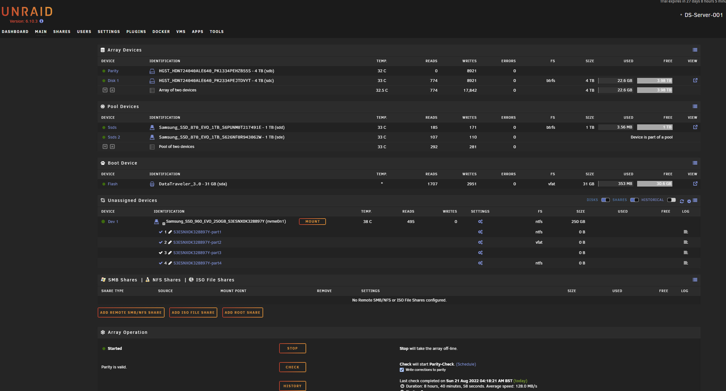

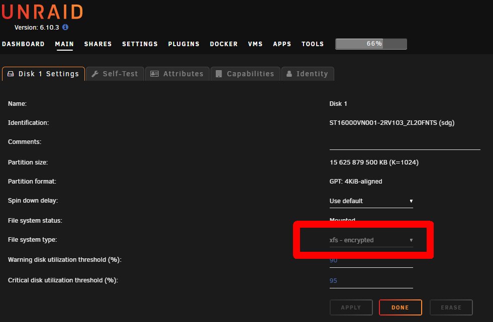

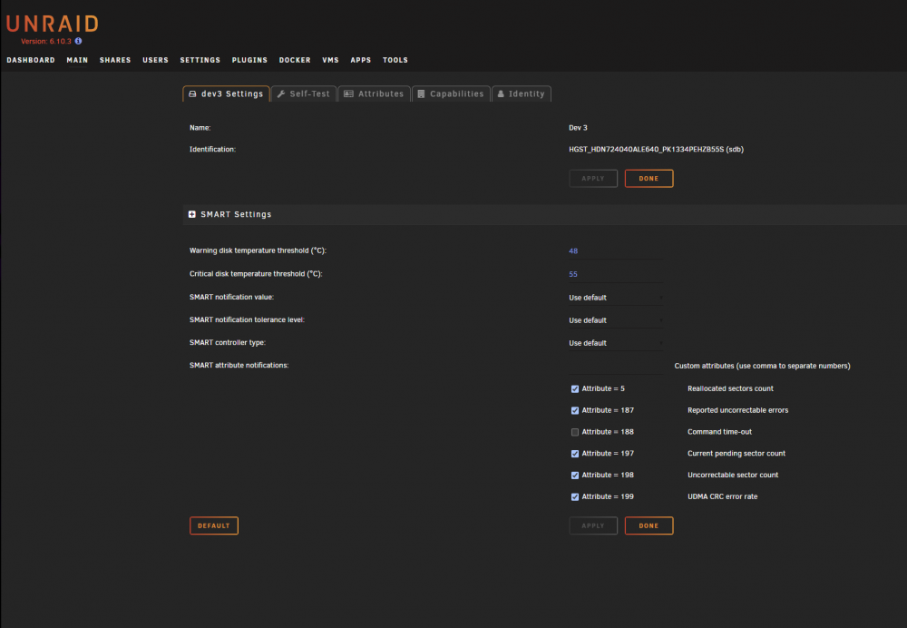

August 20, 20224 yr Author Thank you guys for all the replies! This community is really thriving. Yes, it is a new server. Formatting is not a problem. The source of the problem is that there is no File System option in our disks settings: Why would that be?
August 20, 20224 yr Community Expert Dev3 suggests it's still an unassigned device. Assign it to a slot in the array first, and go into its name that will now be Disk X. Edited August 20, 20224 yr by Kilrah
August 20, 20224 yr Community Expert Follow the instruction in the post above, then read and follow the instructions from the manual: https://wiki.unraid.net/Manual/Storage_Management#Changing_a_File_System_type

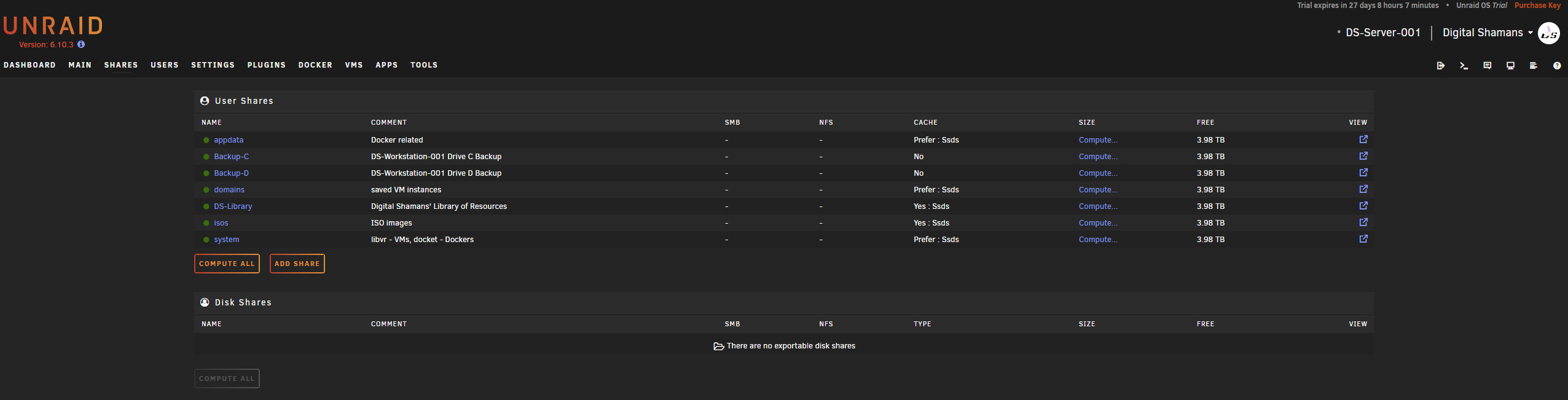

August 21, 20224 yr Author Thank you! It seems to be all good now. Could you take a quick look at the screenshots and tell me if there is no red flags to your knowledge? Btw, I changed system user shares to be preferably kept on SSDs. Because Id like to predominantly use SSDs for everything but Library of Source Files storage and other PC's HDD backups. Appreciate all the help got from you! Edited August 21, 20224 yr by Digital Shamans
August 21, 20224 yr Community Expert Diagnostics will tell us more than screenshots, attach to your NEXT post in this thread

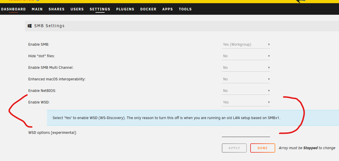

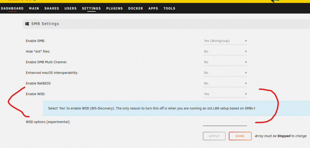

August 24, 20224 yr Community Expert Make sure this is turned on: If it still does not show up, download the PDF in the first post of this thread and read the section on " Fixing the Windows Explorer Issue". https://forums.unraid.net/topic/110580-security-is-not-a-dirty-word-unraid-windows-10-smb-setup/ OH, and be sure to set "Enable NetBIOS: to 'No' as the Windows' SMB client already has it turned off. (You only need if it you are using one of the 12-year old media players that need to access your server via SMB.)
August 24, 20224 yr Author Thanks, NetBIOS was "No" and Enable WSD was "yes" all this time. Yesterday I have enabled Windows features: SMB 1.0/CIFS File Sharing Support, SMB Direct and Services for NFS. It didn't help though. Thanks for the PDF, reading now. Already posted more detailed description of the challenge here:
