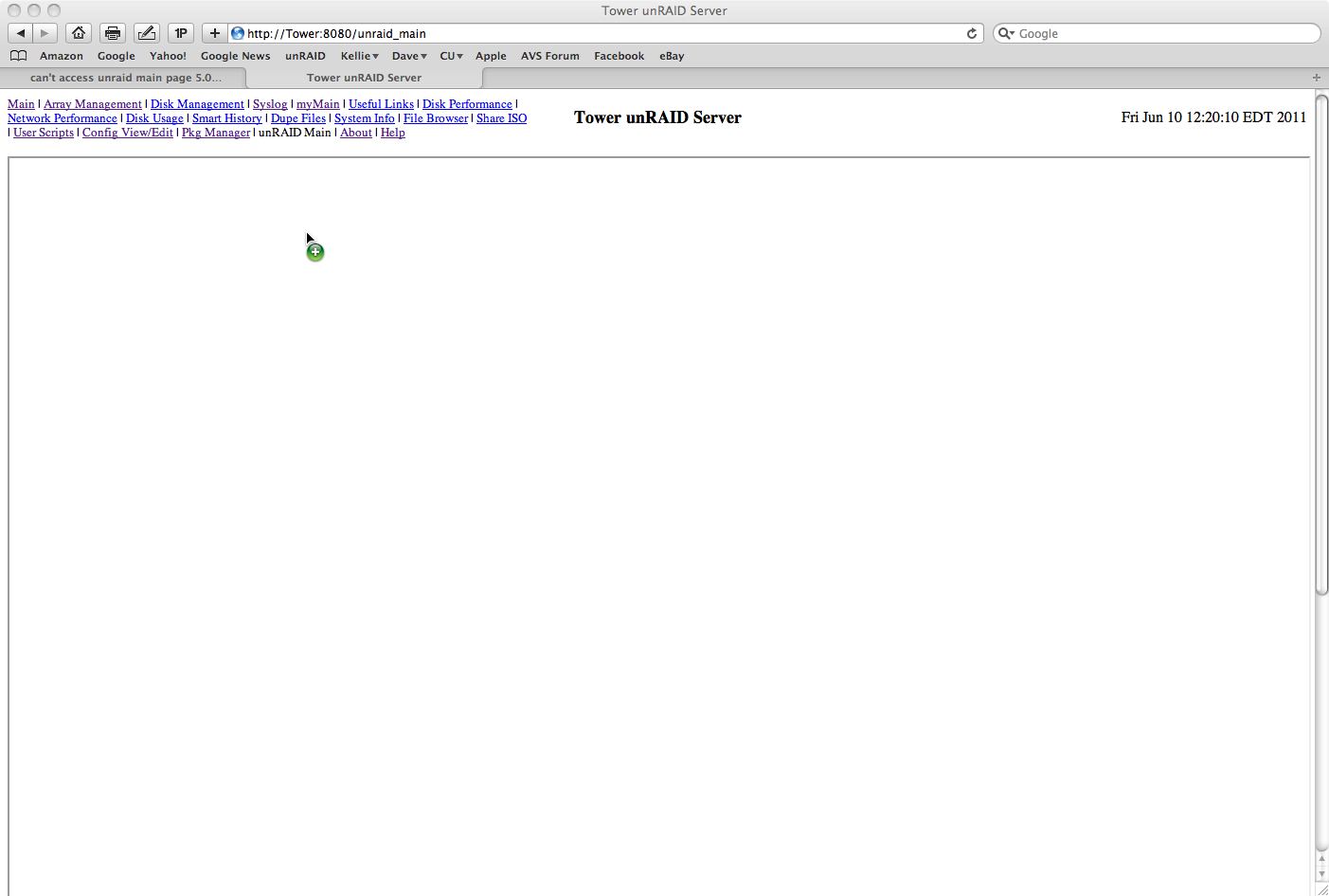

a little more info here, when I reboot and can access the main unraid page but once I shut the browser session down and I try and go back in, nothing.
Any idea?
Friday I'm going to unistall all unmenu plugins and install them one at a time and see if that fixes it
I think I found out something, as soon as the server boots up I can go to the main page using http://Tower:8080/unraid_main but if I click on another link in unmenu and try to go back and click on unRaid Main it doesn't work.  However if I type in my IP it works fine I just don't have access to unmenu.
Any idea?
Any idea?
you have more than once device with the same MAC address or IP address on your lan perhaps?
I don't think that's it, I can still access the server with http://Tower:8080/.  Its just when I click on the unmenu link that says unRAID Main I just get a blank white page but all the other links work fine
That page for me has always been sporadic.  My suggest... don't use it and just go to the main http://tower page.
Does not work for me either.  The new 5.0X does not work in an iframe.
So does this mean you will fix it  ;D
If possible, at some point.  It might not be possible with the 5.0 code.
