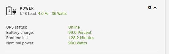

Just threw up my 1500 last night. Crazy amounts of reserve for my system. Not sure why I had to restart my APC Daemon just now since I restarted my machine last night, but I'll keep an eye on it.
Yes I'm fully aware this is while its idling. I think when it was all drives spinning doing 1 Transcode last night I saw it with 90Minute uptime. Still not going to believe that 100%, but its just amazing seeing some numbers like that.  I haven't loaded up my router on to it yet or my monitor, but taking steps. ;)

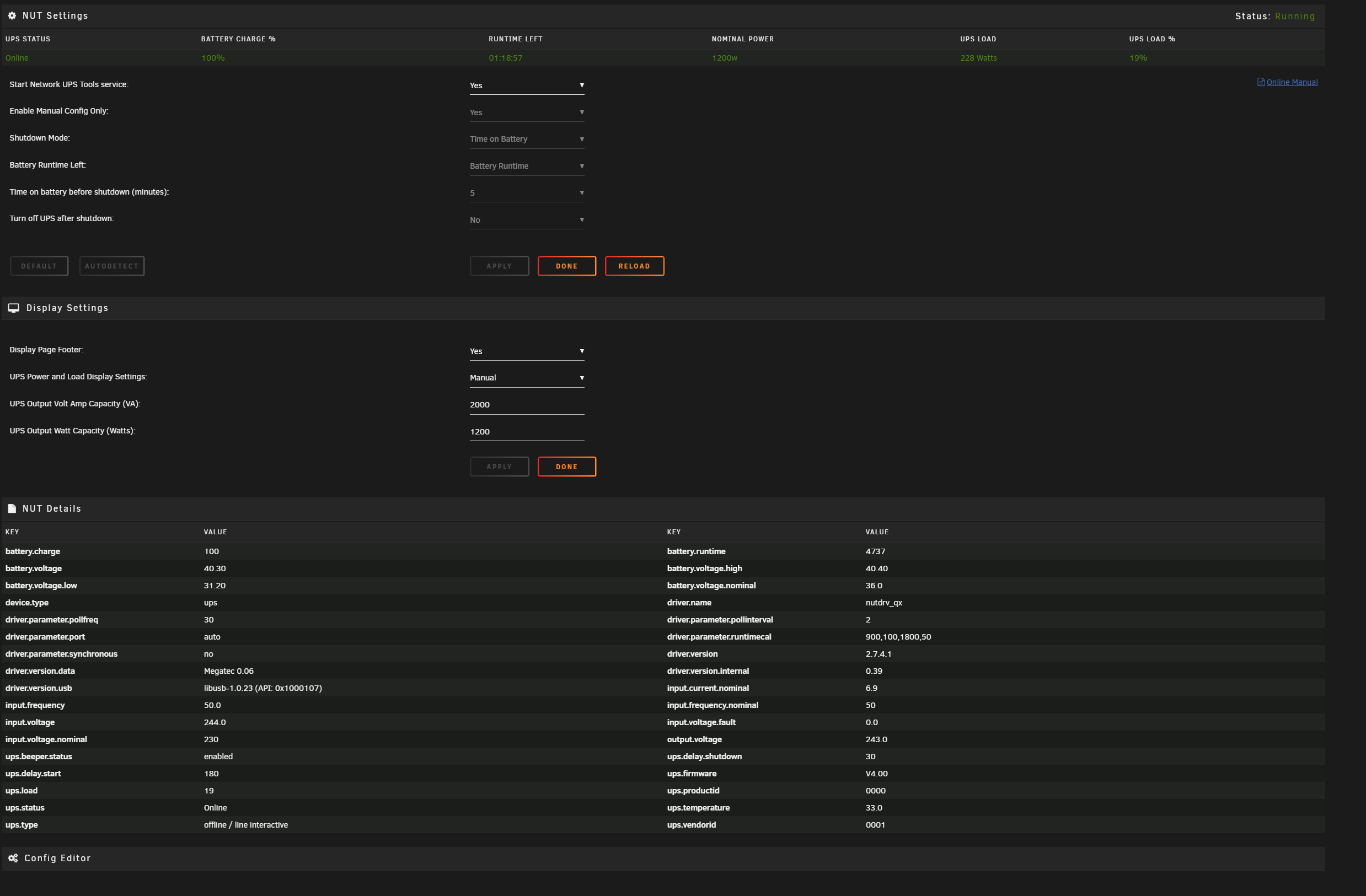

I use the following here in the UK. Powercool Smart UPS 2000VA 2 x UK Plug 4 x IEC RJ45 x 2 USB LCD Display for 3 servers works with NUT.
