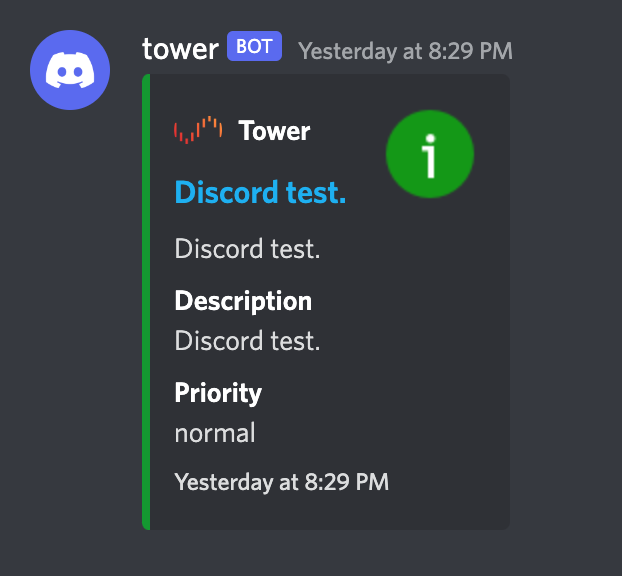

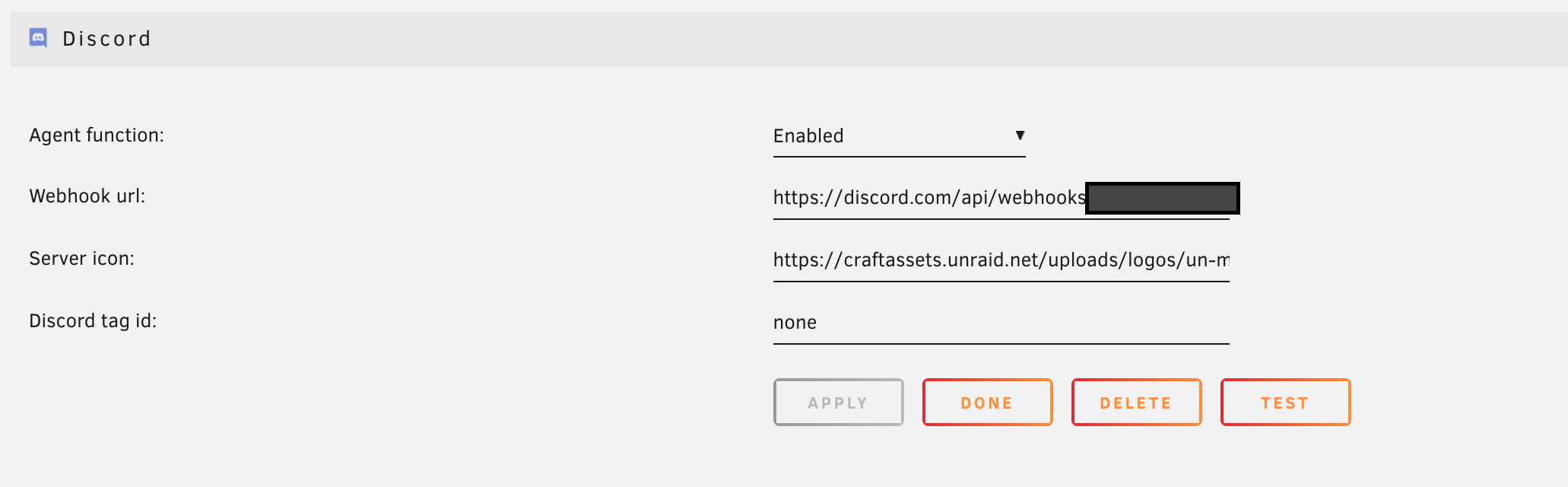

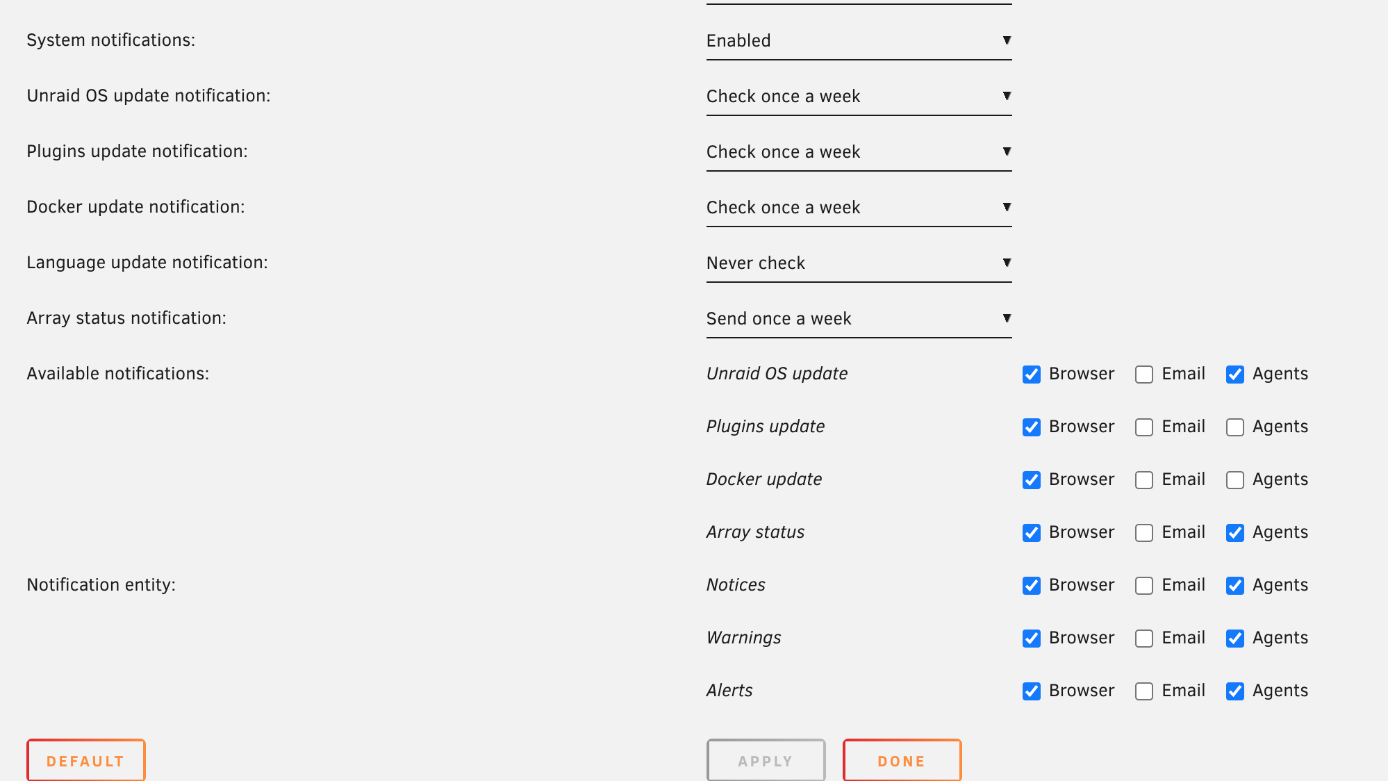

August 22, 20224 yr I'm setting up a discord server for my homelab and with unraid, I'm having some issues. And here's how I've set the Discord agent: Now, I can receive the test notifications just fine: But I'm not receiving any other notifications. I only see notifications in the unraid web ui. Even adding my tag id (the numbers) doesn't work. All I see in syslog is Aug 22 06:52:01 Tower Discord.sh: Failed sending notification Is there any way to turn up verbosity of Discord.sh or see why it failed? Edited August 22, 20224 yr by Howboys
