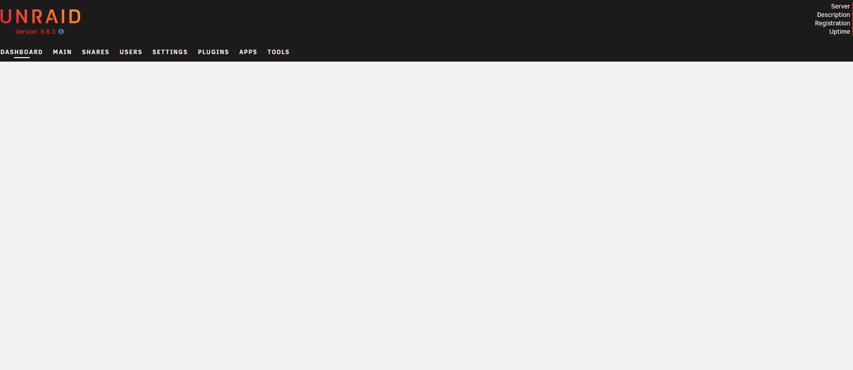

My unraid has defaultedt to a blank screen, i can only access the terminal to possible it shut down or reset.

After my last post, I had to head to work. Here where I left it as.
I removed the new USB, loaded the previous USB, downloaded the flash backup, used the USB creater via zip to write to the new usb, now both drives "should" be identical.
Before I did this I copied the entire contents of the drive at each phase.
I booted the server as I basically walked out the door. I've remoted back into my PC to via the broswer and now not sure If put the correct USB in as it says registration key in red, or did just writr over my old one? Did I lose/ delete my key? I assume it would recognize via uid if it was the right USB. I will have to check and make sure when I am home.
Drives seemed correct, other then the registration key and being unable to check anything else. However it may be the wrong USB anyways.
