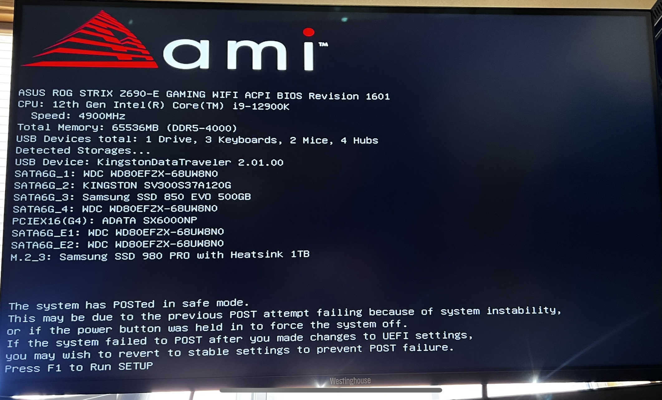

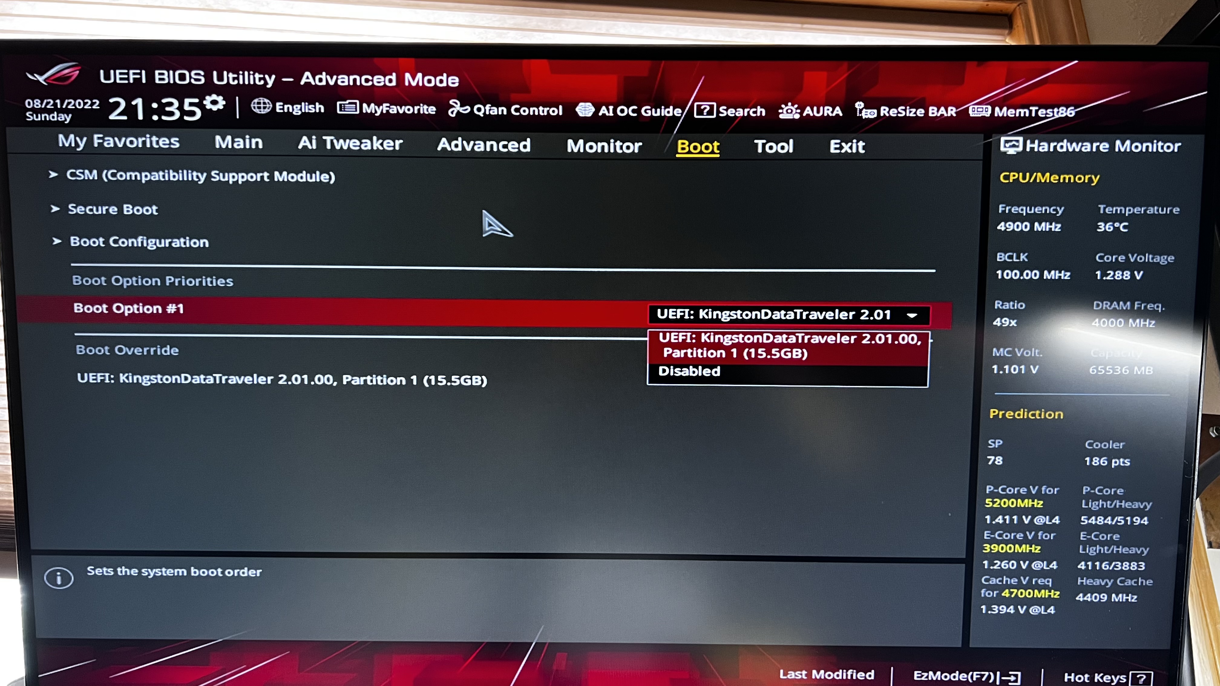

Hello. I am not sure why it takes so long after reboot to show the Bios on the screen (around 2-5min or so). Even though the USB is selected (also the only option), it still does not boot into Unraid startup script.
Seems the only way to boot into Unraid is to click the "override boot".
Any advice would be helpful. Thank you

This is a board issue, since it's posting in safe mode first thing to try is to reset the BIOS to defaults.
This was it, thank you. So simple.
On 8/24/2022 at 1:45 AM, ChatNoir said:
Try to disable Fast Boot
Man I seen that as well, but didn't work. Thanks for responding.
