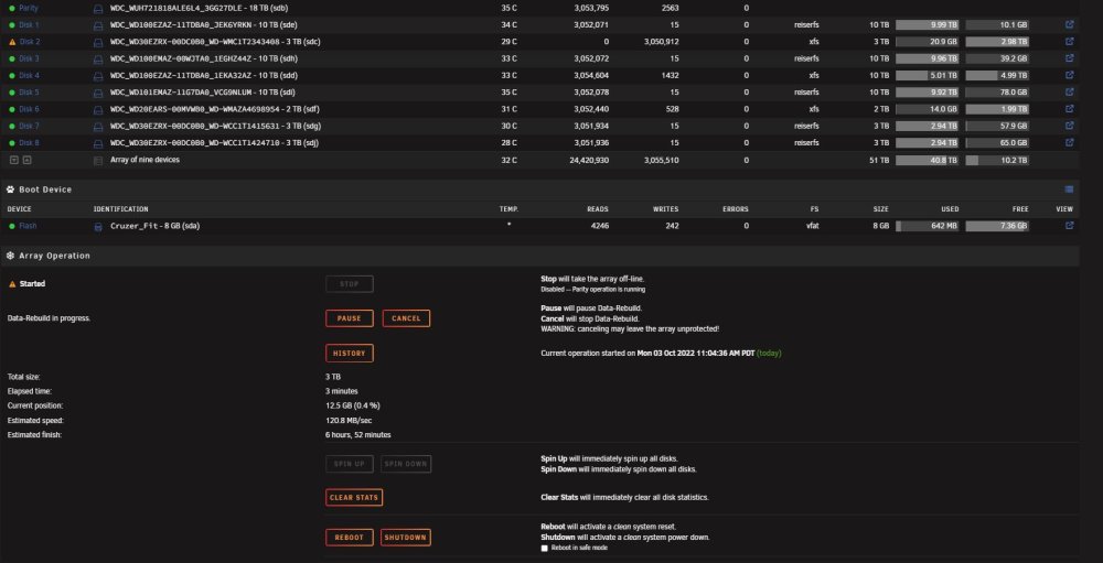

  • Now that everything is back up and running, the filesystems have been changed to xfs and my 10TB and 18TB disk have been added I would like to thank @JorgeB and @trurl for all your help!!! Much apprec
  • Did that and looking good now. Speed is at 120mb/sec (much better than the 1mb I had two days ago). After parity sync is done adding new disks and changing the file system.

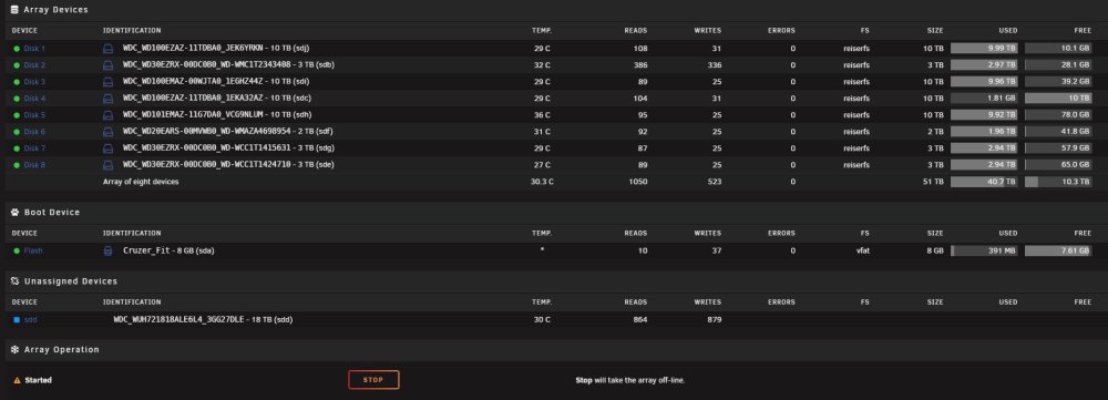

Did that. All disks, except for disk 4 that is still unassigned/undetected, are available.
toschestation-diagnostics-20220916-1424.zip

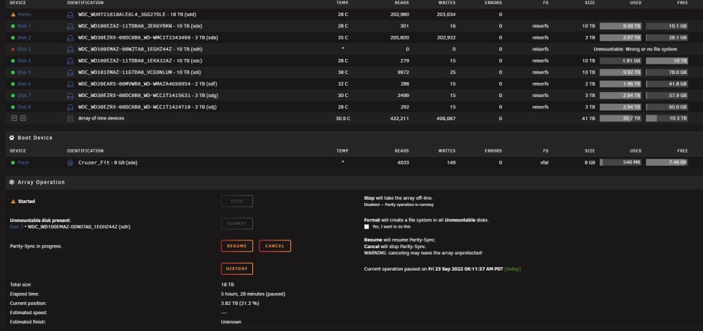

Disk1 isn't missing but it is unmountable. Emulated / missing disk4 is mounted but empty. All other disks are very full (not recommended).
Is it expected that disk4 is empty? Did you format it?

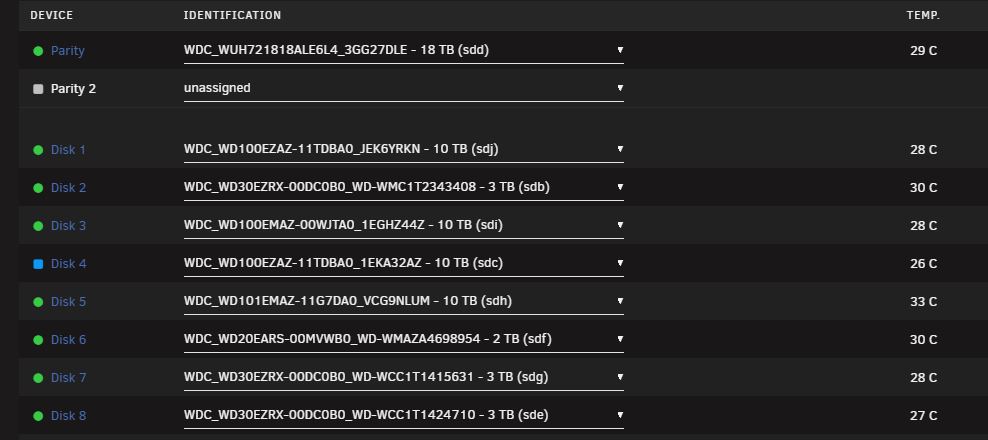

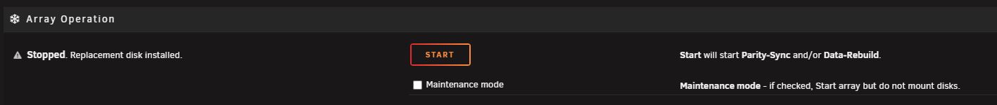

Ok so after replacing a lot of cables I can see all my disks again, even the disabled one. I haven't started the array as Unraid tells me that the disabled disk is a new device.
Do I continue by starting the array and putting the diagnostics here? Or should I do something else?
Post a screenshot and diagnostics without starting the array
That means it is going to begin rebuild when you start the array. Let's wait on that.

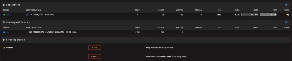

Set disk4 to not assigned, start the array, then post new diagnostics. And a screenshot of Main - Array Devices, be sure to include the full width
