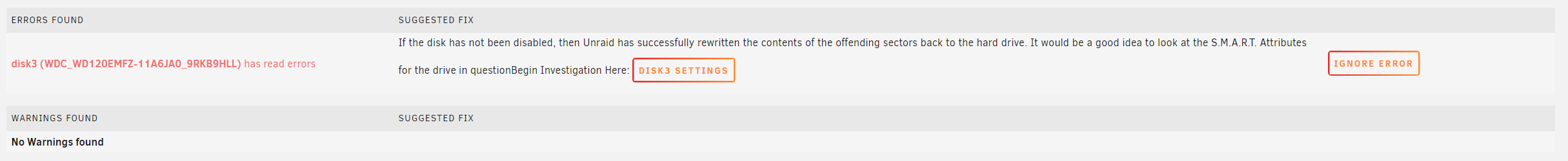

Would someone be able to tell me if my HDD is in need of being replaced or if this is something that can be fixed?  I think i caused this issue when i pulled a drive by mistake.  I've looked through the SMART test but i don't really know what i'm looking for - would be good to understand the issue and resolution.
I'm wondering if it's worth replacing the drive and then zero fill formatting this one.  I don't think it's a HW issue with the drive - i think it's my fault by removing the drive.  Doh.

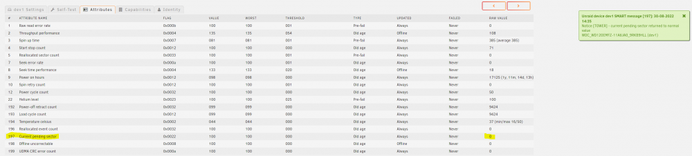

You can run a SMART test to confirm if they are a problem of not, if they are filling the drive with zeroes might remap them.
Hi JorgeB
I attached the SMART results in the previous message.  It looks to be passing the test i don't know if i'm missing something i should be reviewing and taking note of.

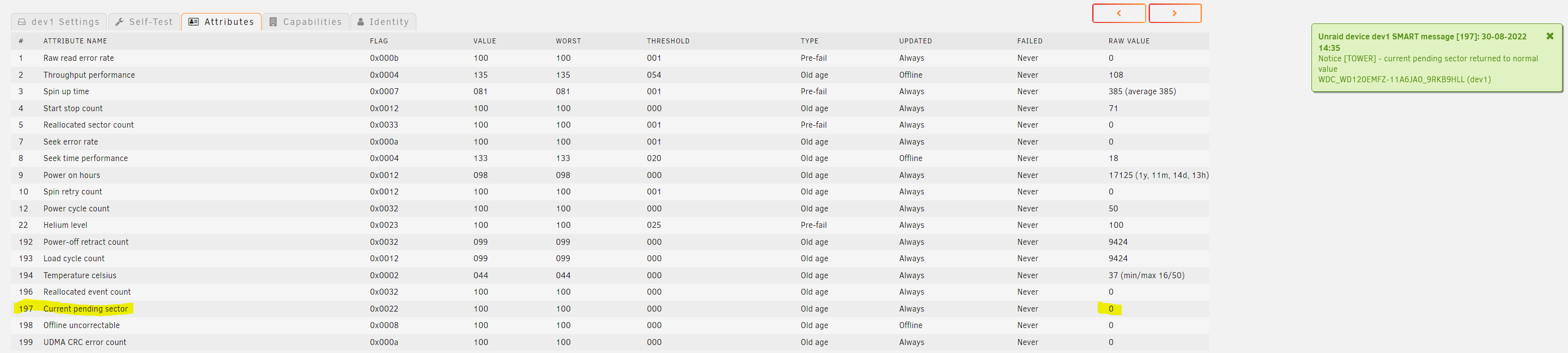

Forgot to specify, run the extended test, short one doesn't do a surface scan.
Make sure disk spin down is disabled before starting.
I thought i did an extended test but i must have hit the wrong button.  I've attached the extended test results.
tower-smart-20220825-1309.zip
Test failed, either replace the disk or try a full disk write to see it the sectors are remapped and don't come back again.

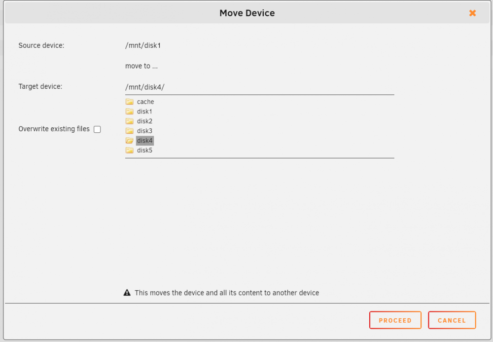

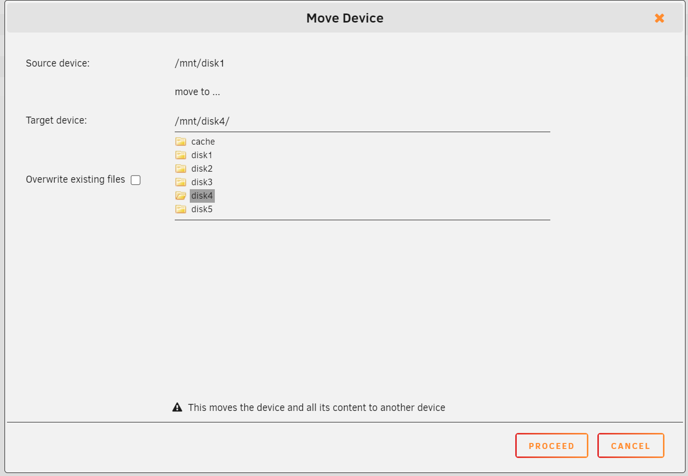

Since you are on Unraid 6.1.3 then installing the Dynamix File Manager plugin and using that is probably the easiest and least error prone way to do this.
The Dynamix file manager has an easy way built-in to move content from one disk to another disk (provided there is enough space on the destination disk)
1. Open the file manager from the top-right icon
2. Select the Move operation from the source disk (e.g. disk1)
3. Select the target disk to move to (e.g. disk4)
4. Select PROCEED and all content of disk1 will be moved to disk4 (existing files will not be overwritten unless explicitly selected)
5. You can follow the progress in the opened window or close it (X in top-right) and let it run in the background.

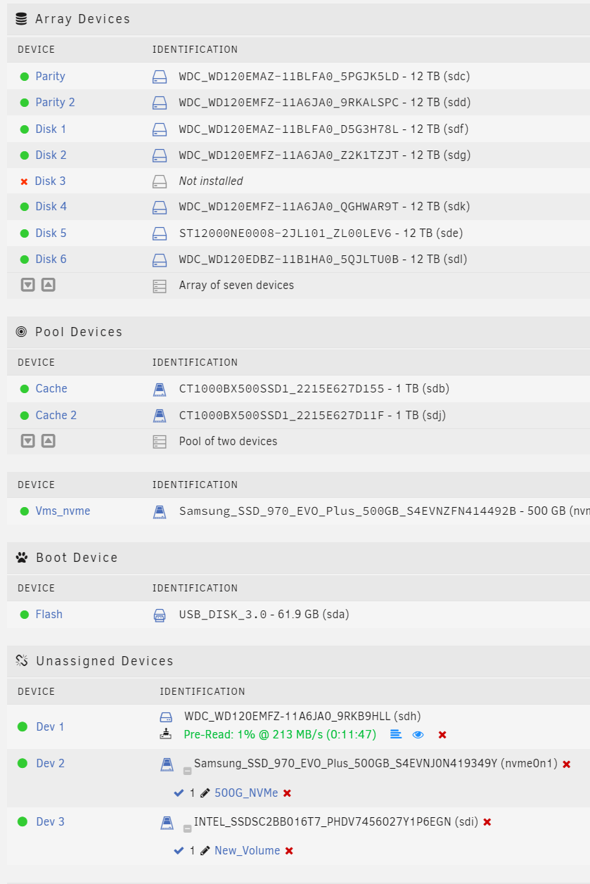

Well this has been a seamless process so far.
Interestingly, when i stopped the array to remove the offending disk i removed the partition and could pre-clear (or at least kick it off) without issue.  Something strange happening with MBR on the new drive that meant it couldn't be pre-cleared for whatever reason.
So now the long wait and hopefully no failures along the way with this older drive and it passes the test and i can re-introduce it to the array.  Failing that, maybe i need to see if i can RMA it but it's a shucked drive so no idea which serial number caddy it came out of.
I have this little green tick where Disk 3 used to be.  In the file manager i can delete the drive but will it re-order the remaining drives keeping them sequential?  It will annoy me if it doesn't.  I could wait to see if the drive passes pre-clear and reintroduce at Disk 3 i guess...

8 minutes ago, itimpi said:
At the moment Unraid should be emulating disk3 using the combination of the other disks plus parity to act as if it were still present.  If you replace the missing disk3 then Unraid will rebuild the contents of the 'emulated' disk3 on to this replacement.  If you try to do anything else this will invalidate parity (and parity will need to be rebuilt) and thus the contents of disk3 become irretrievably lost so be aware of this.
Ah ok.  So currently i have used file manager to move data to another drive.  I then stopped the array, removed the offending drive (disk 3) and restarted the array, so the data now exists on a new disk (disk 6).  In this scenario, what are my options without the array trying to rebuild from parity?
You can use the New Config tool to change the assignments to what you want  and then rebuild parity based on those assignments.
