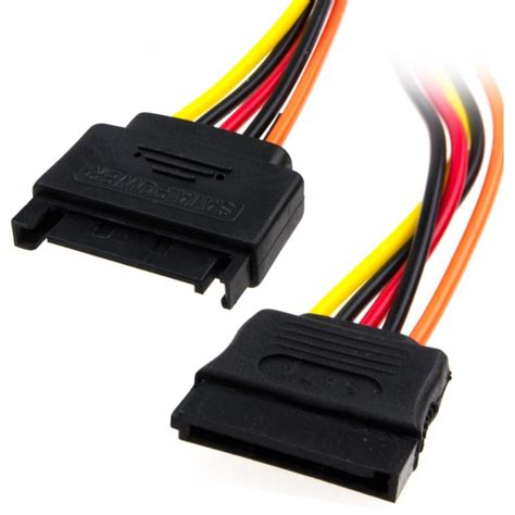

How are you splitting it?   You can split a single SATA connection into 2 but more than that is likely to cause problems.
If you have (or can borrow) a better power supply for testing purposes to see if it help it will be worth trying.
It's split 1 -> 2, 1 -> 3, 1 -> 3 (one sata connector broke). I think you're right, that it's a power issue; I'll look into getting a higher wattage psu with more sata connections. Ever since I set my parity check to monthly, my server hasn't crashed. I also just moved last weej to an older apartment and my server is temporarily plugged into the wall instead of my UPS. There's a solid chance that the power out of wall is dirty bc of older wiring and previously my server was just on the edge of stability on good power out of my UPS; but now with dirty power from the wall it's now no longer stable at full load/during parity.

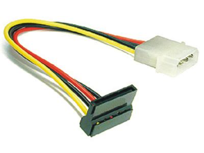

You can also use molex->sata connectors to get drives connected to the peripheral cable of your PSU. Really better to split molex than to split SATA.
I was reading that bad molex cables could short out and cause issues. Is it just about getting quality adapters?

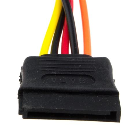

The SATA part of the adapters, not the 4 pin ends, are the real issue there, lots of high current with wires very close together. Molding errors or just tolerances over time with the manufacturing equipment can cause shorting issues leading to excessive heat and possible fire.
Less risk with a 4 pin to sata than there is with a SATA - SATA splitter, SATA connectors are just poor designs all around.
But yes, getting connectors from a manufacturer with good QC is key, being able to see each wire at the SATA end is a bonus. IDC vs molded.
Molded on both ends of a SATA splitter is just asking for trouble.
I'm not saying all molded cables are bad, it's just much easier to ignore or hide bad manufacturing.
I was aware of the potential fire issues with cheap molded power connectors so I made sure to buy high quality connectors that were post-mold clamp style so that shouldn't be an issue.
