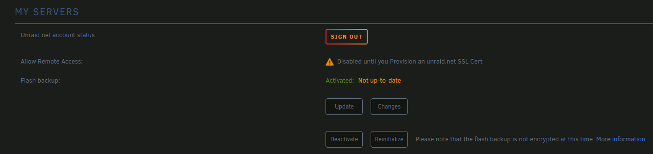

Flash Backup not starting
Hello Team!
report:

flash_backup script:
root@storageserver:~# /etc/rc.d/rc.flash_backup status
flash backup is enabled but the monitor is not running. system is signed in to Unraid.net.
restarting unraid-api does nothing:

Thank you for your reply,
I could have been more specific with my description, of course i already tried to restart that service:
root@storageserver:~# /etc/rc.d/rc.flash_backup start
flash backup monitor is running. system is signed in to Unraid.net.
sadly, this does not change anything, pressing update also does nothing.
