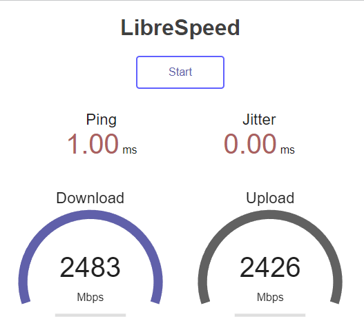

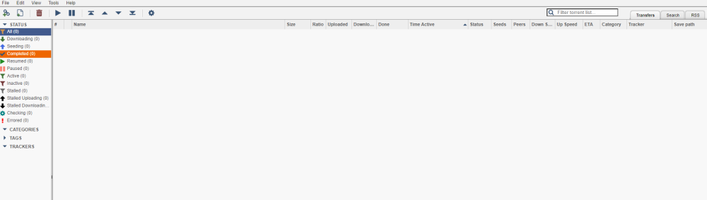

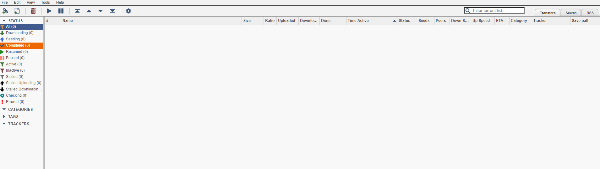

August 28, 20224 yr Hi All! So I recently upgraded from gigabit to 2gbit symmetrical with ATT. Everything seems to be fine, dashboard shows the 2.5gbe change and the speedtest app is showing i'm getting around 2400mbit up/down. For some reason when I'm downloading a file in qbittorrent it will show my speeds capped at 1gbit and I'll even stop seeing updates in the app on download progress as if the port is saturated. Any reason why the speedtest app will show 2.5gbit speeds available but behavior like this seems like it's still running on gbit? BGW320 connected to a TRENDnet 2.5 5port switch Thanks for any help! When I remove my 1gbit download cap in qbit, here's what I see in my dashboard Then my app becomes unresponsive due to "saturating" the gigabit speed I'm assuming? Qbit will update once transfer is done and show everything at 100% Edited September 7, 20224 yr by spark11

August 30, 20224 yr Author 18 minutes ago, Vr2Io said: Just double confirm, does speedtest was desktop (ethernet) to Internet server ? speedtest app in unraid and speedtest.net on the desktop. Not a speedtest between the two machines
August 30, 20224 yr Author 21 minutes ago, Vr2Io said: Just double confirm, does speedtest was desktop (ethernet) to Internet server ? Just updated my original post with screenshots of my connection displayed on the dashboard and the speedtest results!

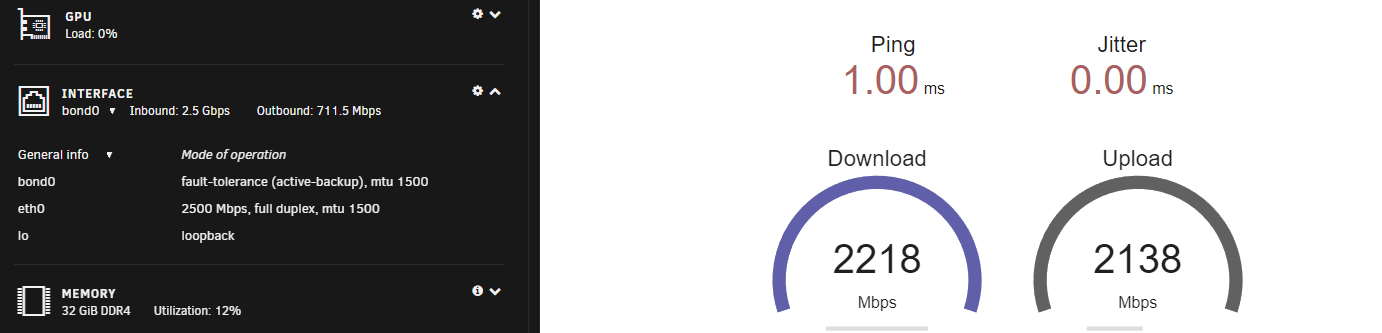

September 7, 20224 yr Author Does anyone here with above 1gbit internet have any issues like this? Honestly have zero idea of where to go from here...my other machines work fine, its just docker apps that seem to have some sort of cap that I cant remove Speed test run and dashboard showing that Im getting 2gbit speeds up and down Edited September 7, 20224 yr by spark11
