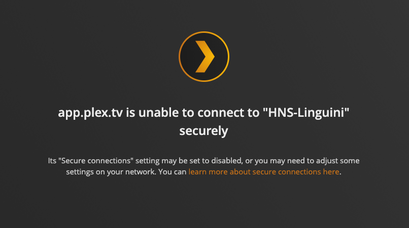

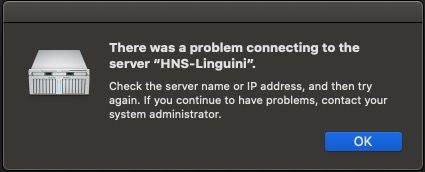

Wow... I feel really stupid right now. Neither of the shares was being exported to the internet. I fixed this and now I van see that my shares exist, but still cannot connect to any of them. I have attached screenshots of the error codes from Windows, Mac, and Plex if that helps. Nothing on the network itself has changed apart from the unRAID losing all of its settings and running off a fresh flash drive. Any idea what I should do next?
Instead of "internet" I assume you mean your LAN (local network). Don't put your server on the internet!
Forget about plex for now.
Have you tried accessing it using IP instead of name?
Yes I meant LAN. When I connect via the IP address as opposed to the name it does work. What is strange even after connecting successfully using the IP, it still doesn't let me connect via clicking on my unRAID in the network window.
Did you try the suggestion in the Windows error message?
Go to Credential Manager in Control Panel and delete any credentials for your Unraid server, both name and IP.
Try to access a Public share.
