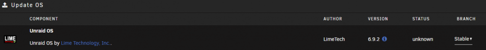

Removed the old ip-reservation, and adjusted the IP to the right on nic for new server,,  but are still not able to get internet access on new server:
- in upgrade OS i get Status=unknown:

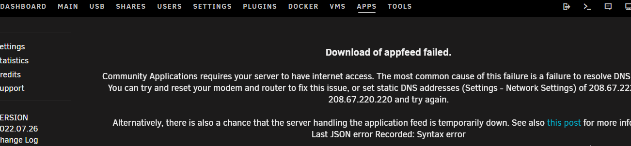

- and for apps I get this,,
Static DNS was previously set to 8.8.8.8, and even setting in the new entry had any impact

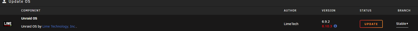

So I figured the DreamMachine was due for a restart, and ended up even upgrading firmware on it,,
but still no success.
