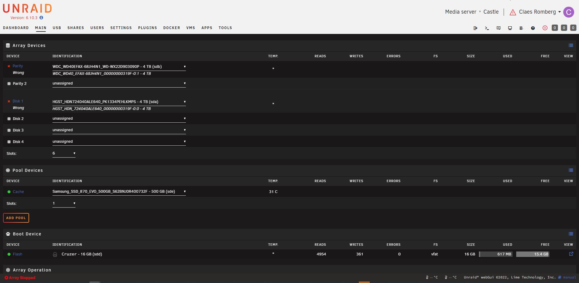

Unsure what happened here. The array refuses to start again after I updated Unraid from 6.9.4 to 6.10.3. I can see that my 2 disks suddenly has changed their identification so I can´t choose them and start the array. I then attempted to reflash the USB drive with my backup and the problem remains. So now nothing is working again. Any idea of how to solve this?
castle-syslog-20220828-0933.zip
You are using USB, that is not recommended for array/pool disks, one of the reasons is that device names can change, to fix it for now you need to do a new condif and check "parity is already valid" before array start.
