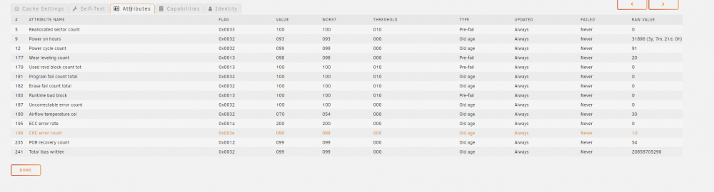

Look.... I am amazed I have used Unraid this long so far.  For what to me would be difficult/impossible I get great help here so thank you.
Saw the following issue with cache disk... should I be worried??
SysLog.zip
Solved by trurl
CRC errors are connection problems, the drive firmware has detected inconsistent data received (checksum). The data is resent in these cases so usually nothing to worry about.
Click on the SMART warning on the Dashboard page for that disk and you can acknowledge the current value, then it will warn again if it increases. If it does increase frequently you need to figure out why.

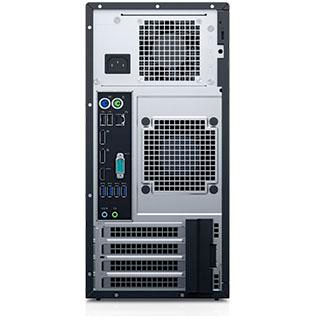

If it looks like this in the back, some tape might help a bunch.
Both fans should be blowing out, but all those holes below the fans in the slot covers (and any others) that allow air to get inside without going over the drives should be taped off.
Temporarily remove the front plastic, and make sure all the openings not directly beside a hard drive are taped off.
You want all the air that moves through the case to flow over the drives first, seal off anything that lets air in elsewhere.
