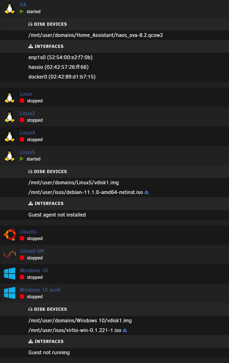

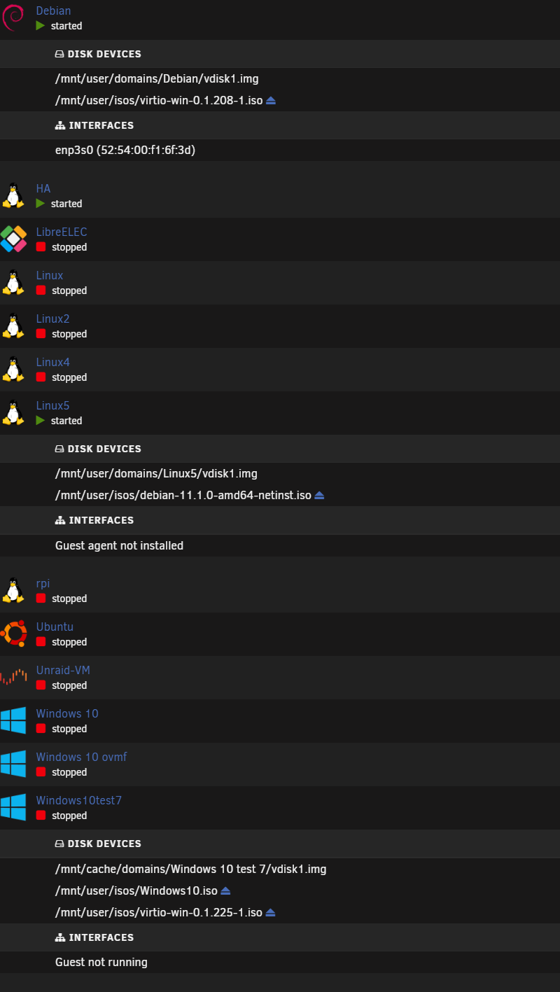

The PR to fix the error message has been merged so will be in the next release.
IP will now show following output
Guest not running
Guest agent no installed
IP addresses
