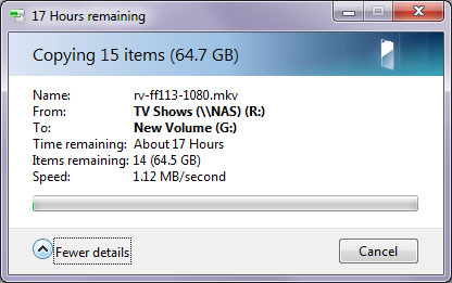

Yep it does include slow reading, however here is another one that does as well as a screenshot of the read speed

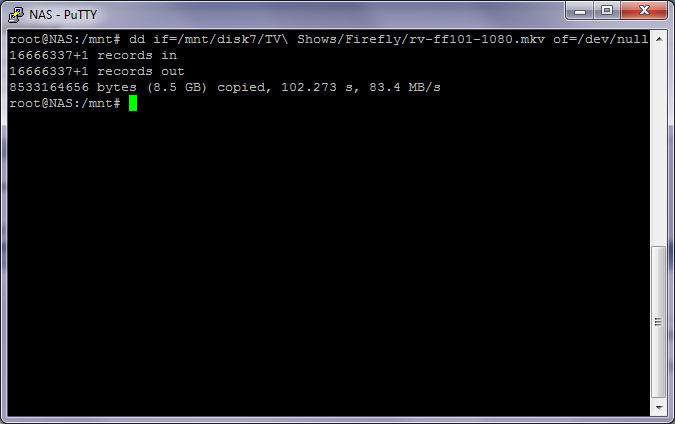

Here is a screenshot using the dd command
I don't know what this means but something is really wrong.
OK so I have discovered this is a Windows issue only.  I can use my Mac to transfer the files and they transfer at 48MB/Sec but ALL THREE of my windows machines AND my BPO transfer at only 1MB/sec
