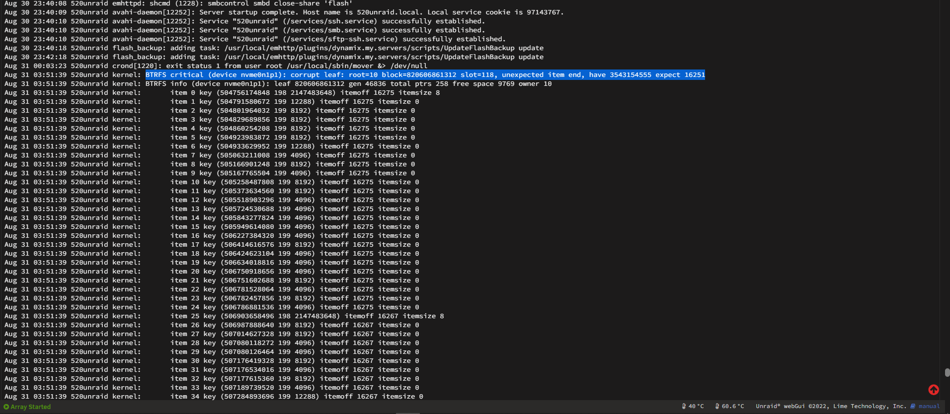

Aug 31 03:51:39 520unraid kernel: BTRFS critical (device nvme0n1p1): corrupt leaf: root=10 block=820606861312 slot=118, unexpected item end, have 3543154555 expect 16251
Aug 31 03:51:39 520unraid kernel: BTRFS info (device nvme0n1p1): leaf 820606861312 gen 46836 total ptrs 258 free space 9769 owner 10
Aug 31 03:51:39 520unraid kernel: BTRFS error (device nvme0n1p1): block=820606861312 write time tree block corruption detected
Aug 31 03:51:39 520unraid kernel: BTRFS: error (device nvme0n1p1) in btrfs_commit_transaction:2438: errno=-5 IO failure (Error while writing out transaction)
Aug 31 03:51:39 520unraid kernel: BTRFS info (device nvme0n1p1): forced readonly
Aug 31 03:51:39 520unraid kernel: BTRFS warning (device nvme0n1p1): Skipping commit of aborted transaction.
Aug 31 03:51:39 520unraid kernel: BTRFS: error (device nvme0n1p1) in cleanup_transaction:2011: errno=-5 IO failure

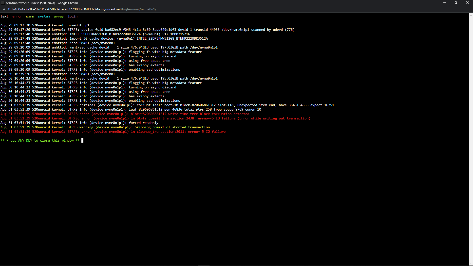

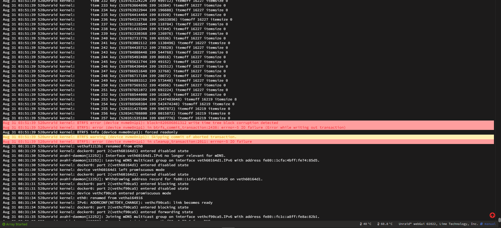

I also attached 3 screenshots (0 being the disk info, 1 & 2 being syslog relevant to this issue (a lot of item xxx key ... itemoff... errors)).

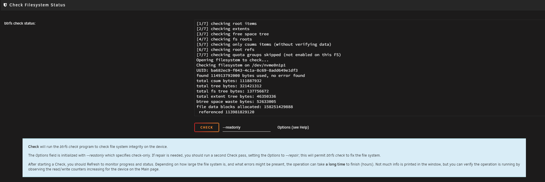

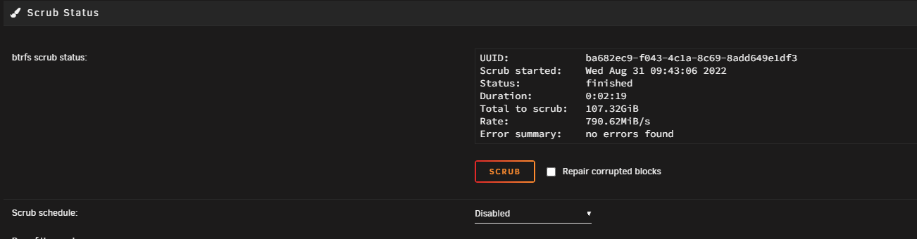

While researching this issue, I ran a Check-File System for this drive but it came back clean (picture 3) and a Scrub check which also came back clean (picture 4). check_filesys_btrfs_nvme_3.thumb.png.dbc8dcfe3c143b2f292e108406ef2f7b.png
I do believe something is wrong however, because I when I ran the mover, it came back with a Read-Only filesystem error on all files (they're mostly media files from qBit from last night so not much unrecoverable, I believe - though, I haven't checked for files that are kept on the cache pool...which are probably more vital...)
This usually means bad RAM or other kernel corruption, start by running memtest.

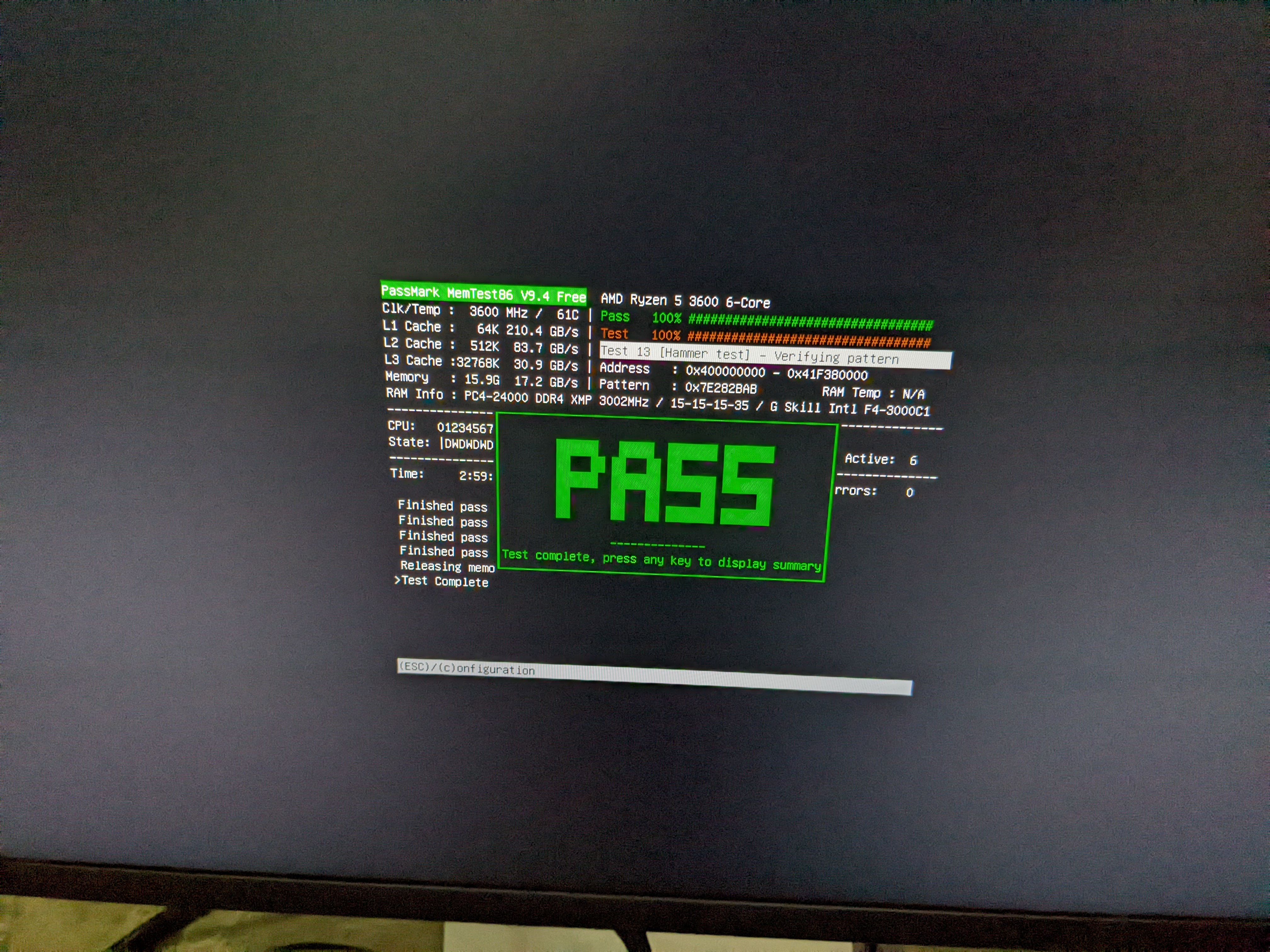

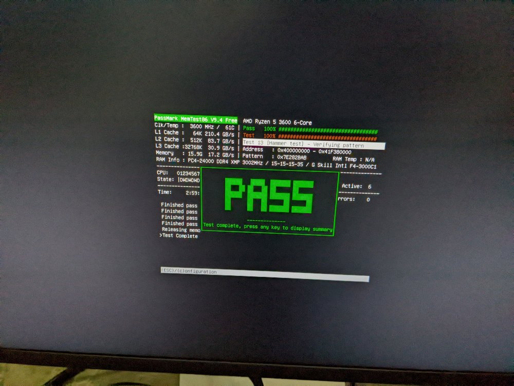

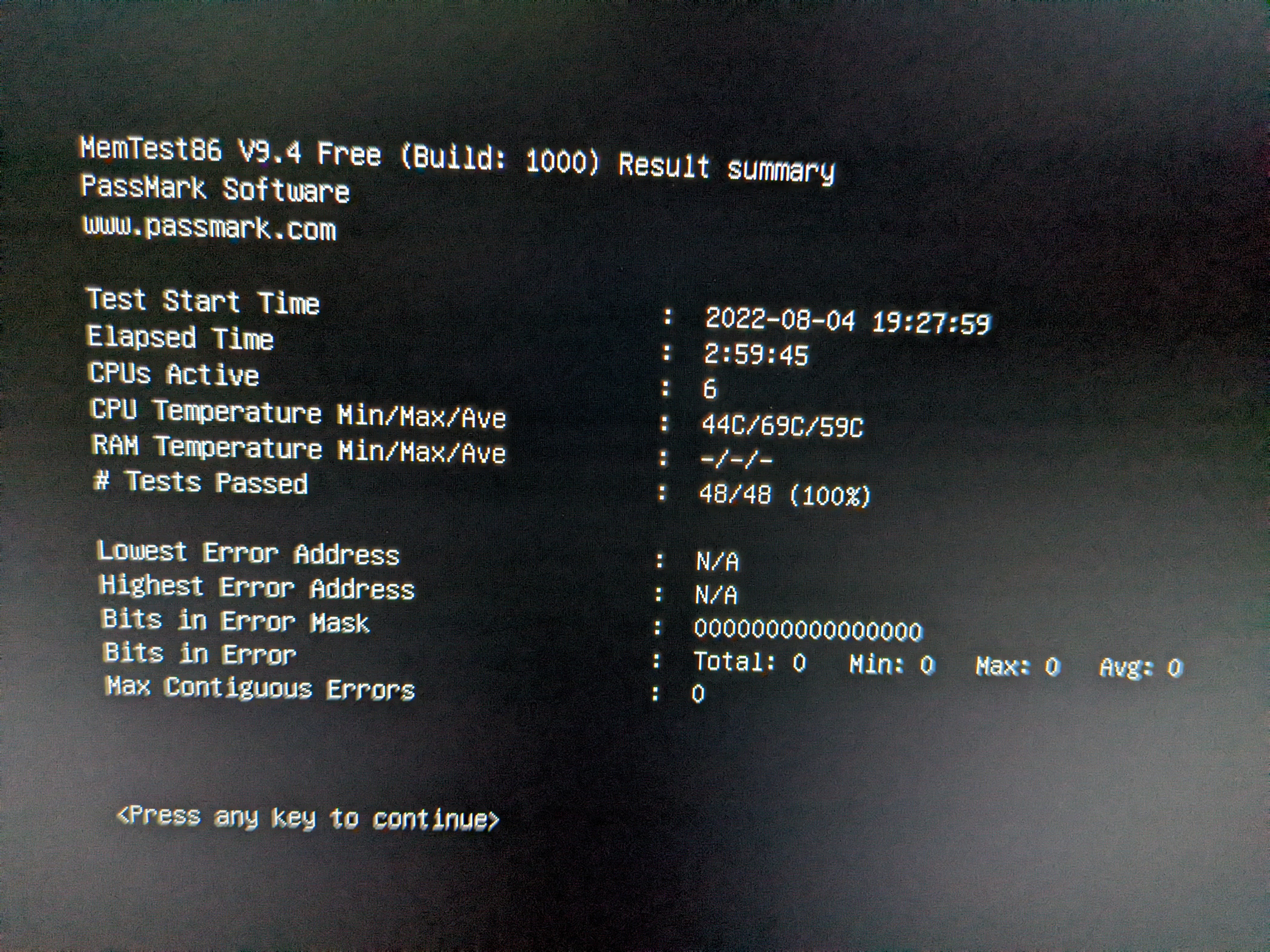

I haven't had a chance to run a test yet, unfortunately. But I did run a memtest on August 4th of this month and it passed (not 100% confident I ran the right test, though). I attached a photo of those tests.
PXL_20220804_230617811.thumb.jpg.87ce6b969f798f99b8f44032525219b8.jpgPXL_20220804_230624944.thumb.jpg.8b07a0155ba7d9ff856cc67d64cd262b.jpg
Edited by Shu
You should run another one, also a good idea to post the full diags to see if there are known hardware issues.
