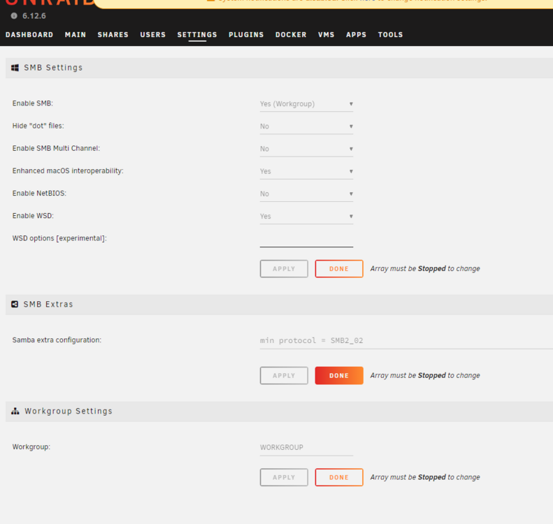

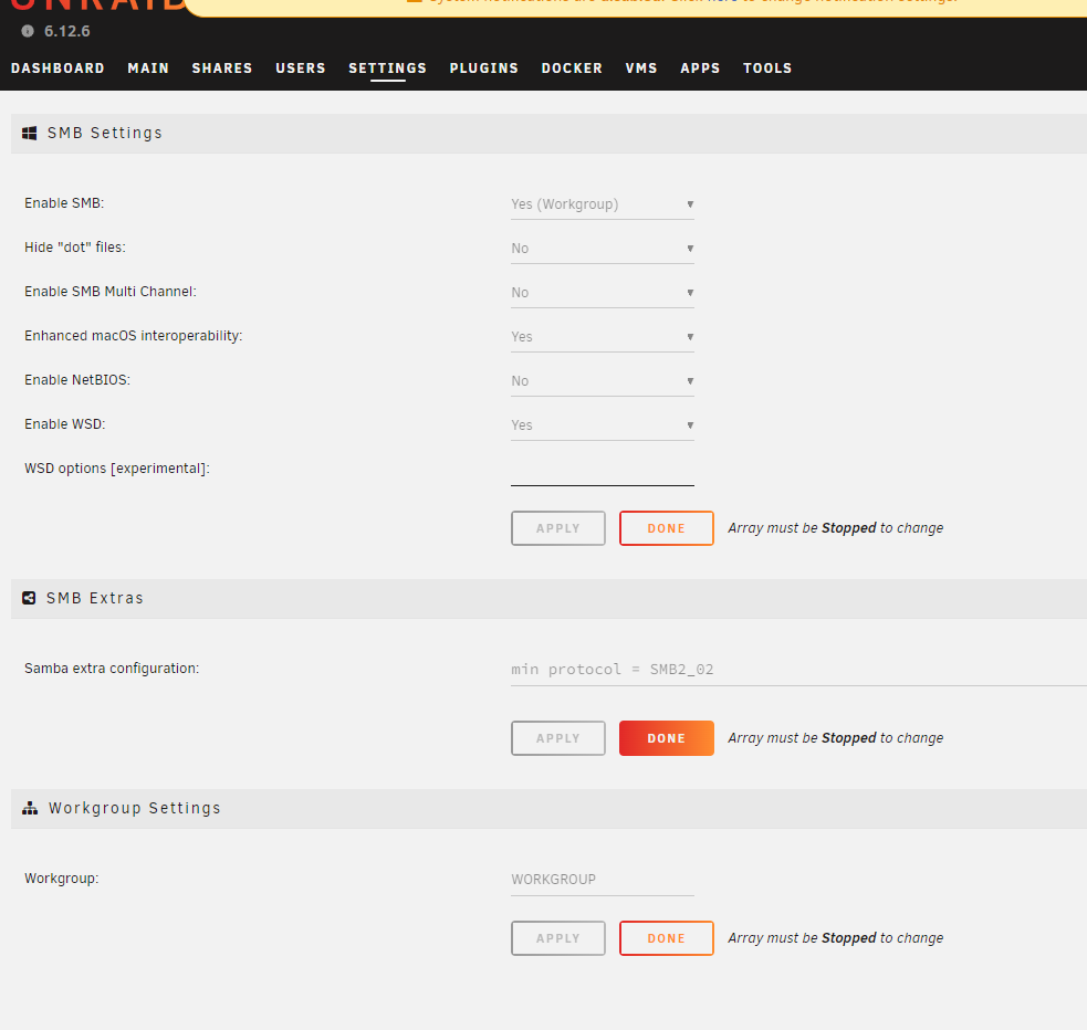

July 31, 20242 yr On 9/7/2022 at 6:55 PM, OrdinaryButt said: I found a single line config solution: "min protocol = SMBv2_02" This specifically enables 2.02 (I am going to assume that 2.002 is either a bug in the syslog print or something similar). "...=SMB2" or skipping the line forces minimum ver2.10 I have confirmed SMBv1 is down with a SMBv1 client. Thanks to those who tried to help, not to those that suggested buying a new printer or giving up on this. Sorry to revive a dead thread, but when I encountered the same issue on my brother ads-1500w and brave/google pointed me here. In case anyone else comes from google as well, it should be without the "v" in order to get the fix to work. "min protocol = SMB2_02"
November 24, 20241 yr On 7/31/2024 at 4:25 PM, Cydget said: Sorry to revive a dead thread, but when I encountered the same issue on my brother ads-1500w and brave/google pointed me here. In case anyone else comes from google as well, it should be without the "v" in order to get the fix to work. "min protocol = SMB2_02" Thank you! I have a Brother ADS-1500W and this also solved my problem.
