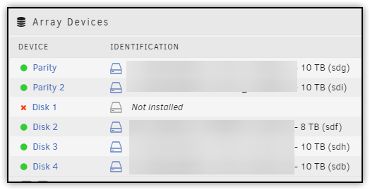

Hey trurl. I don't think it's mounted as it's showing as 'not installed' or am I missing something with that?
How would I transfer data off of it to other disks as currently I can only browse data via the share?
A disk can be emulated and mounted without being installed. That is the whole point of parity. The actual physical disk could be completely destroyed and still be emulated.
Since it's been a few days since those diagnostics, start the array, post new diagnostics and a screenshot of Main - Array Devices.
Ahh I see, thank you. I just came across an old post from you where you recommended copying the files to an unassigned drive to avoid further writing to the array. I don't have enough space to do that but am tempted to delete unimportant stuff from the emulated drive and then copy the bits I want to keep to the unassigned drive. Then copy it back after doing a new config/parity resync. Does this sound like the best option for my case?
