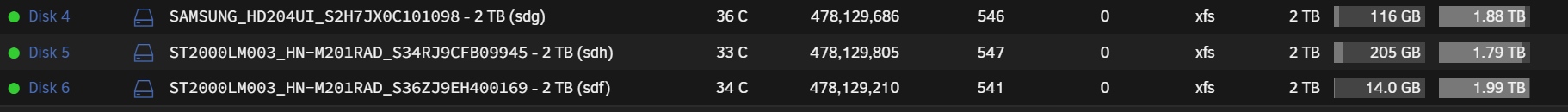

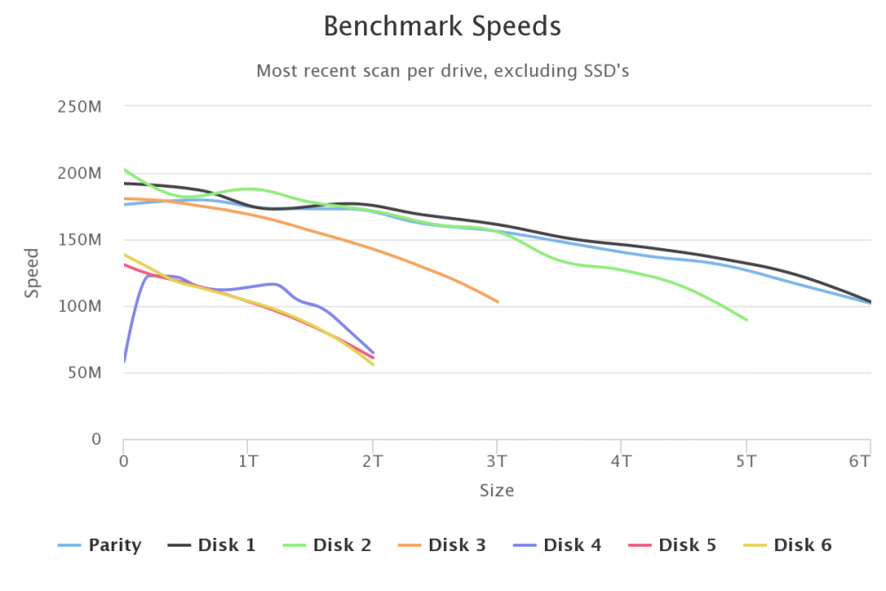

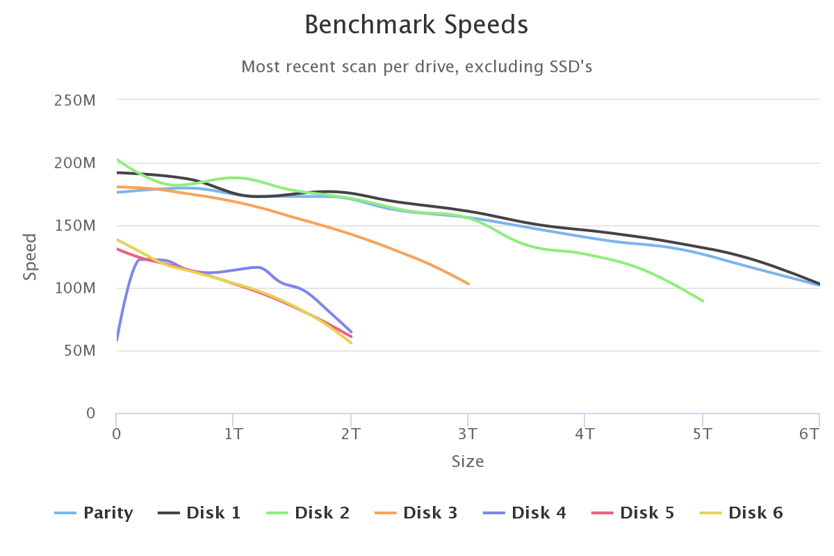

I know I don’t have the fastest drives, especially the lower size drives. Diskspeed shows disk 4,5,6 are very slow when full but the have very little data on them.

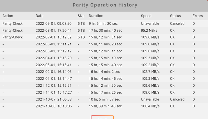

Last month I noticed it took longer.
This month it is hovering around 65MB/sec.

At what position is the check? Disk 4 is showing one or more slow zones in the beginning.
Thank you for th reply. It is at 38.8% and now running at 135.6MB/sec.
Is it likely to be that drive? Any idea on why it would start slow and can it be fixed? Or should I remove/replace it?
