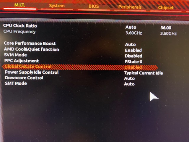

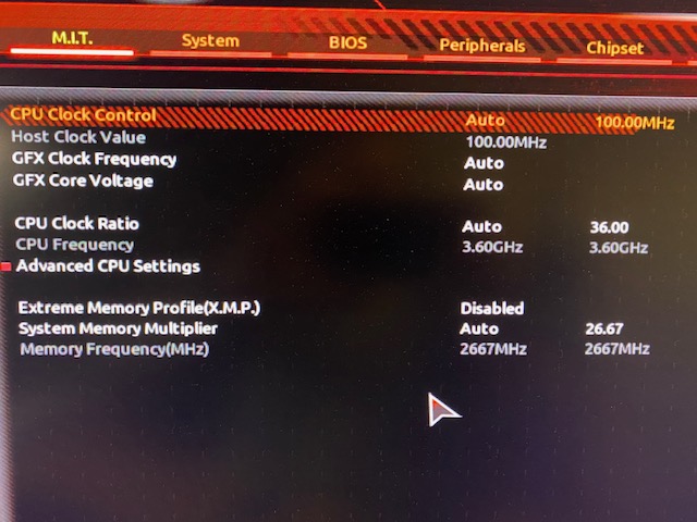

Thank you so much for pointing out this thread. I just updated my BIOS and followed the instructions. So far so good, hopefully that will fix the issue...
Unfortunately, my system continues to crash on a fortnightly basis. My Unraid is locked up and the only solution to access it again is a hardware reset. I think I followed all instructions and changed the right parameters in the BIOS.
I also add in the \tower\flash\config\go file the following line:
/usr/local/sbin/zenstates --c6-disable
No success… I will try to update Unraid from 6.11.0 -> 6.11.1.
I would be extremely grateful for any idea or suggestion that could solve this issue. This is annoying and if I can’t find a solution soon, I’m afraid I will have to end my little advanture with Unraid and sell my machine!
