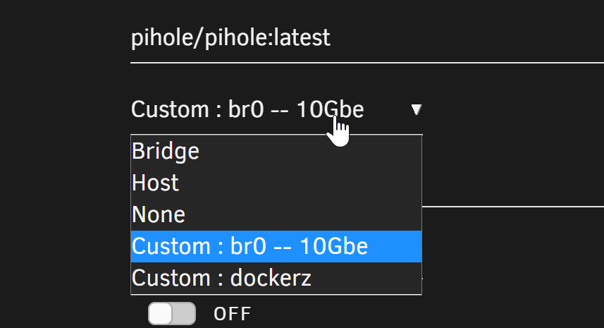

I have tried going the VLAN route but following all the guides am not getting the same results as expected. I added a VLAN to the network config for docker use. But that VLAN is not shown in the container settings. Just the default br0.

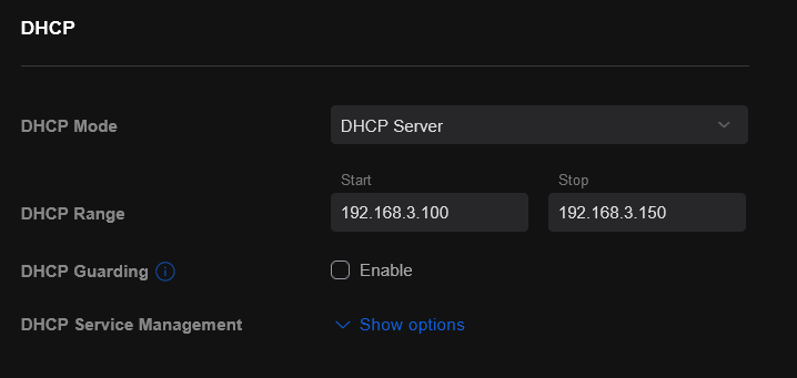

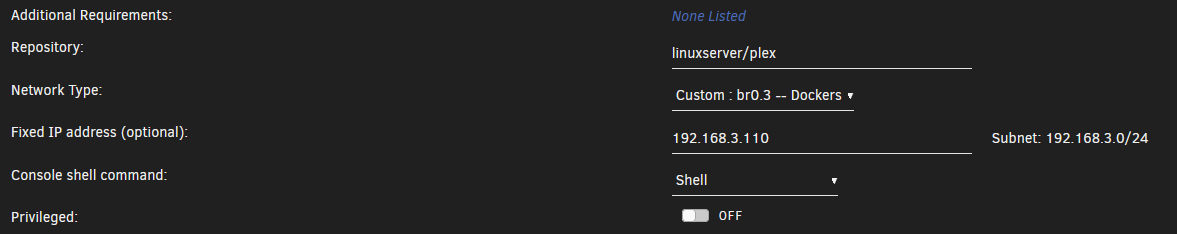

@aglyons As mentioned above by @Vr2Io, DHCP for docker and DHCP on your router cannot compete in the range of IP addresses they are allowed to assign.  Docker does not know anything about your router DHCP.  I assign the Docker VLAN in the USG a DHCP Range of 192.168.3.100 to 192.168.3.150.  However, I do NOT enable DHCP on the docker VLAN in unRAID and manually assign addresses in this range.

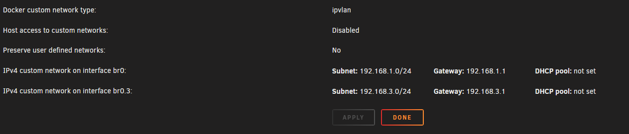

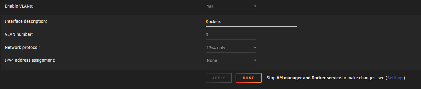

On the VLAN side in unRAID, I do not enable DHCP on the br0.3 interface
Settings --> Network
Settings --> Docker

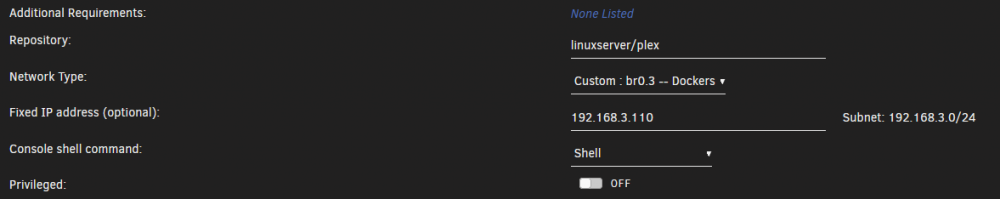

For each docker container to which I want to assign a static IP address, I specify the IP addresses beginning with 192.168.3.100
Here is my Plex container (192.168.3.110) for example:
I am not sure how this differs from what you are doing but I do not run into the issues you describe.
