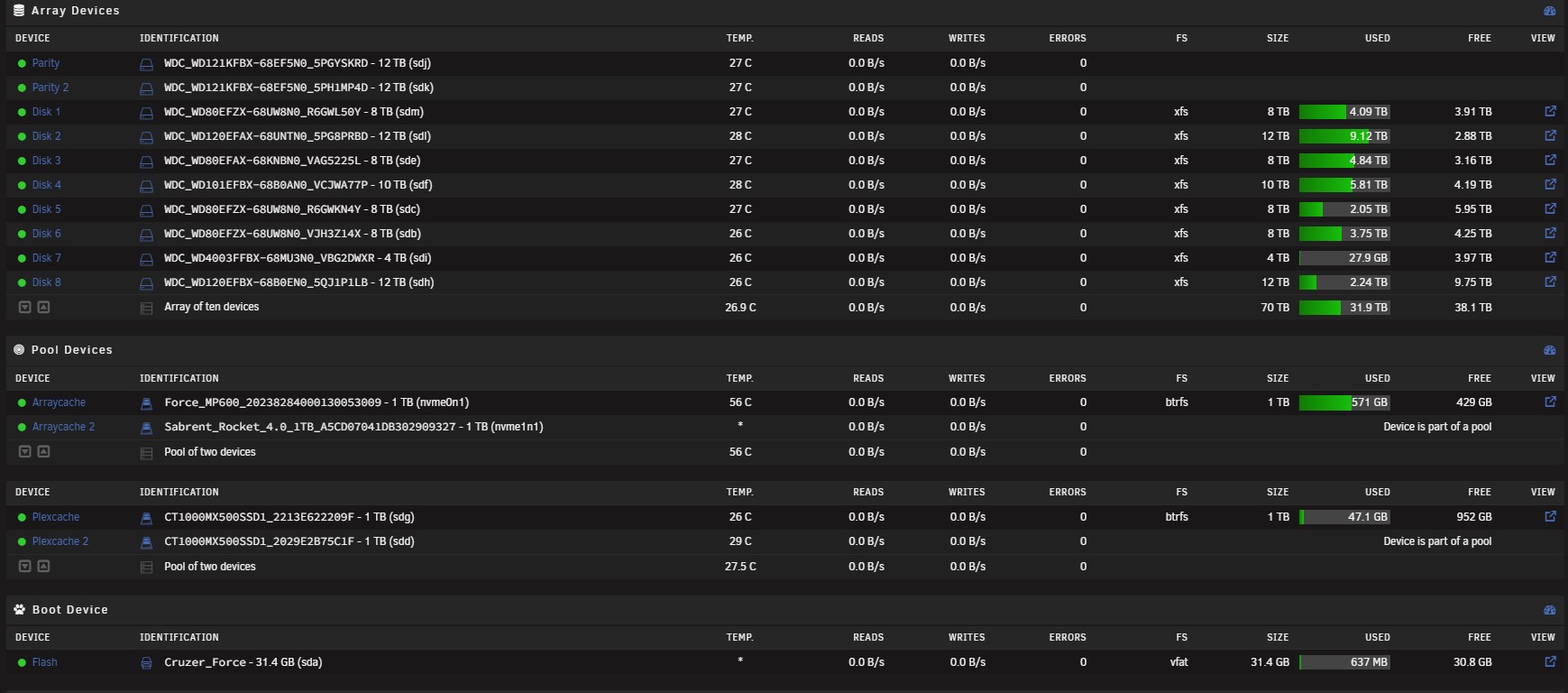

When I got home and logged in, I found that the Disk in question, Disk nvme0n1, was still shown on the Main tab and I was able to view it by clicking on the Arraycache link. I've had nvme disks drop offline before, but they were gone from the Main tab. Why was unRAID saying it was offline, but still visible?
My Plex docker was still working perfectly fine, which I assume is because the other disk in the cachepool never dropped offline.
I did some googling and read that I shouldn't be using TRIM on nvme devices especially if they are in a btrfs pool. That's the first I ever heard of that. So I will turn off TRIM on my server.
I haven't had time to turn my unRAID server back on and see if there's any other problems. I just wanted to post here and get some feedback as to why it happened, how I can keep it from happening again, and what steps should I take before rebooting to make sure no data is lost?
Attached is my Diagnostic file and a screenshot from after getting the Diagnostic file and before shutting my server down.

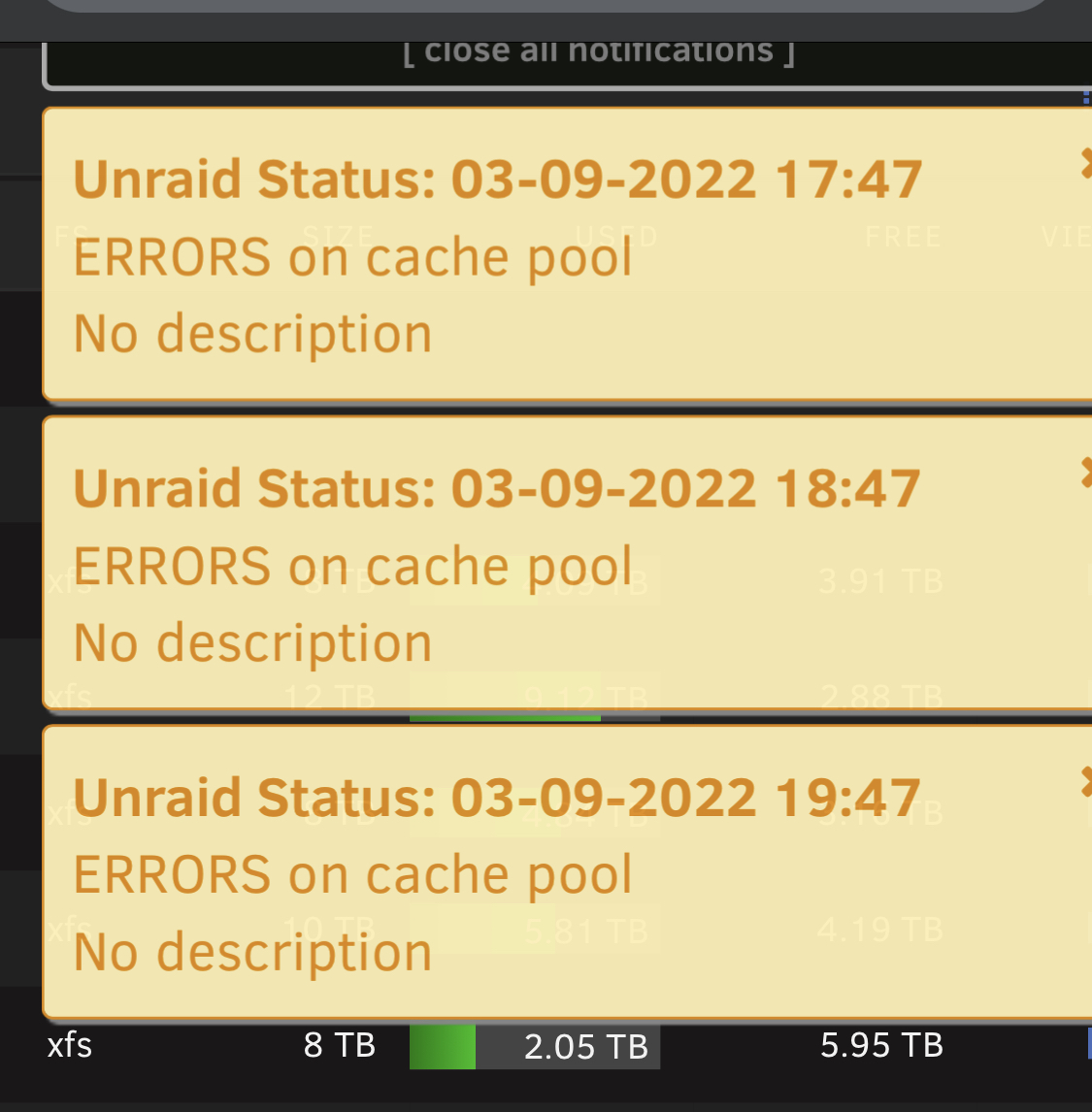

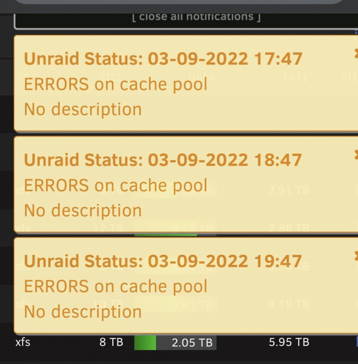

I thought everything was good until a couple hours ago. Every hour at exactly the 47th min of the hour, I get an email stating:
unraid status: errors on cache pool
Event: Unraid Status
Subject: ERRORS on cache pool
Description: No description
Importance: warning
It doesn't tell me what cache pool has the errors and I'm not seeing any errors on either cache pool.
I've ran another scrub on each cache pool and there are no errors.
I looked in my logs and there's no mention of cache pool errors except the system sending out an email.
What is going on here?
threadripper19-syslog-20220904-0003.zip
I found the cause of the Errors on Cache Pool.
I forgot I made a user script to run a btrfs check hourly and that after an error is seen, it will continue to notify you of the error every time it runs, which for me is every hour.
I had to force reset the stats on the cache pool to stop the error. I just assumed the stats would reset after correcting the errors.

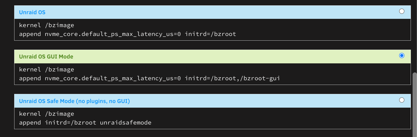

@JorgeB
I already had that line in my boot folder, but I think I messed up the position of it.
Which is probably why is wasn't working.
32418377_ScreenShot2022-09-04at2_49_00PM.thumb.png.15a18f5f9599aa7bbcfdd99d28fe7bf1.png
Can you please correct my boot folder settings.
I have it under Unraid OS and Unraid OS GUI MODE.
Thanks
That's correct it can be in the middle or the end of the line, as long as it's after append is fine.
