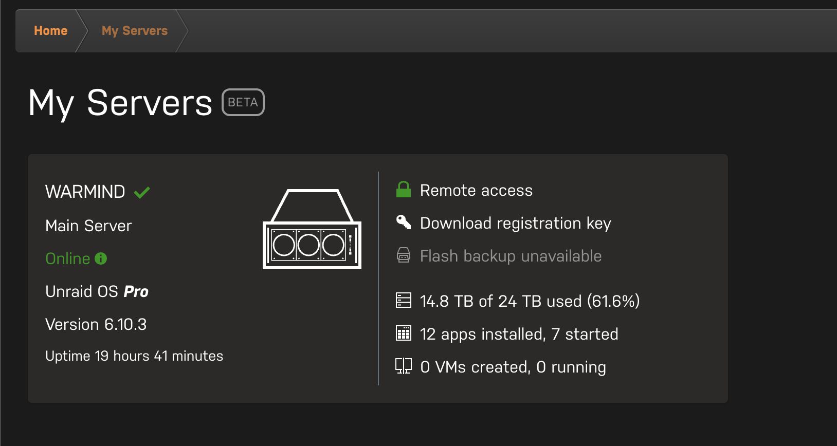

After many days of searching and testing now I reached a dead end regarding this
the server stuck at DNS Propagation is PENDING I can't access it remotely with https or via my-servers dashboard
wired thing is the dashboard shows that remote access is green !!

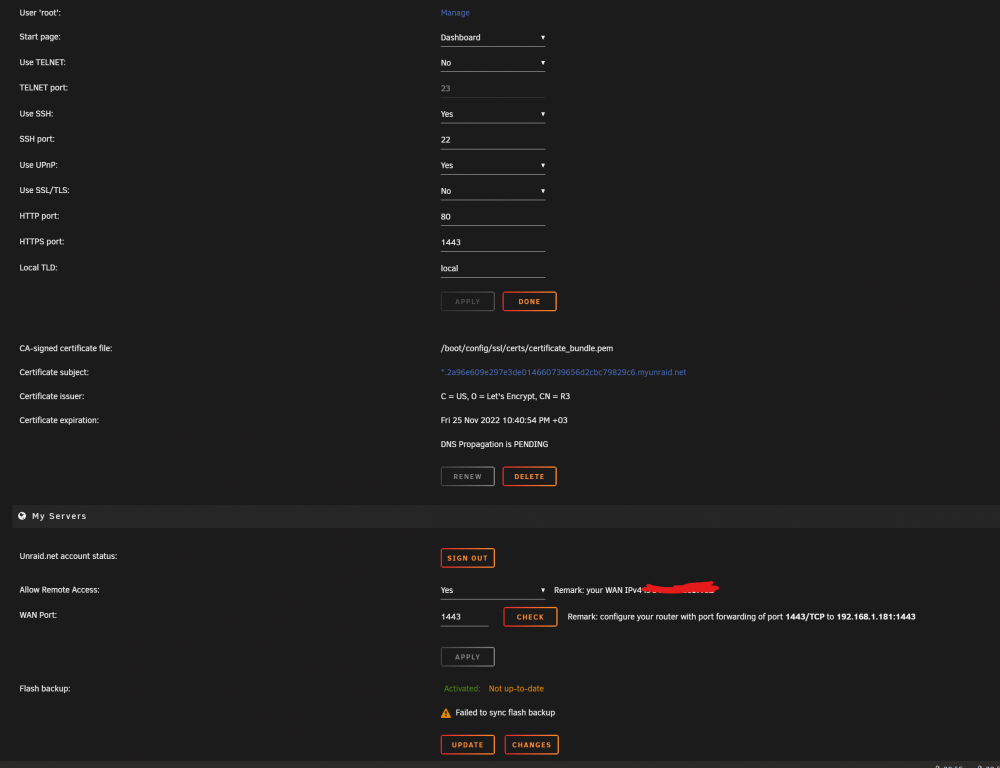

tried to remove the certificate by delete button and the rm command also reloaded the server and also tried to reload nginx with command
I can only access the server with http with port 80 also when I type just the public ip in the browser I get to the login page just fine

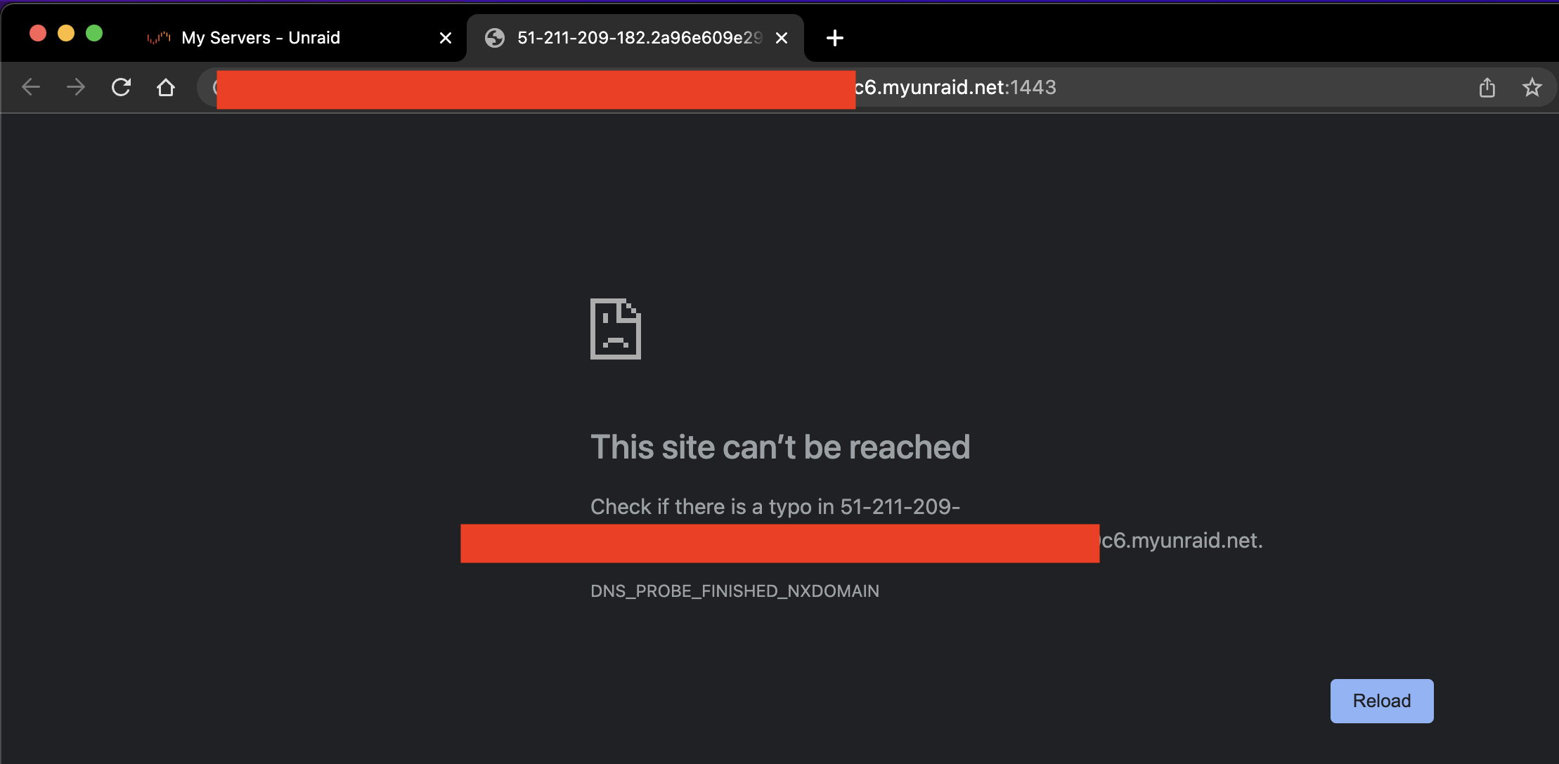

but via https is not possible
I also tried chrome & safari on the remote computer

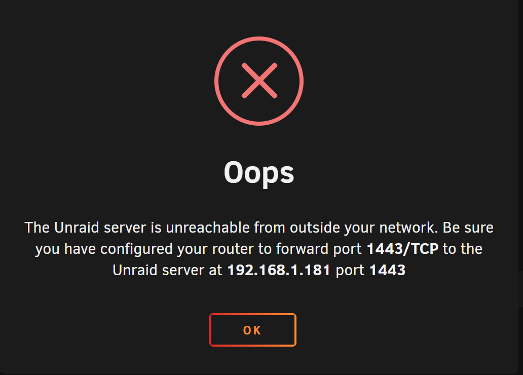

tried to change the https ip and both 443 & 1443 gave me the same results
those ports are open in the router and tested it that via canyouseeme.org

Use SSL is no
  Rebind protection is disabled for myunraid.net
Local Access url: http://WARMIND.local
⚠️  192-168-1-181.hash.myunraid.net does not resolve to an IP address, it should resolve to 192.168.1.181
Remote Access url: https://[redacted].hash.myunraid.net:[redacted]
⚠️  [redacted].hash.myunraid.net does not resolve to an IP address

You are having DNS problems, so let's remove your router from the equation. I'm not sure what you meant by 0.0.0.0, but please go to Settings -> Network Settings and change your IPv4 DNS server to 8.8.8.8, wait a few minutes, and then provide updated diagnostics.
Oh, you are using jumbo frames. That causes no end of trouble, I highly recommend you go to Settings -> Network Settings and change the "Desired MTU" for each interface back to the default of 1500.
Please completely remove your router from the list of DNS servers:
DNS_SERVER1="192.168.1.1"
DNS_SERVER2="8.8.8.8"
DNS_SERVER3="8.8.4.4"
OK for a sanity check, let's confirm the DDNS was setup properly. Please run this:
php /usr/local/emhttp/plugins/dynamix/include/UpdateDNS.php -vv
and send it to me in a DM. This is not anonymized so don't post it here.
Sent
To catch everyone else up... we had a DDNS issue on our end which is now resolved, and remote access is now working as expected, woot!
