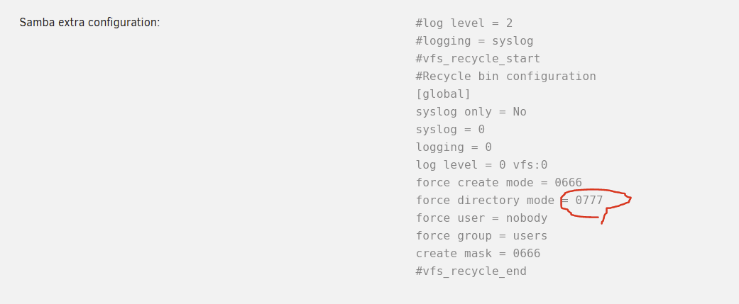

More details, another computer accessing same share exactly the same issue. So the issue is on unraid not on the windows clients as more machines behaves the exact same way, what is your take? SMB bugged out completely?
More info, seems to only be related to when creating folders, but i have the smb global settings to force folder creation via smb to 777, and this has worked before, nothing has changed on my unraid as far as i know. Or perhaps i never verified that folders worked but i feel like my sync that runs every 7 days should have been giving me issues previously too...
More confusion, i have another share where the same permissions are setup exactly as my /backup/ share shown above on the same unraid install, this share i can create, delete folders as normal everything operates normally, what makes this backup share so unique? Clearly a bug somewhere
Restarting the array did not help, the backup shares, whenever a folder is created it does not respect the smb rules for whatever reason, all other shares that are identical except the name of the share all function fine, it is just the backup share particular.
I have tried to remove the permissions and re-do them on the backup share without avail, what the hell is this mess? Any ideas anyone?
Found the issue, a sync script was setting "+" on the backup share, causing issues with new folder permissions. Solved.
