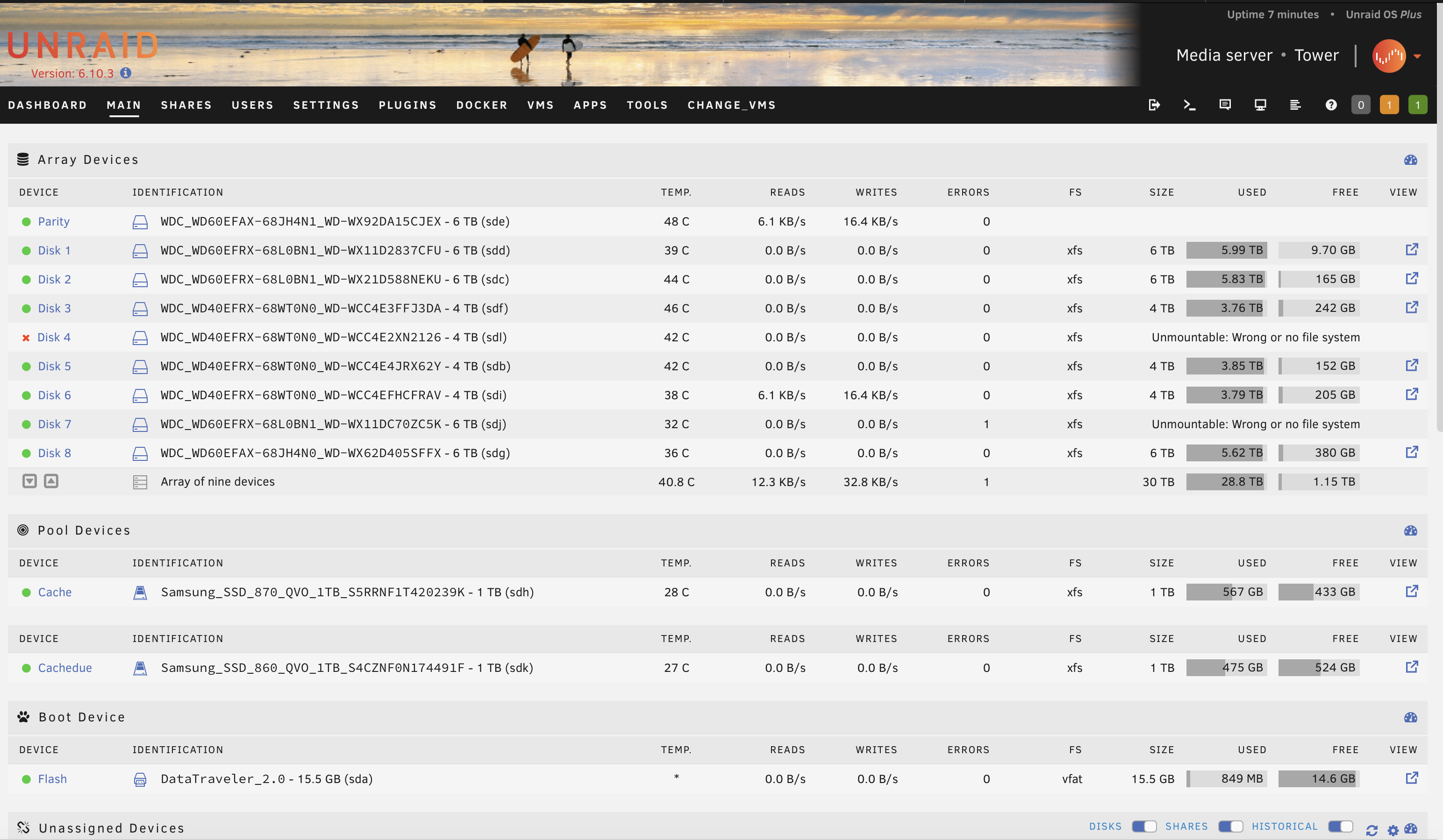

Hello guys!
This morning I woke up and found my Unraid as well as the screenshot I am attaching.
I also place here the zip file of the diagnoses, I cannot understand what is okay ..
Please if someone suggests me what I can do ...?
Thanks !!
regards! :)

  • Please attach your diagnostics.
  • Yes, array must be stopped, also use a different log file name or ddrescue will resume.
  • I have recently returned home, I preferred to be near the server for the reboot and its build. I just did this and it looks all right again! Now I will have to wait around 20-22 hours for the rebuild

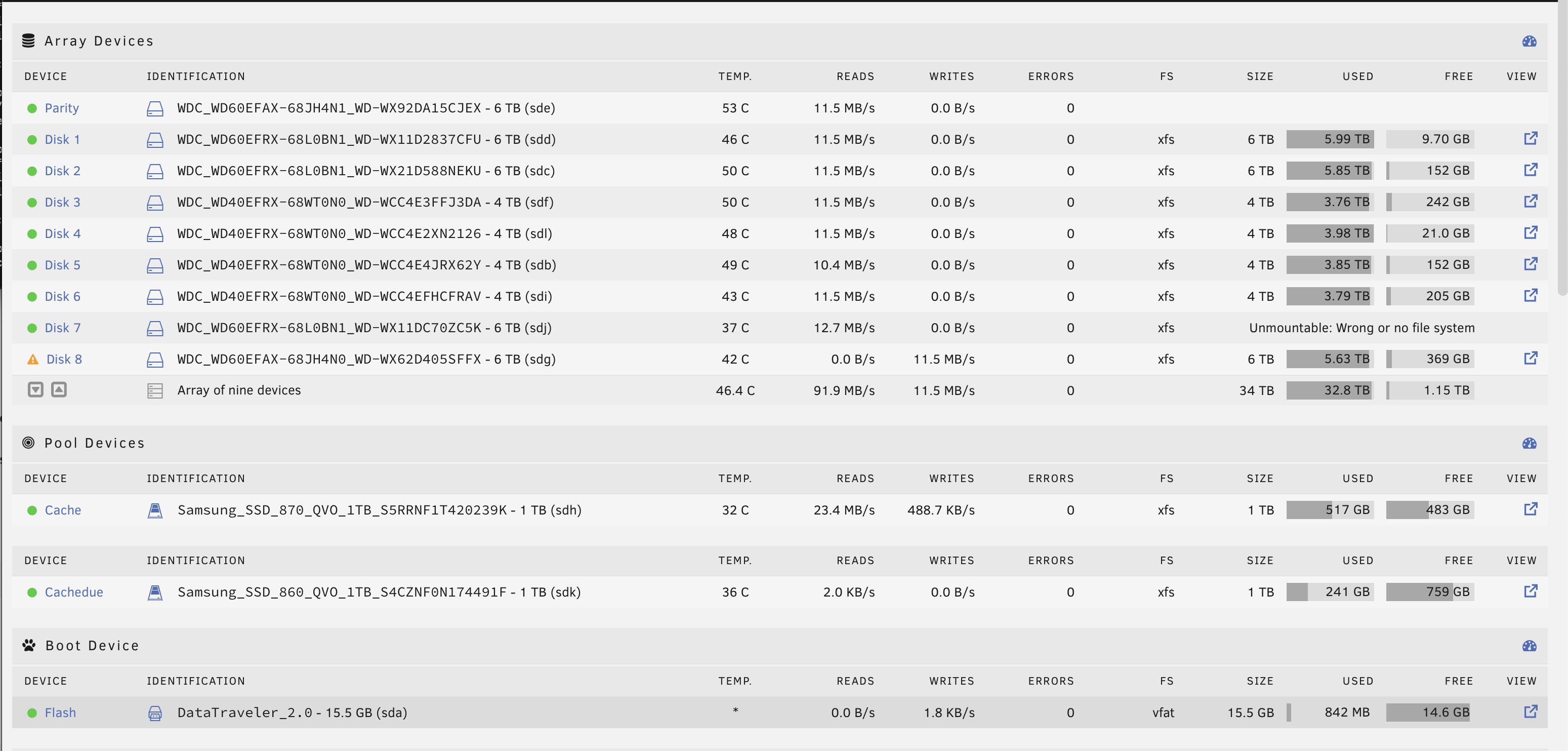

There is a lot more to the story than that! What did you do with your server before you went to sleep?
You seem to be rebuilding disk8, but it looks like there are connection problems on disk7.
Explain in detail exactly how you got to this point.
To me it looks more like disk7 is failing, run an extended SMART test to confirm.

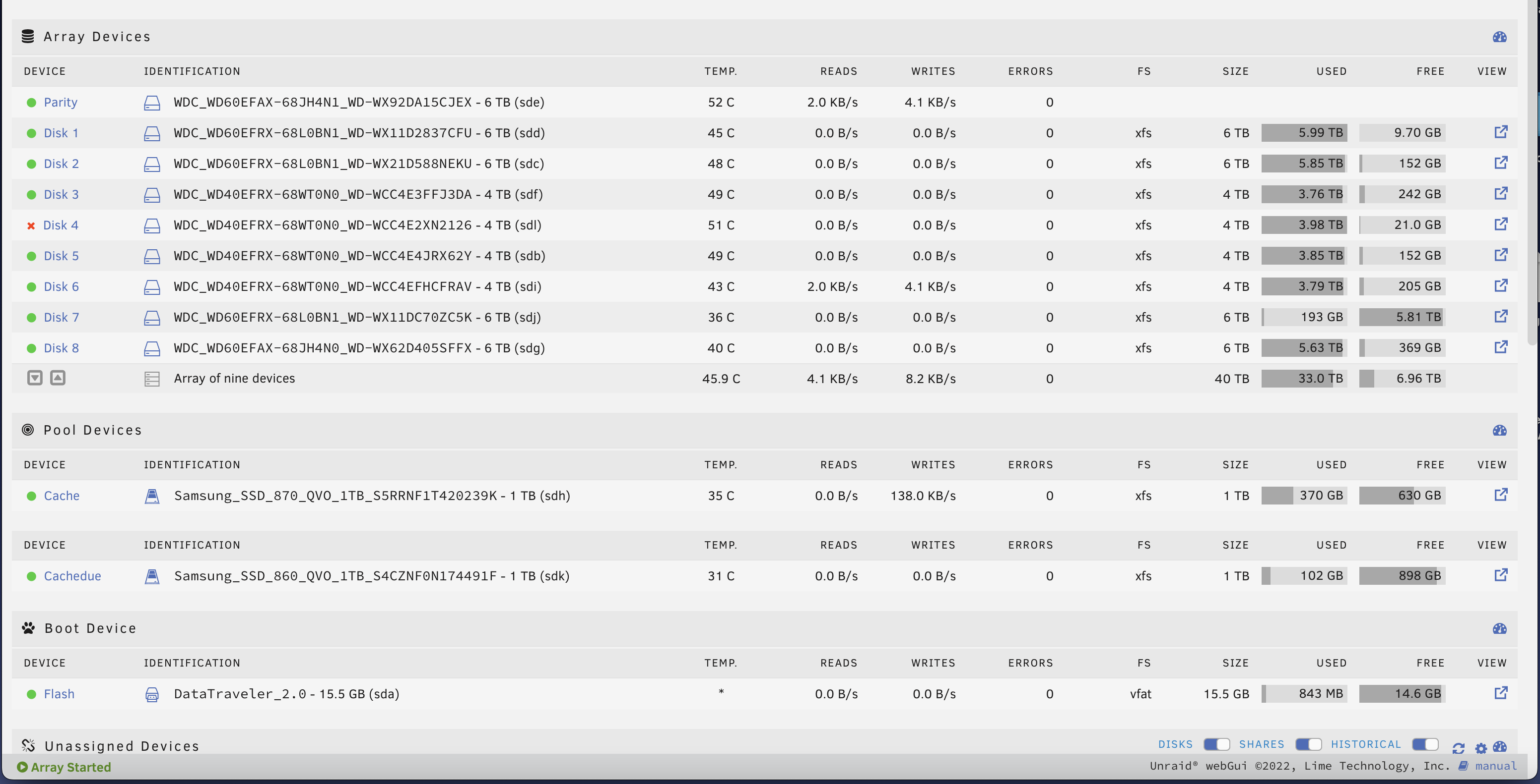

But this morning I lost disk 4. At this point I would like to understand what is wrong with my UnRaid, before I lose any more data. Do you think it could be a problem in the Sata PCI controller? or the unraid USB Stick? If necessary I could create a new Unraid, I believe that to do this it is only important to put the disks back
I attach the diagnostic zip file and attach today's screenshot ...

Emulated disk4 is mounted and is almost full. Disk1 is also almost full. I recommend not letting your disks get that full. Full disks don't perform as well, and you need to have some free space in case filesystem repair (check filesystem) is necessary.
Looks like you are having connection problems with cache. Check connections, both ends, SATA and power, including splitters.
Then post new diagnostics
You are using an Asmedia controller with a SATA port multiplier, those are not recommended, not surprisingly disk4 is connected there, suggest you replace that with a recommended model before attempting any more rebuilds.

Hi guys .. I'm in trouble with unraid again. I state that I have not yet replaced the controller because I have no more time. But after a reboot I found myself like this .. What can I do?
Docker doesn't work for me either ...
Disk7 is failing and since there already another disable disk you are in a bad spot, you can try cloning disk7 to a same size disk with ddrescue than use the clone to rebuild disk4, but there will likely be some data loss, how much depends on the amount of data ddrescue can recover.
