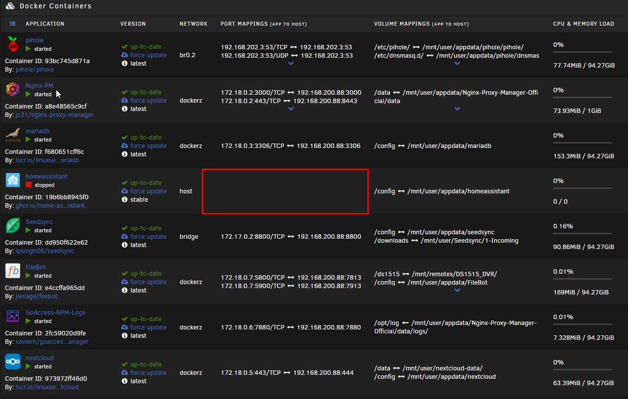

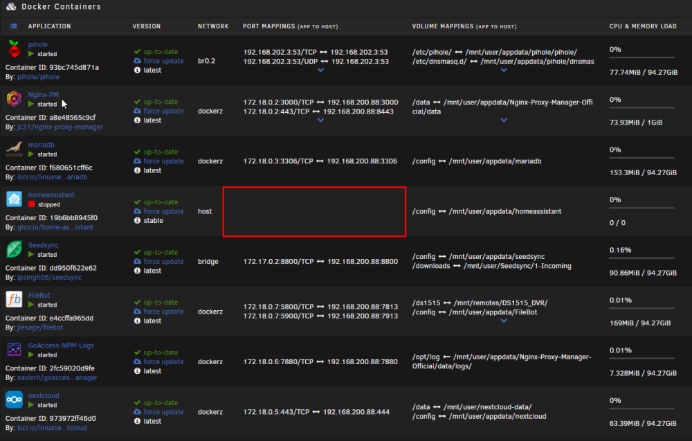

September 6, 20224 yr Author On a side note, and maybe this might help diagnose the cause. I have Homeassistant installed and under the port mapping, it's always been blank. I have tried to run HA on different network configs but it will only respond when set to use 'host'. All the other settings and I get an odd blank URL. The only way I've been able to access the UI is by opening the WebUI from the container menu. PS. I stopped the HA container via SSH when the UI problem kicked up. That's why it's stopped.
