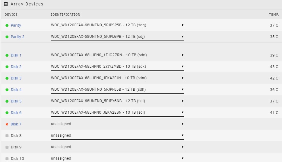

I don't think I have a disk8. Here is a screenshot of the array. Currently my disk 7 is the disabled one. Previously disk 6 (JEKA2ESN) also became disabled and need a rebuild. This is the second time for disk 7
All the disks are connected to power supply with sata power connectors. I'm running a Corsair 750i
Sorry, I meant disk7. It seems to be on the motherboard controller.
