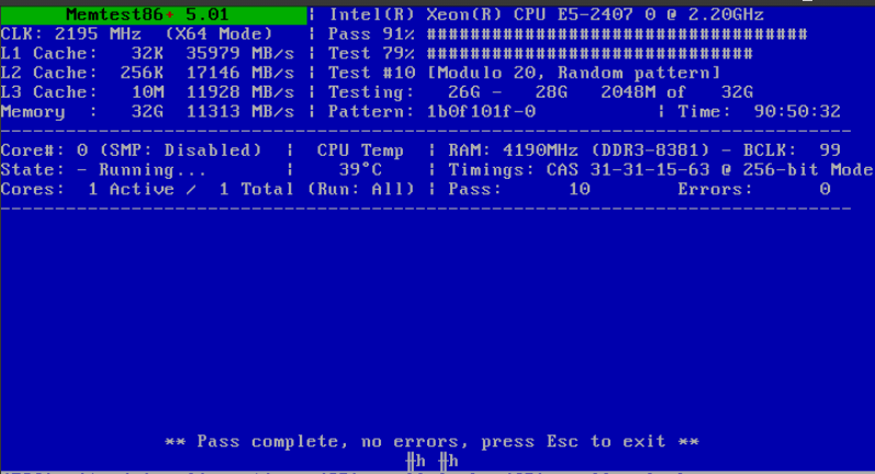

Bad RAM? Try memtest86
Memtest has been running for almost 91 hours now.. No errors.. 10 passes completed.. image.png.c4ff250dc3a08a72603ee873e8898ab6.png
