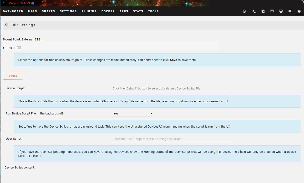

I do something similar here.  I have several desktop/laptop perform daily backup to my Unraid server.  Attached to the server are a couple of external USB drives, via Unassigned Devices.  Once a week, I backup the backup files from the server to the external drives, using this simple User Script which uses rsync to mirror the folders on the server to the USB drive:
#!/bin/bash
rsync -avh -p --delete-before "/mnt/disks/Samsung_Flash_Drive_FIT/UNRAID_Backups" "/mnt/user/Backup/Ryzen Home desktop" "/mnt/user/Backup/appdata backup" "/mnt/disks/External_3TB_1"
Every (other?) month, I swap the external drives with those I keep locked in my desk at work, just in case the most terrible of disasters hit.
You can specify a User Script in the device's drive settings to run when the drive is mounted.  I haven't done so, but may come in handy for you, just to keep track of which drive backups up what files.
