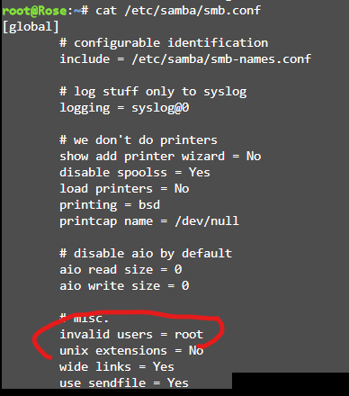

I suspect one possible way would be to edit the smb.conf, comment out the invalid user line and restart Samba.  (You would have to do this each time Unraid is restarted...)   Remember that root user is denied  access by default because it is a security risk.  (All security protocols for any OS firmly state that no login with root privileges should ever be used for routine-- day-to-day --usage of a system!  If such a user exists, it provides a quick entry to point for malware and other malfeasance activity.)
What is the reason that you require root to have access via SMB?  Reuse of a password?  Use a different user name with that password.  (Still a security issue but at least not one with root privileges...)
